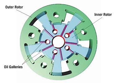

Could be the variators (hydraulically operated cam phasing) draining when stood a long time.

Cam phasers empty of oil on cold start.

IMO its associated with the solenoid controlled and oil pressure operated cam phasers moving to correct setting or maybe even a calibration sequence.
1.0 and 1.2tsi don't have cam phasers afaik.
