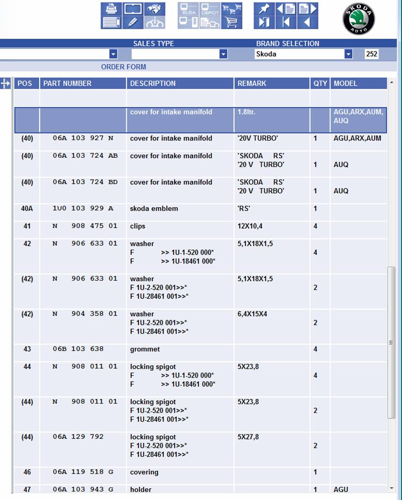

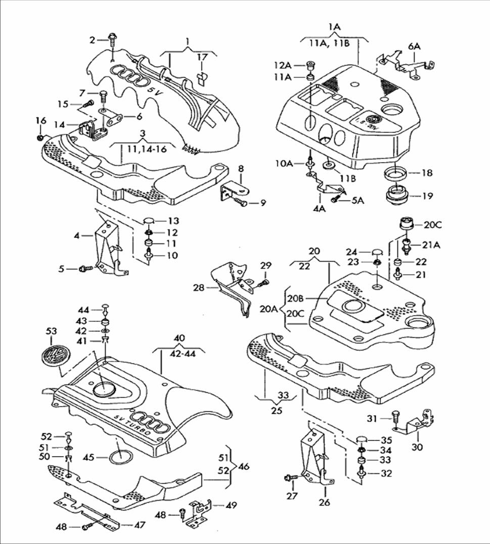

Can anyone tell me which code screws are for holding the plastic 20v cover on the engine are please
I've slowly lost or broken them and only have 2 now
Bottom left picture, screws comprise Items 41 to 44 inclusive.
Pic2.thumb.jpg.1949bce780a6d93620192bdb3df5c7c5.jpgpic1.thumb.jpg.0dfc4953fabf06ec676cd98a867eaae9.jpg
thanks silver bullet i went round a couple of breakers but no luck so i just rang motorline at wigmore and ordered 6 for £1,50 each last week  bit annoying as they said they would hold them for me but when i turned up today they said they had sent them back as i was a week late??? i told him that the guy on the phone said he would hold them but he agreed to post them for a little extra when they came back in so no problem
