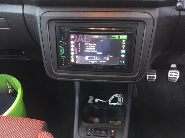

I had the same dilemma. I didnt want install another aftermarket head unit as i would have lost the rear parking display. But i found the OEM head units too expensive for what you get. So i installed my old Pioneer AVH-X3600DAB head unit that gave me DVD, DAB, Bluetooth as standard with the option to install later Rear Camera + Sat nav.
As i had the old pioneer unit in a mk5 golf i didnt have to buy anything new apart from the new screen mounted DAB aerial.  (Surround fascia and connectors were the same for mk5 to Skoda Fabia Monte)
Ive lost my rear parking sensor display but i still have the beeps, and it doesnt turn the stereo when you put in reverse also. and the screen is a lot smaller than the factory install but i get Bluetooth and DAB and i have the steering wheel remote on the wheel (Pioneer CD-SR110)

OEM headunit = Beeps and display distance on head unit, rear wiper does 1 sweep and radio turns down - All when you select reverse.
Aftermarket Head unit (Pioneer) = Beeps with 1 rear wiper sweep when your select reverse.
Beeps still work.
Thanks - that's good enough for me
