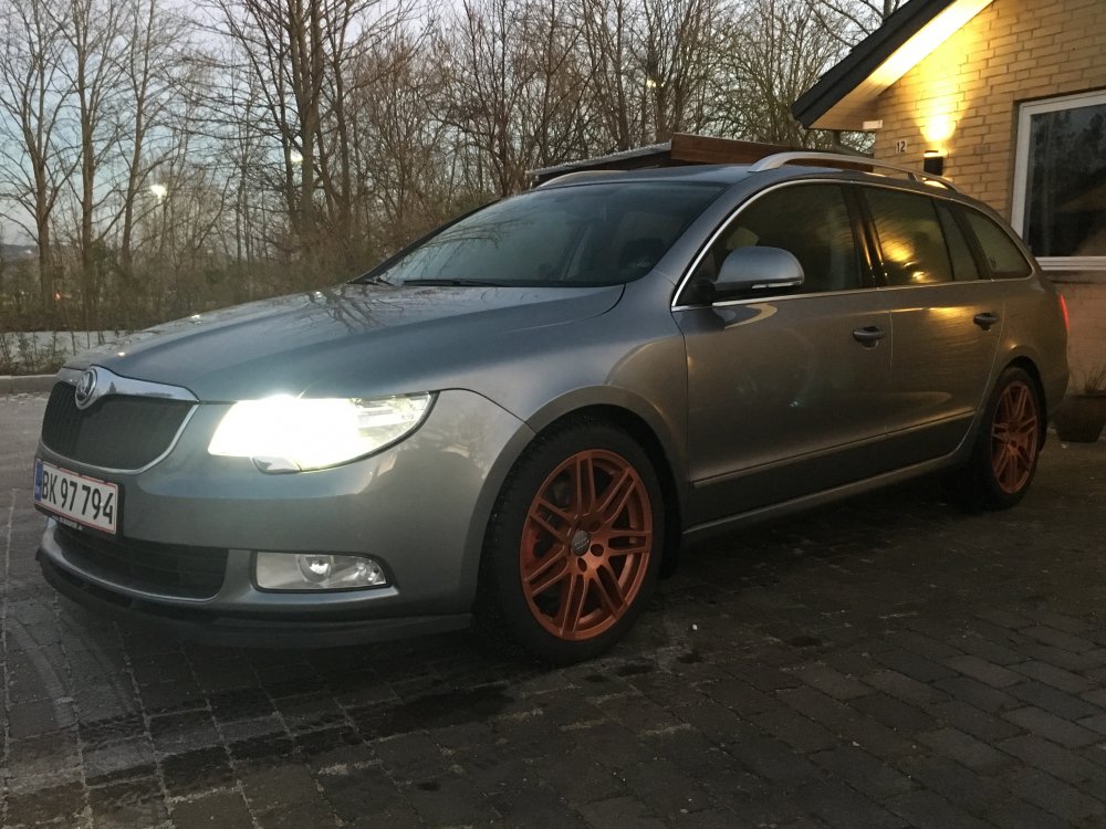

I just had my 12’ Superb dropped 30mm with the Eibach Pro Kit. Went in easily w no issues. Drives so much better now.

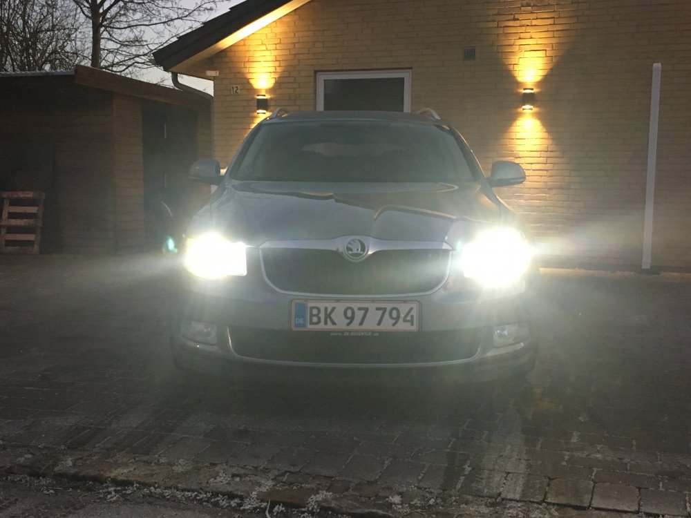

But it tonight I drove for the first time in darkness. I had people flashing their lights at me etc. I checked it out and it’s obvious the Xenon lamps are shooting way too high. I tried all the different settings (dip beams, high beams, auto, etc). The lamps still go through the usual startup cycle of out and in/up and down. Nothing reads out on the dash info screen.
