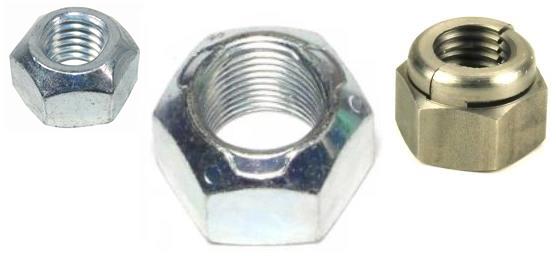

You need some nice locknuts. Not nylocks but one of the distorted thread types as shown. Might get away with lock washers but nuts would be better.
Preferably stainless or copper, yours have gone soft and stretched.
