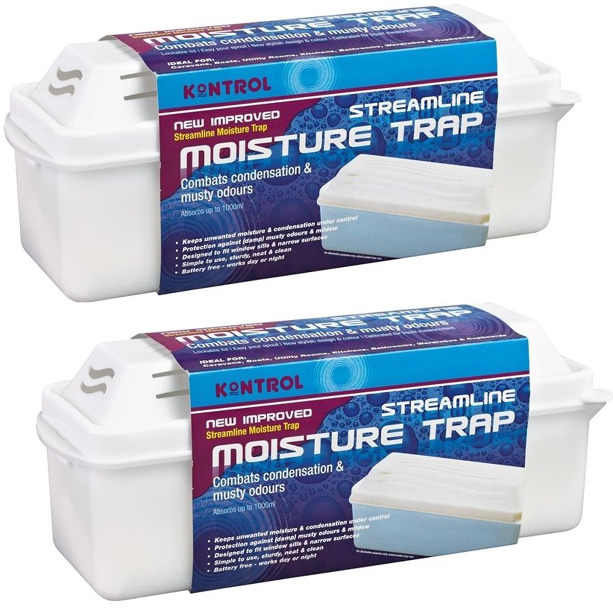

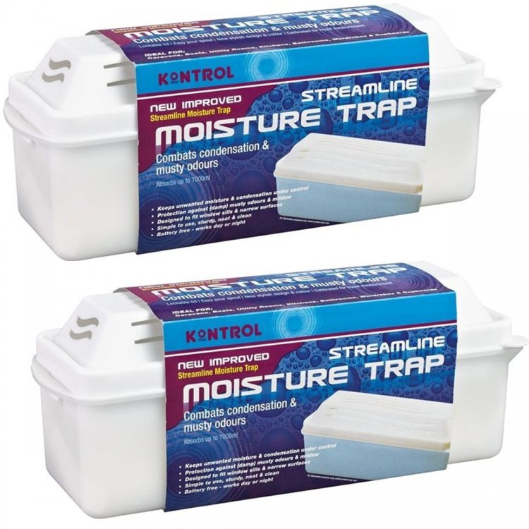

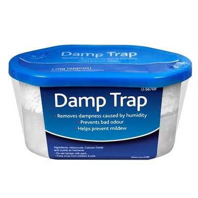

£1 in discount stores, Asda etc.
Or sea salt in a Marg Container tape the lid on and punch holes.

the moisture bags are very similar to the damp traps as shown above
