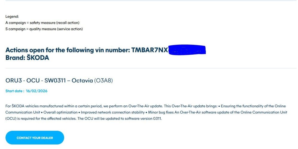

Hello everyone,
It seems that a rolling OTA update is on-going for SOS module which accordingly to the below information started a few days ago.
Has anybody received it?
Any kind of information will be highly appreciated.
You can easily look up by typing your vehicle VIN number on: https://www.dieteren.be/en/recall
Cheers.

  • I just got my notification about this ocu update today, but i will wait for a while and see if there are any problems with it.
I have just entered my VIN and I get the same response. Also for awhile now (possibly since before the 16th) I keep getting the 'update' prompt on the infotainment - and I keep telling it to update, and a few days later it comes back and prompts me again.
Does this require a dealer visit?
