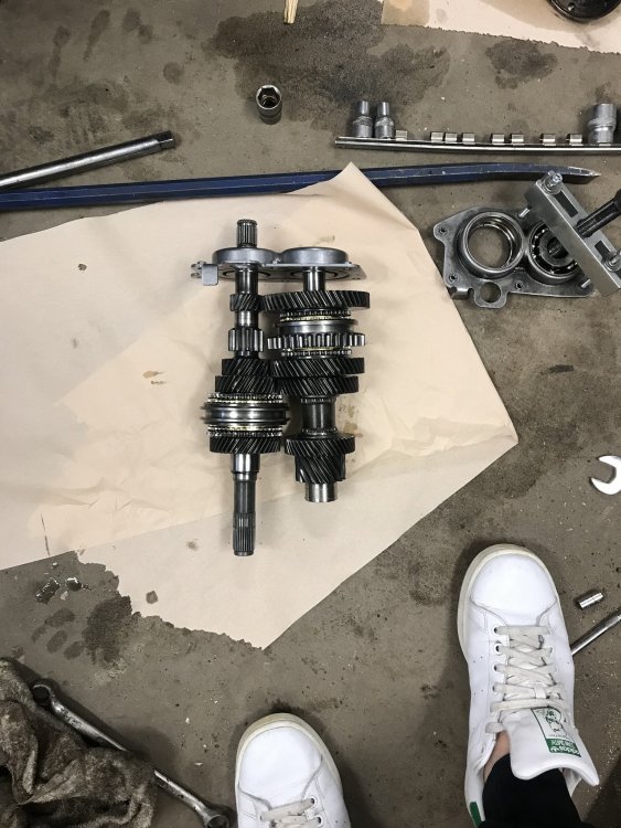

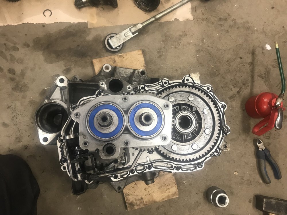

Hello. I have the same problem (3  years). Can you put here a picture with the shaft bearing that failed?
Edited by mobility
Submitted the wrong picture on first post
The bearings with the blue seal on picture 1 above was the one that failed.
On picture 2 you can see the bearings half way off the gearbox shafts during disassembling.
