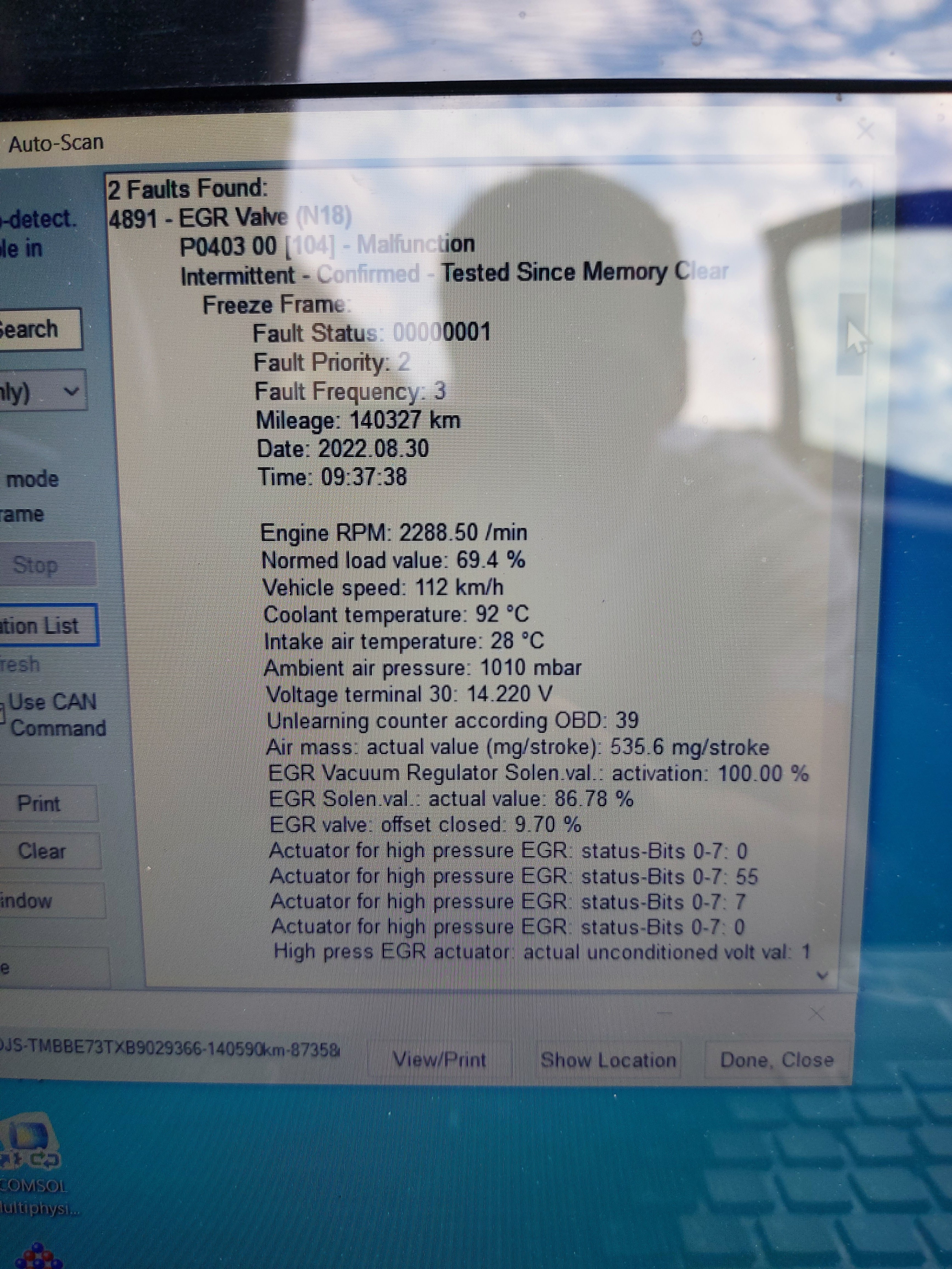

  2. This was my thought too, if the egr valve is coming off its getting replaced. It's just I want to be pretty sure first that it's actually the egr and not something else like a leaking vacuum line as it's a lot of time, effort and a fair bit of money to replace.
  3. Hi everyone, I made a post a while back about egr valve issues with my car. It appeared the problem was a seized egr cooler flap, I freed it up and hoped the problem would not re occur but it has. Does anyone know a way to stop this happening or is the only proper fix new egr valve unit? The vcds readout seems to show a discrepancy between vacuum solenoid activation and actual value which also makes me think that is the issue. Other than this there is no other recurring codes. One final thing to note is that when I apply the accelerator, very occasionally there is a hesition for about a second then the car accelerates normally. Could that be symptom of the valve itself (not just the flap in the cooler) sticking too? By the way my car has the 2.0 tdi cffb engine and is a with 95k miles.

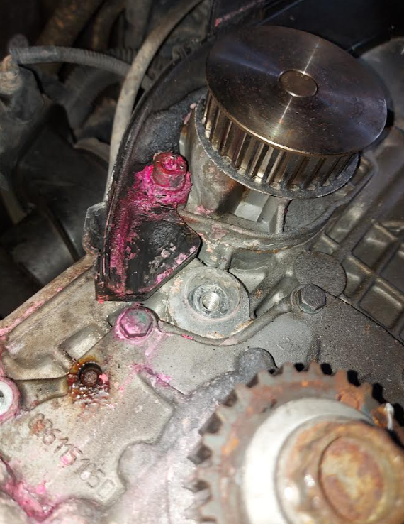

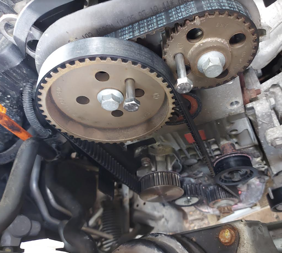

  8. May be worth checking when the cambelt and water pump was last changed though, its often overlooked. Just for reference the water pump on my brother's 57 reg fabia was completely worn out after 7 years and 45k ish miles. Regarding engine noises I do think these engines are quite unrefined, they make all sorts of strange ticking noises, especially when under load, well at least that's been my experience of the bxw engine, reliable but rough.
