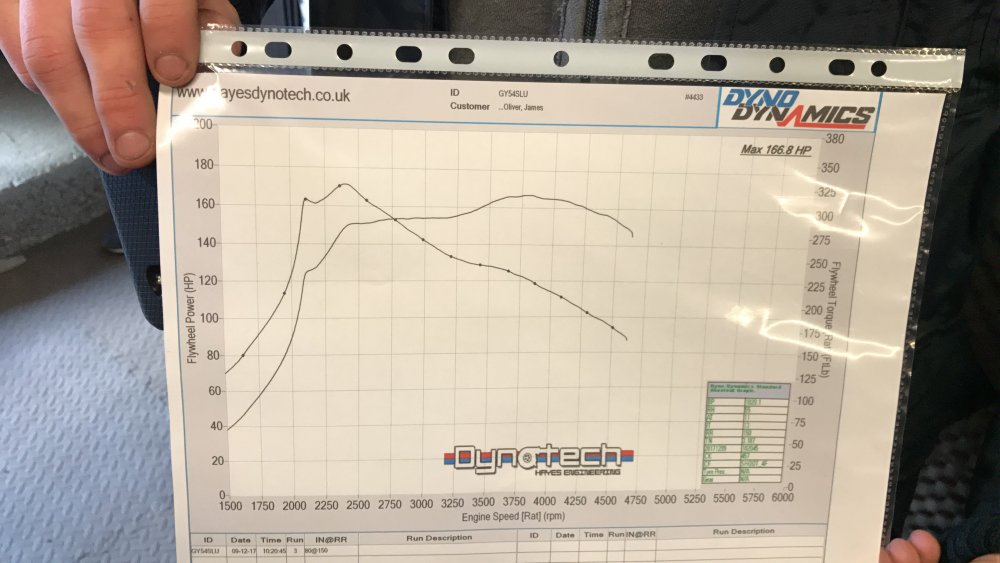

I’ve had my fabia since June, I got it flash remapped shortly after by a garage local to me (Boost Factory)
I had the car rolling roaded in December as had no idea of the figures. The car made 166.8bhp and 325ftlb. Looking at the graph it isn’t very smooth, I don’t understand graphs all too well however looks like a big torque spike as boost comes in. My clutch does seem fine, I try not to toe it under 2k rpm however occasionally and I mean very occasionally it will slip in 4th then won’t do it again for months which I feel is more of a brief contamination issue opposed to general clutch slip.
personally I think the map looks dreadful due to the graph compared to other graphs I’ve seen. What do you guys think?
It looks fine, you're new to diesel then because they're all about the torque, not the revs.
I’ve never owned a diesel mate ever. This is my first ever diesel! So that huge spike drop then rise and drop again is normal?? Can you tell if there’s a boost leak from the graph? Never owned a turbo car and never owned diesel
If you don't have a hiss or whistle like escaping steam and you have no clouds of black smoke from the exhaust then you don't have a boost leak. The graph and figures look bang on for a remapped standard car.
There is a little whoosh sort of sound as the car comes on boost and does soot some around 3.5k rpm, apart from that doesn’t soot. I am picking up a FMIC and Hardpipe kit next week so hopefully will sort any boost leaks
