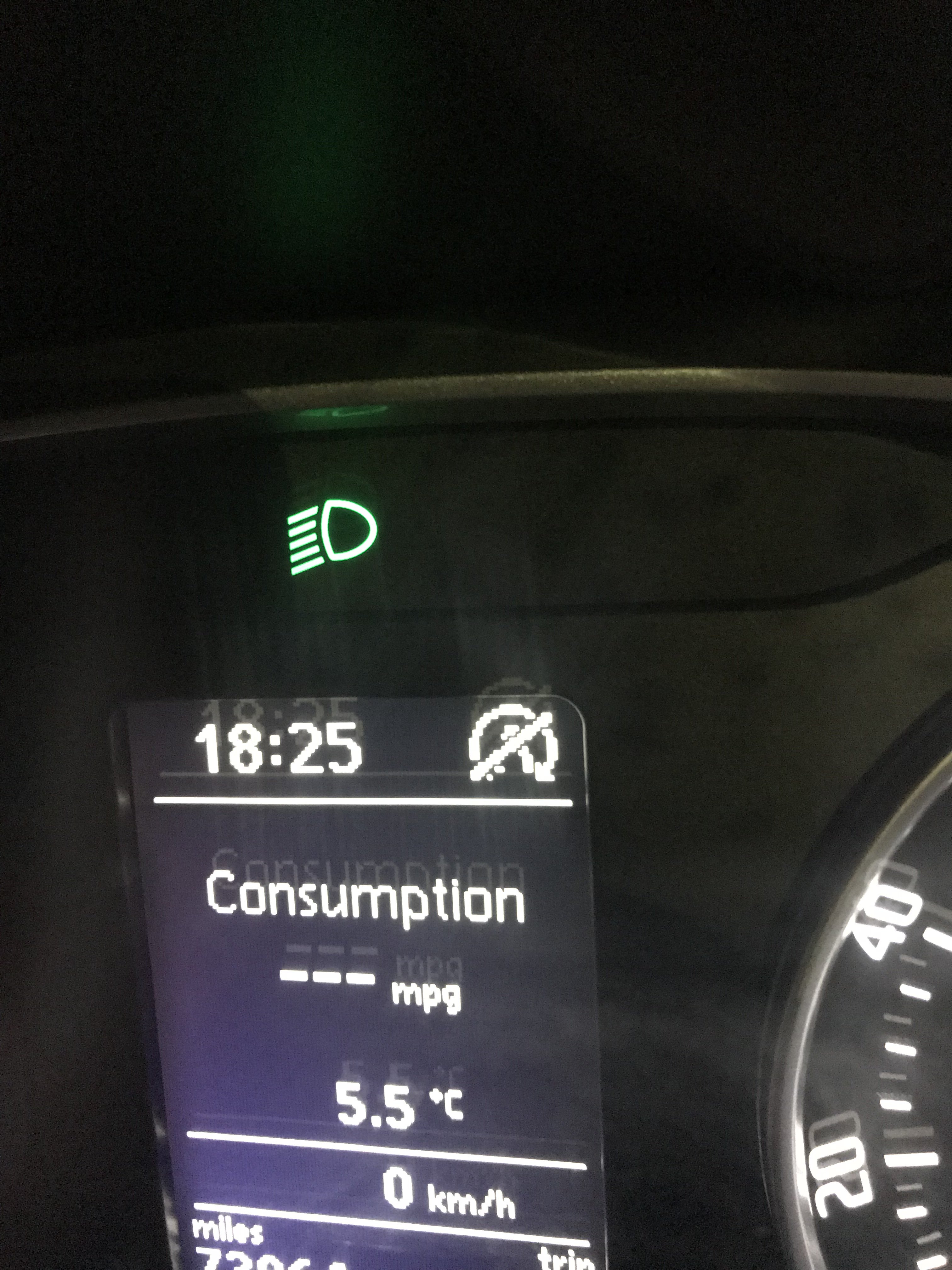

Hey guys Jordan here,new to the forum as I have just purchased a used Skoda Octavia GreenLine 1.6tdi
everything is great with the car but have one problem, it seems that the start stop has been completely turned off as it comes up with ge icon on the dash with a line through it when I stop at junctions.
is there a way to re activate it?

The line means that it does work however the criteria has not been met.
Anything that the ecu's feel may make it hard to restart the vehicle if it does stop, mean the vehicle stop start will not work.
Thank you very much for that reply, so this image(attached) states that the stop start system is still functioning,but won’t work becuase of the certain list of checks it does before it will shut the car off at junctions
