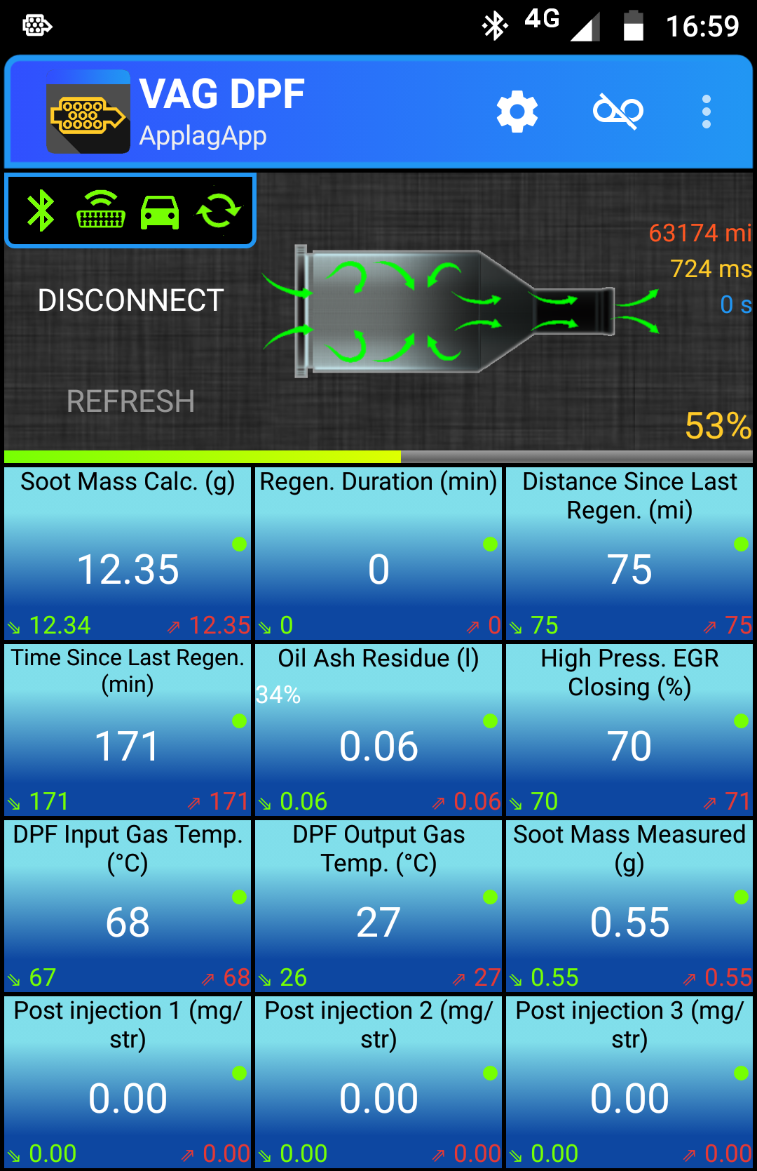

As per screenshot (below) my oil ash residue is 0.06. I'm assuming the 34% is representative of how full it is?
On this basis I'm hoping for >100k miles before the DPF is "full" and requires replacement.
Aha - my screen doesn't show a % figure, hence the question. Thanks.

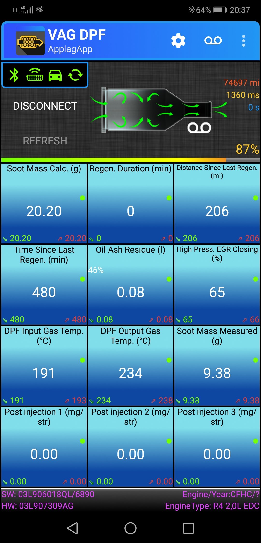

I'm now at 0.07 l (40%). Seems the app steps up in 6% increments.

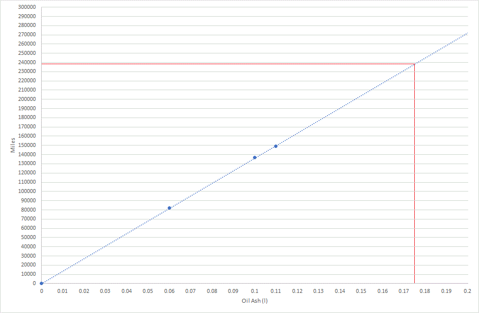

I had initially hoped to see a similar DPF longevity, but have plotted my (admittedly limited) number of data points and see my DPF is likely to be at 100% Oil Ash Residue at around 120k miles.
Whilst I'm certainly no statistician - I realise the above is based upon:
  • only a limited number of data points (3 thus far)
  • extrapolation
  • assumption the calculated Oil Ash Residue is an accurate representation of actual values
  • Oil Ash Residue continues to rise in a linear fashion
  • 100% = 0.18 l
it would appear I'll need a new DPF around October 2020.
All things being considered I guess 6 years / 120k miles is more than likely well beyond the predicted lifespan of a component such as a DPF (HonestJohn often quotes  ~80k miles as the time to expect issues with emissions related paraphernalia on a modern TDi).

If your graph is correct that puts me at 80%:sadsmile: 120k will be within 15 months for me. I am also planning long term have had big brakes done and remap. Oh well just have to deal with it when it happens....

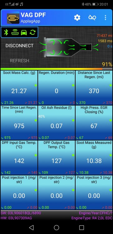

Currently on 71k miles and VAG DPF is still quoting oil ash residue at 0.07 (40%). I'm assuming a "jump" is due anytime soon.
I checked the car yesterday and saw it had covered 370 miles, since the last active regeneration. I'd previously tended to see 100-200 miles between active regenerations, (since the Shark remap) and wondered if the recent hot weather conditions had aided the passive regeneration process, thereby negating the need for active regeneration?
