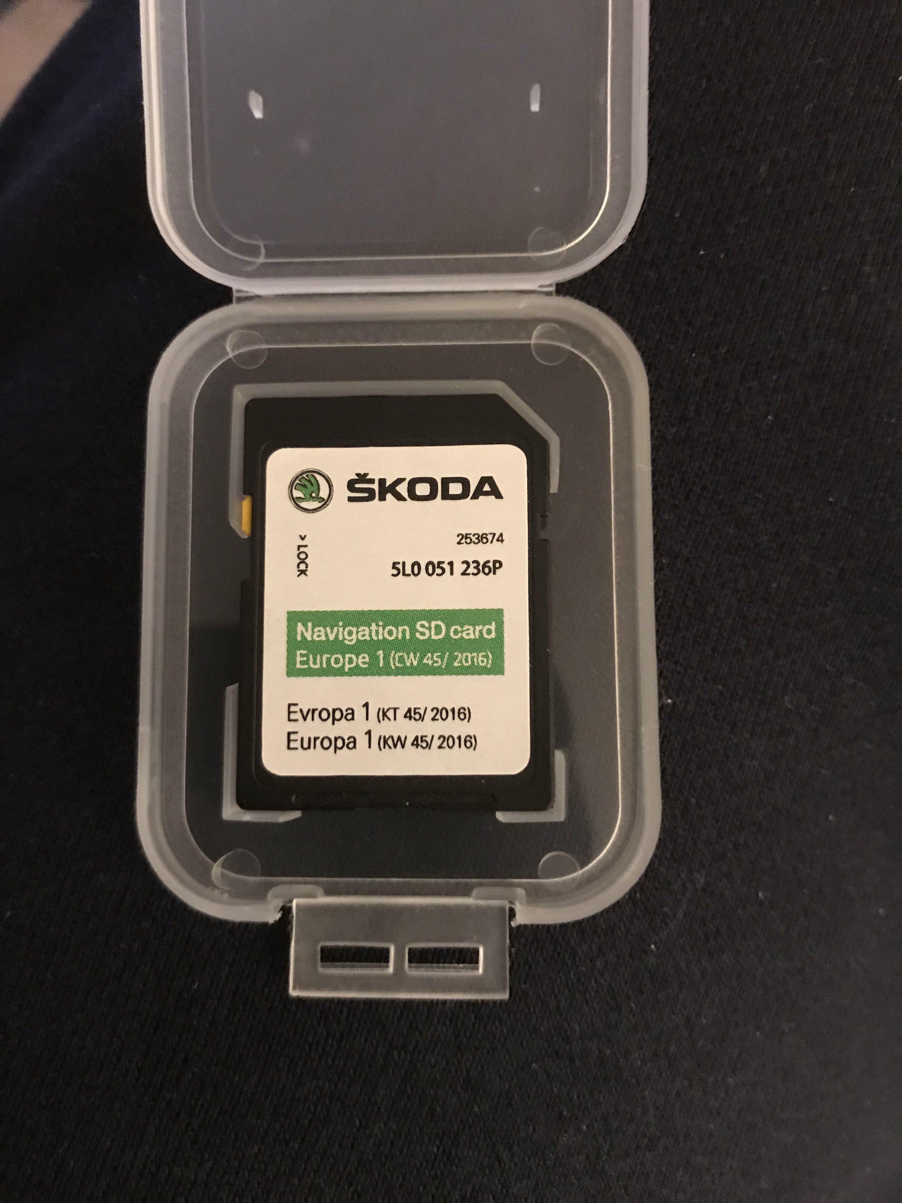

Hi thanks for coming back on this matter . I don’t have access to my AUS SD Card (its on its way over to the UK at the moment). The number on the Europe SD Card is as the attached photo. C762A924-DDFC-41DE-BB21-495314947972.thumb.jpeg.69dc2e264a8aaea2d2c8c2887995702e.jpeg
Hi Urrell, Pretty certain it is a genuine Card. Thanks.

Part number is correct for the unit, as long as your unit looks like this...
and not like this...
Hi, Thanks for the information. Yes my unit is the Top Picture above, so from what you are saying it should just work.
