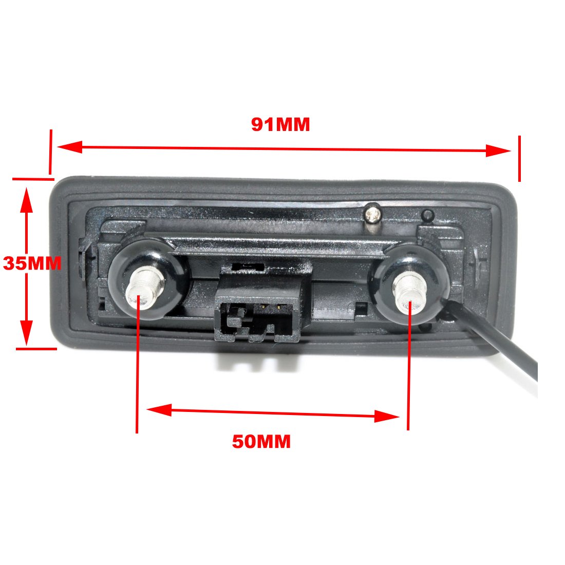

Ive notice there are alot of large cameras 50mm wide and 110mm long, the correct fit is only ID 78mm x 28mm, and OD 91mm x 35mm, anyone else notice this?

both of those are way too big to replace my trunk handle aperture... are there different size boot handles? mine is a 2014 vRS TDI
this is the one ive fitted but the viewing angle is crap https://www.amazon.co.uk/dp/B01MR0D4L7/ref=psdc_1342943031_t3_B073ZF7BQG
i really dont want to cut any metal. are there any low profile cameras that are this size?
Edited by JohnnyType2
All the previous how tos I've seen, require opening the apperture up to fit the new handles.
On the newer cars the hole is bigger already apparently.
I must admit this is what's slowing me down from fitting it already.
I'm waiting on better weather and time to do the cutting and fettling. Not like you can go back once you start

there is only one camera that fits without cutting unfortunately, its just ok, but im comparing it to my Kia 4 which has a very good highline style camera but what did i expect for £30

The camera I bought (described above) fitted fine with no cutting but mine is 2016. Angle is spot on.
