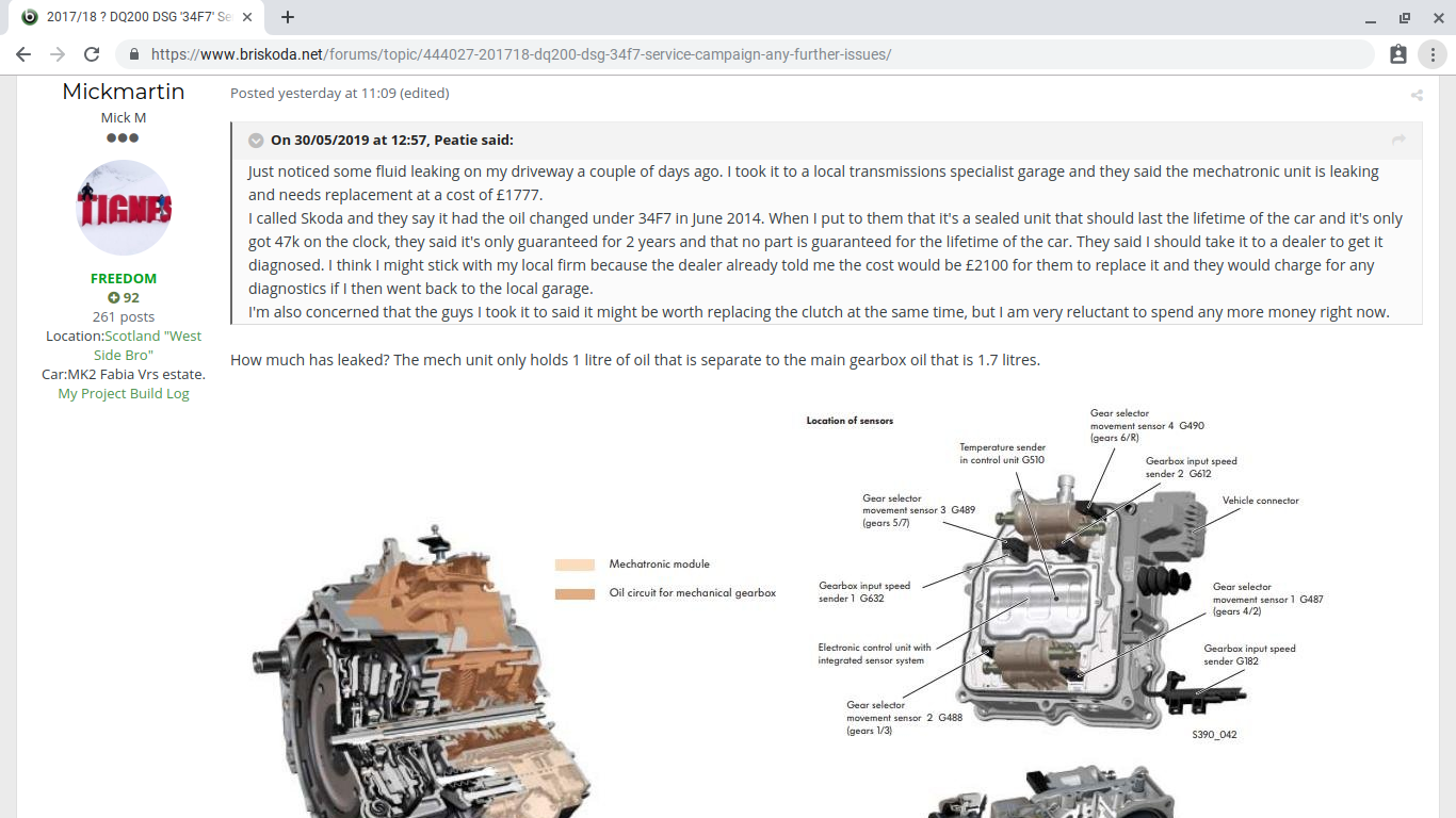

2 hours ago, Mickmartin said:
How much has leaked? The mech unit only holds 1 litre of oil that is separate to the main gearbox oil that is 1.7 litres.
1474754515_dq20020oil20circuits.PNG.b5c693598561a61ac660fe3041e63045.PNG340459383_mechatronic20sensors.PNG.3eef00fd5380f7beea979389c4c9b5d1.PNG
Ask your mechanic where its leaking, its pretty uncommon for these to leak, usually the hydraulic pump goes in the mech unit but no leaks. The mech unit is sealed by rubber and torqued in so get that seal checked out.
Truth is, If its affordable do the clutch while the box is out.
They said the gas filled accumulator at the top has a break in the aluminium casting. Quite a common fault according to them. They don't try and repair them as they are under pressure and could cause an injury.
@Peatie
When was your car built and when First Registered?
I see on the picture the 2nd and 4th gear sensor is that replaceable? I beleive they just replace the whole unit when they fail  (sorry for going off topic)
