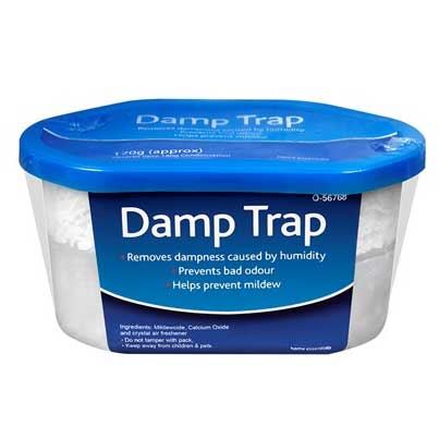

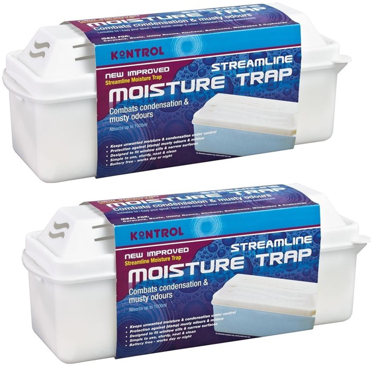

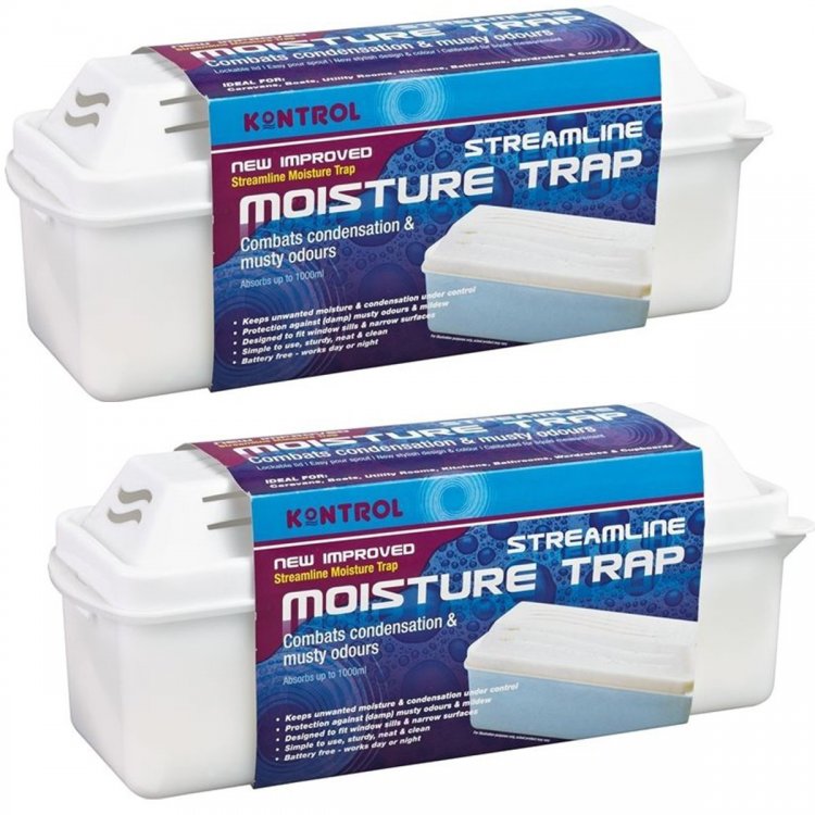

Put what ever moisture absorbing device you want in the cabin, and one in the boot.
Plenty to choose from, inexpensive, disposable or re-useables.
Thank you i look out for these. Getting to think i should have kept my old 16 year punto never had this before !!
