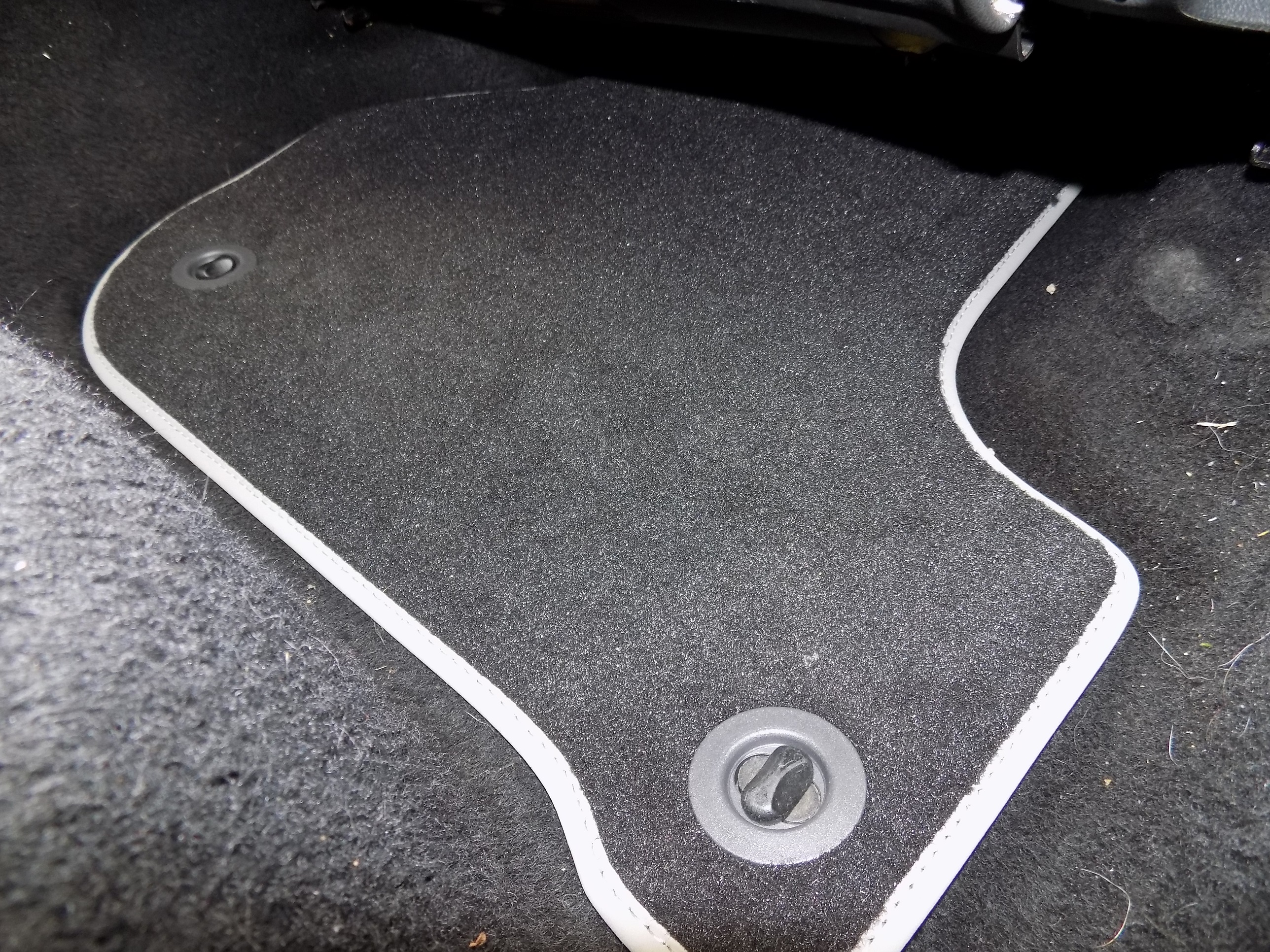

New floor mats picked up and installed.
Got them through the dealer and they have the vrs logo and a grey trim. Look real smart/clean. Hadn't noticed that the existing mats, although drivers one was missing, were not the originals. Just a black generic style. These are the ones with the hole for the fastener. £36 for the set. ps The drivers mat is an odd shape! :wondering:

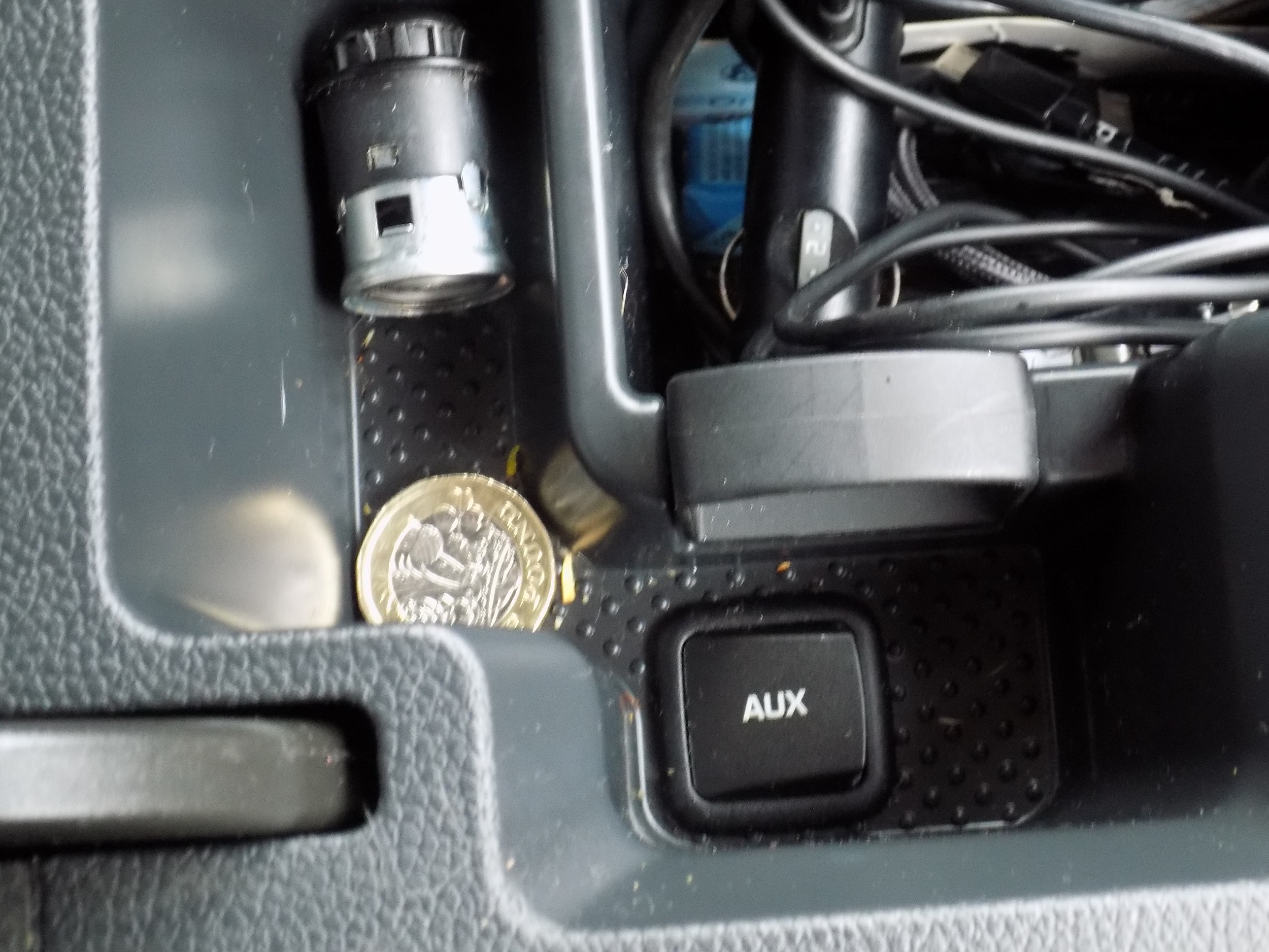

Found another problem too. The Aux in port in the jumbo box doesn't seem to work. Bought a new cable to make sure but nothing coming through. Have switched on the option in the menu and double click the cd button to select aux but no sound. Suppose I need to check if the socket is live or if a fuse has gone, although I imagine it shares a fuse with other things I would have noticed. I think I have a multi meter at the bottom of a toolbox somewhere.
Whilst in the Jumbo box I was intruiged as to what the handle was so pulled it up and it broke off a wee bit of plastic. I don't understand what this device is for? Now it doesn't stay up anymore although I don't understand what function that would serve if it did. Any insight?
pull the tab up and it opens a litttle hole at the bottom which allows air from the AC system to go in essentially making it a little cool box- there is also something similar in the glovebox
The handle thingy opens the vent to allow a/c air into the jumbo box
Edit: beaten to it :D
Edited by pist0nbr0ke
That is brilliant. I never knew I had a cool box. I like that B)
