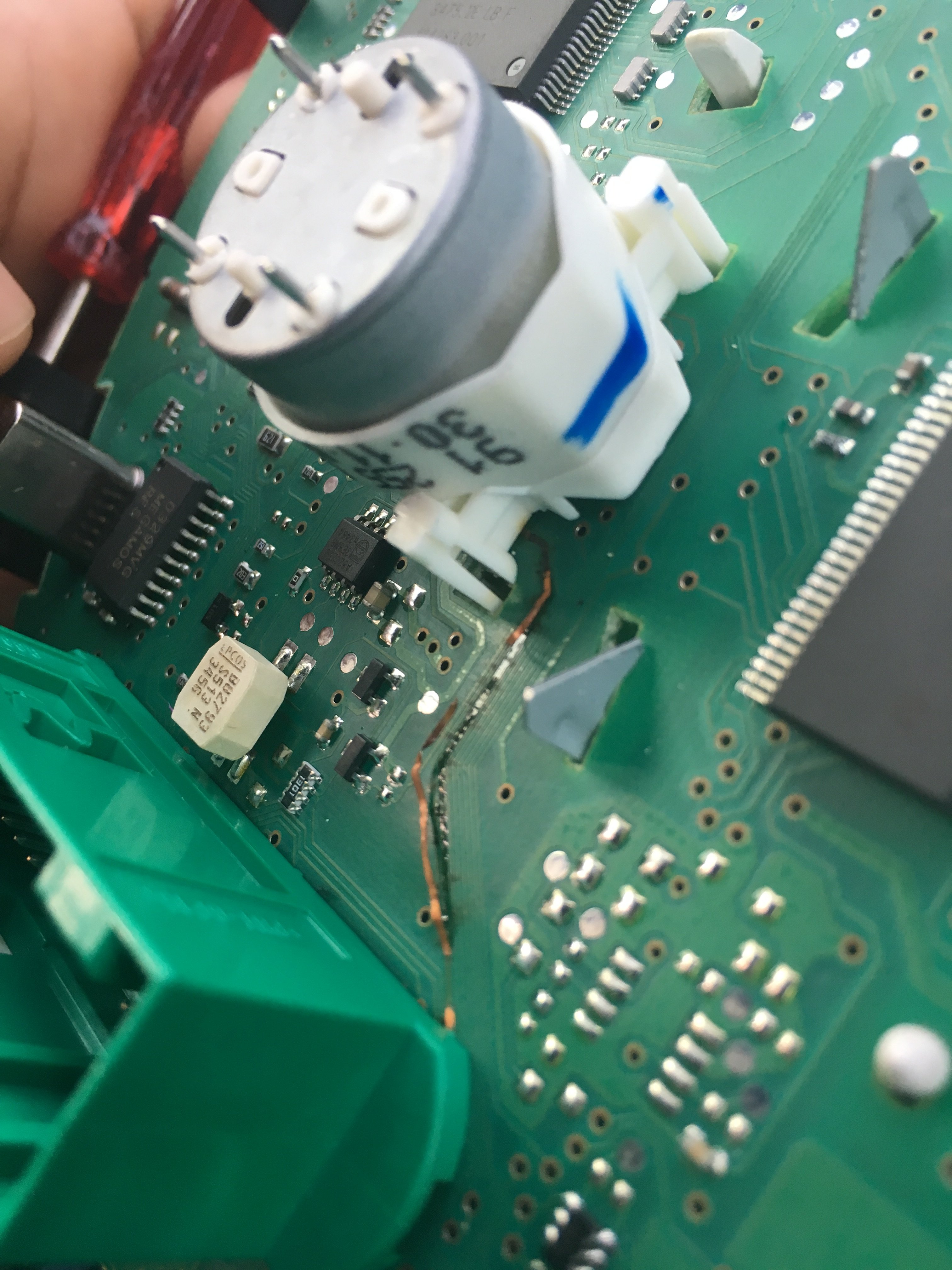

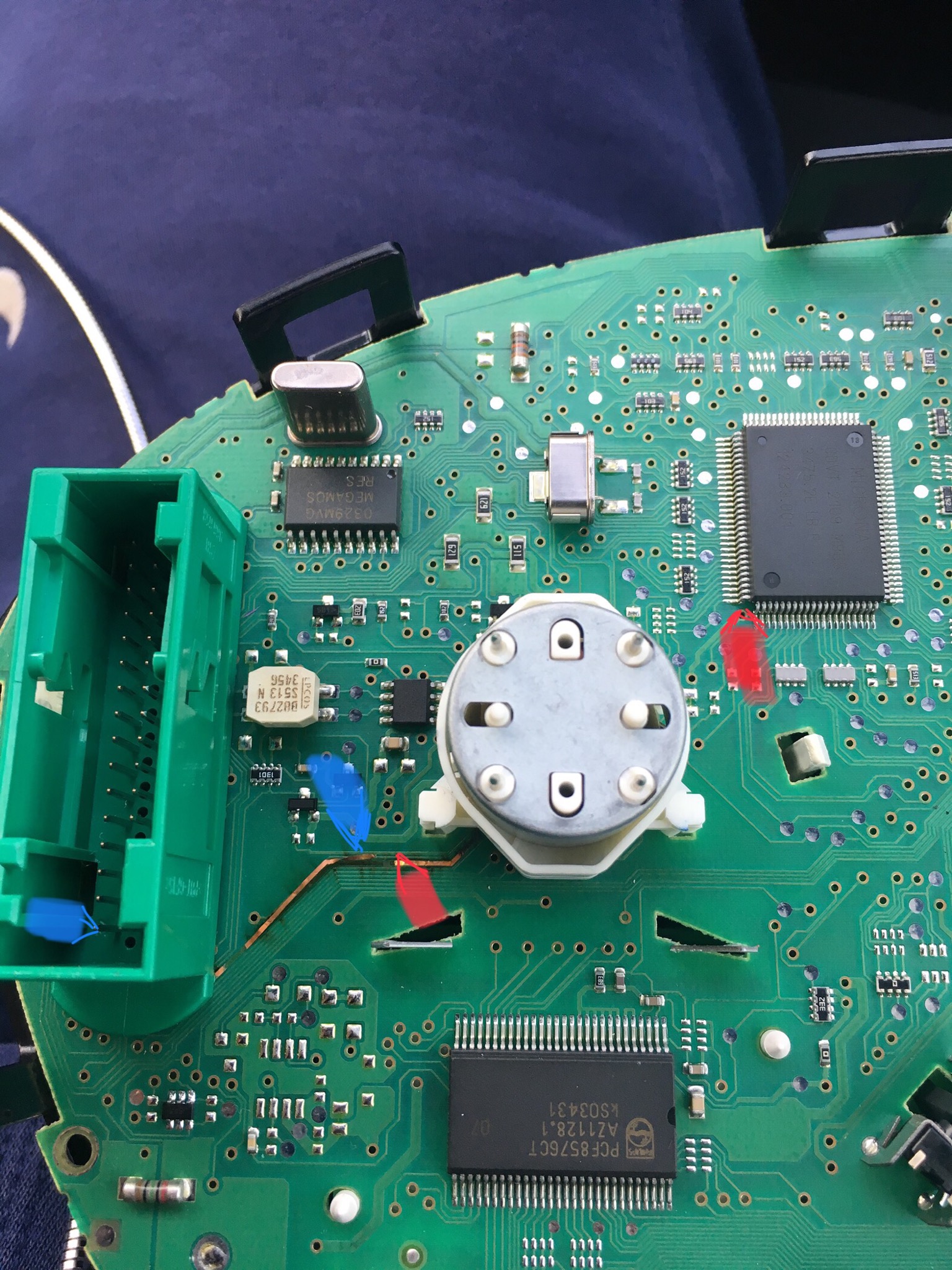

Sounds like you've proved that the track is OK between the break and the connector, but not sure whether you've proved that the track the other side of the break is OK.
What you want to do (using my picture with a 'pretend' track break in the red circle indicated by //) is put the probe that was on the connector pin 32 onto the side of the track break where I've put the black arrow, leaving the other probe in the same place next to the corner of the chip (where my red probe is in the picture).
 Okay so ive measured from red point to other red point and i got 00.3ohms
and I measured from blue point to other blue point and i got 00.3omhs , i also carried out a  continuity test from both points and the mutimeter beeped, so does this mean the track is only broken from where u have put the red ring ?

  • I wonder what's caused that track to burn out.   Intrigued by the wire skullduggery at the plug as well. Wonder if it's related.
  • Not the best photo, but try pin 32 of the connector, top right in this view, to the corner of the big chip where the red probe is, (there's a hole through the board to poke it into). Meter set on lowe
  • Yes the reading is correct because the track is broken.  The meter will show continuity when you find a bit of track that is still connected to the pin (if there is a surviving bit there).

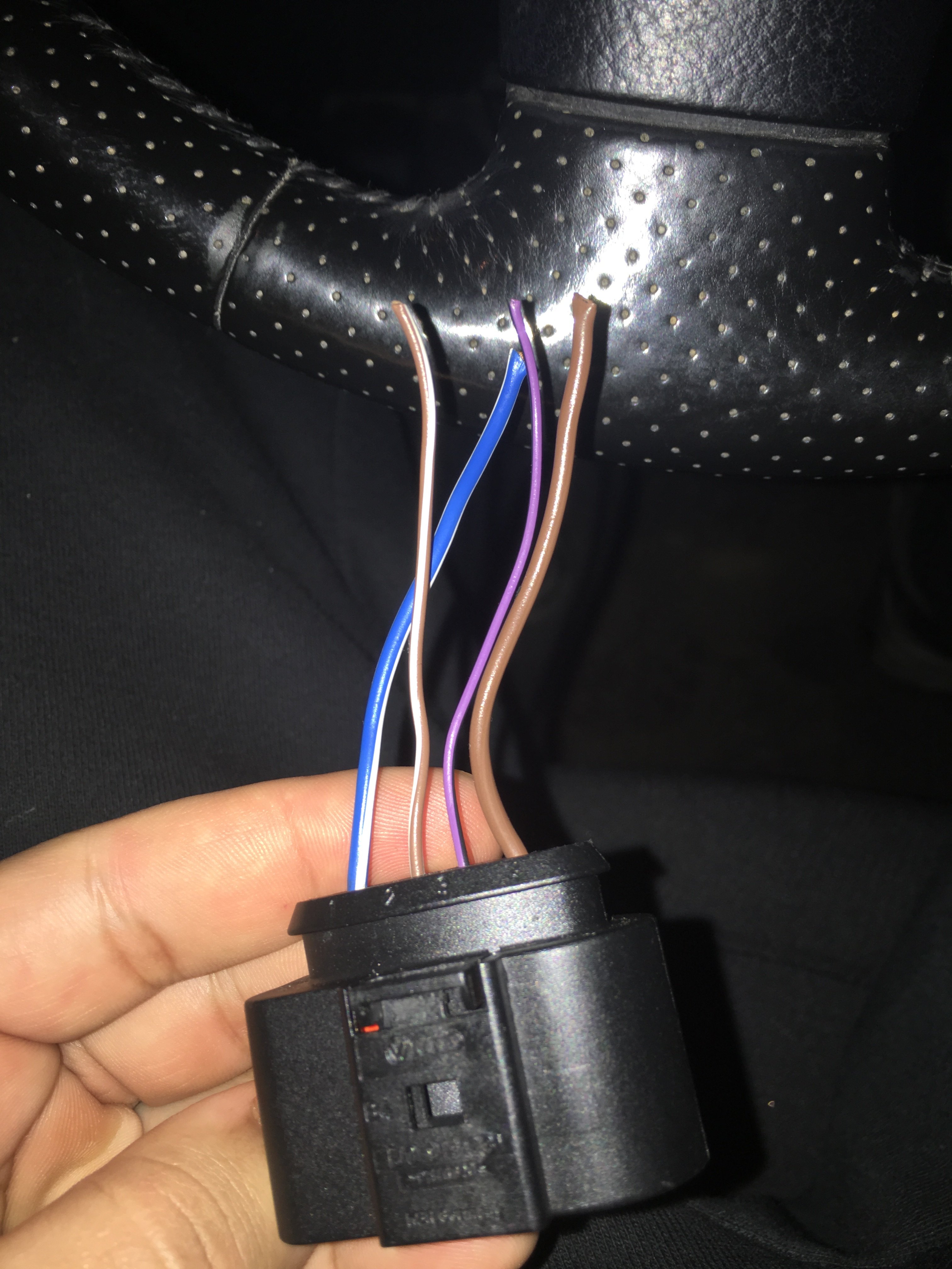

I'd be investigating that wire at the pump connector too. The track repair might just blow again if someone's bodged the wiring. I can't work out why someone's joined the yellow wire to a purple and black wire.
Thats what is confusing me too but i was planing to rejoin the wires with a spare plug which come with the pump but i thought I might cause more problems
Looks like it's had the connector plug changed at some point but the wires do look correct as the purple and black wire is joined to the yellow in the right place. Are there any other joins in the rest of the connector plug wires?
If there are no other joints I reckon the insert at position 3 in the connector plug has been changed and someone's just used a second-hand insert with a random yellow wire and that's why it's like that. Not a problem if it's been done properly.
Edited by TMB
Weli have no traced the wiring from the pump to the front of the car , but the wiring which is visible when i remove rear seats i cant see no joins other than the plug , would it make a difference if the wires were different size? As the yellow wire is alot thicker compare to the purple and black
No, makes no difference at all that the yellow wire is thicker.
If there are no joins at the rear it must be just the insert has been changed which is OK.

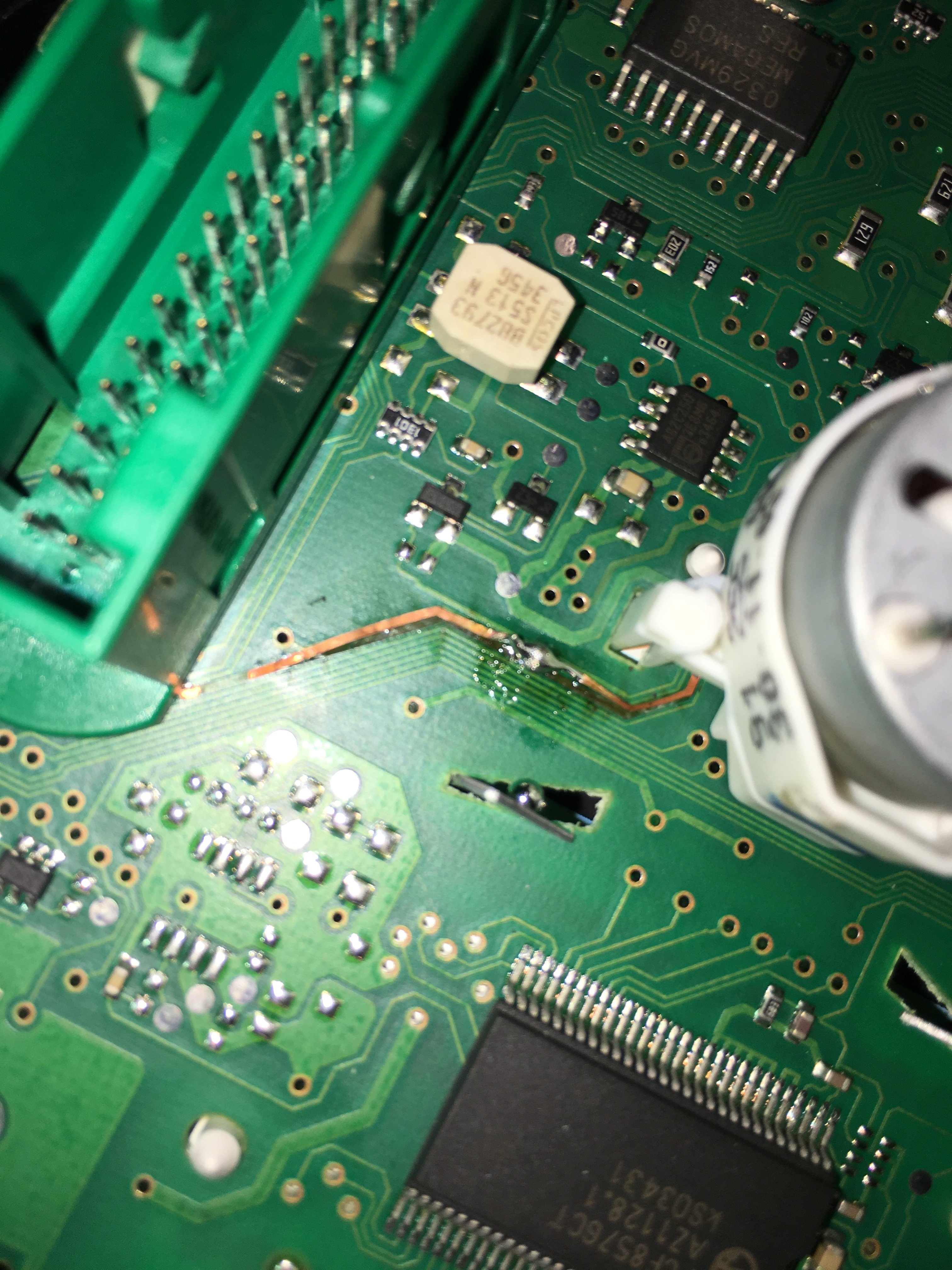

I managed to solder the track where it was broken , after soldiering i used multimeter for continuety test and and ohms test and i got a reading of 00.2 instead of 1.  i knew the track was fine , so i started the car the needle was still  3/4 and I thought maybe i need to drive so i drove around 25-30 miles and the needle is still at 3/4 tank, so the problem is still here
There is a picture after track been repaired
Looks like a second break just before the terminal block. May have to jump that cable track full length.  Are new pcb’s not available?
Edited by Mikek3111
Best thing would have been to bridge here with a thin piece of insulated wire...
What is pcb’s?
But if im getting a reading from the multimeter doesnt that mean the track is good and there is no break in the track ?
  • Sponsor
Repair looks OK, well done.  PCB is printed circuit board, i.e. the whole thing. For reasons already mentioned, that's an absolute last resort.

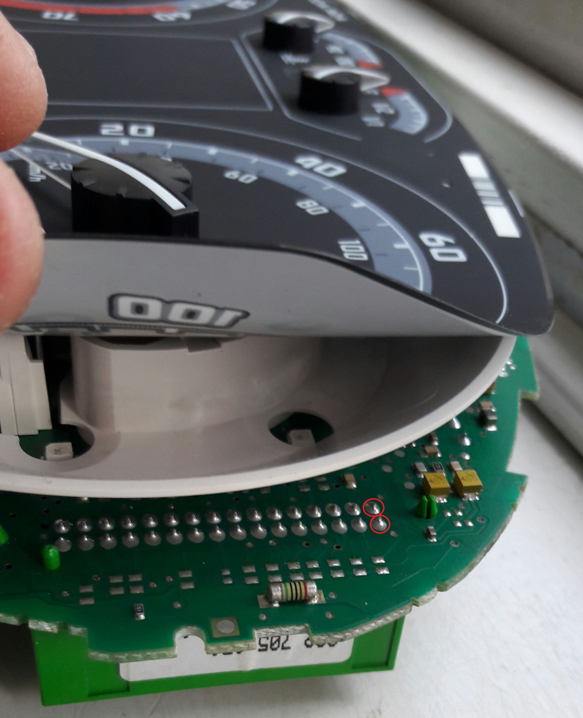

I'll have another look at my spare this evening, I never got round to following the circuit from the other pin (15, I think) to see how things work.  One thing you could do is to have a look at the soldering of the green connector pins on the other side of the board. These joints often do cause problems where the solder cracks away from the pins.
Can probably see enough without removing too much, just by lifting the edge of the plastic, like this:
Ignore the red-ringed pins, they are immobiliser related, you want to be looking at the ones at the other end. 15 is second in from the left, back row as we look here.

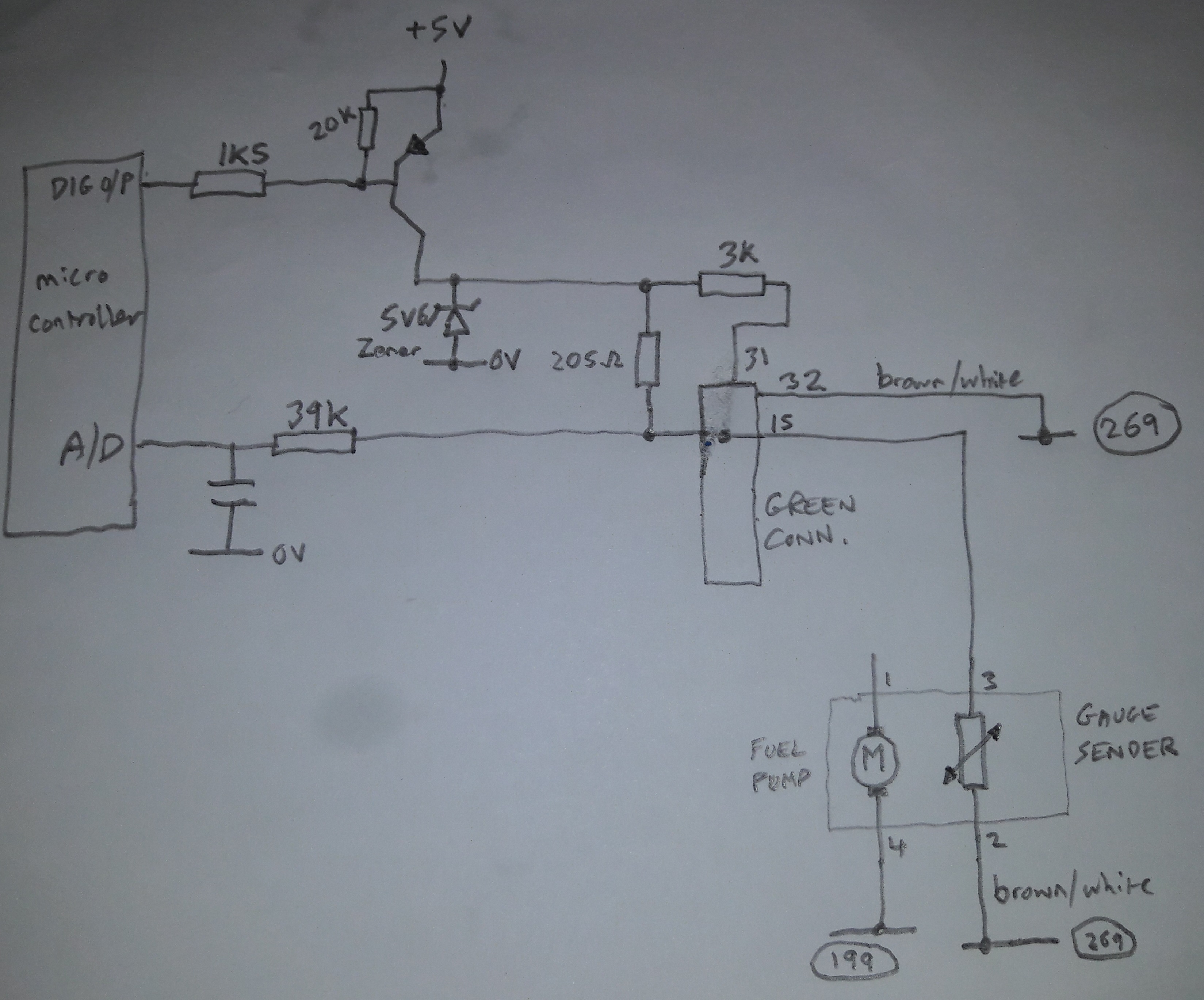

I have now worked out the circuit on the cluster PCB, but not sure how much it helps.  I'm hoping to get to my Polo's fuel pump/gauge connection tomorrow to measure some resistance/voltage numbers so that I can have a clearer picture of what should be measureable for a healthy system.  There are a couple of assumptions in my circuit picture, as far as the functions of the two micro-controller pins are written, but fairly safe ones I think.  Rail 269, 'sender earth' appears to connect to other senders within the engine bay, as well as the fuel gauge, so I'm not clear about how the track on the board connected to this has got burnt, without affecting other sensors.
Anyway, here's the input circuit as far as I can tell. A transistor is switched by the microcontroller to apply a (fixed) voltage to the top of a 205 Ohm resistor which forms a potential divider with the gauge sender resistance. The voltage at the midpoint of this divider goes from pin 15 via a 39K resistor to a pin of the microcontroller which will digitise the analogue voltage and then use the number to drive the motor/gauge needle as appropriate. Pin 31 of the green connector goes off to the ambient temperature sensor, so if that appears to be reading correctly, it may be a clue that the voltage coming from the transistor is still OK. It would be useful to check that there is continuity between the loom wire that goes to pin 32 of the green connector (from which the burnt out track comes), and pin 2 at the fuel pump connector (brown/white in both cases).
