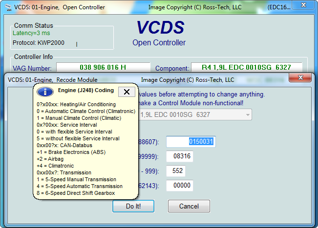

  • Hope this helps, I just turned off the cornering fog lights on my Toledo and my daughters and first time it didnt work because I didnt click the "do it " box on the bottom after ticking the options box.
