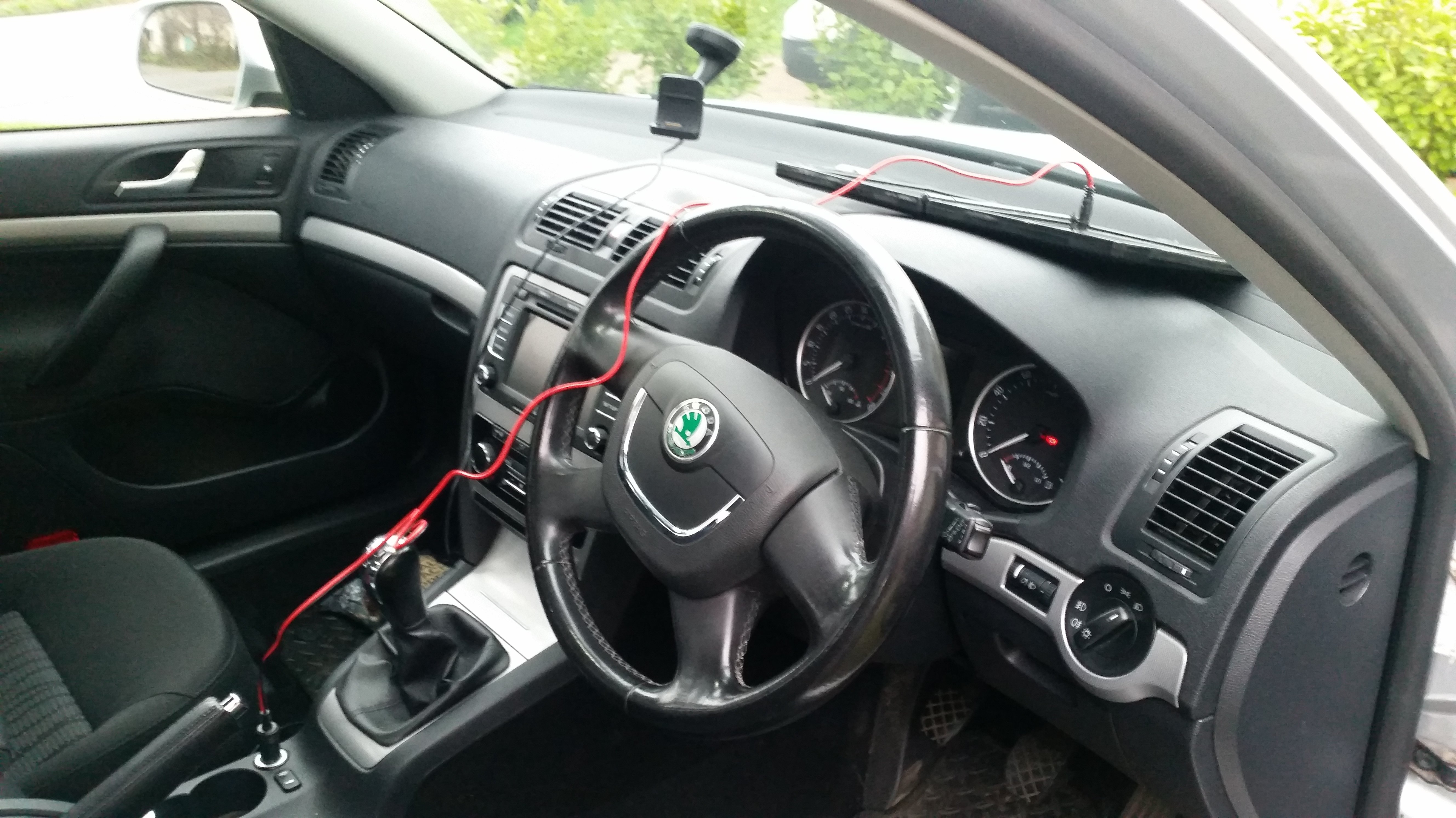

Regarding the solar charger has anyone ever fitted this. For me it would have to be super neat and tidy!
Mine is just plug and play, as the lighter socket remains live without ignition on.

I think the idea is they give just enough charge to prevent battery drain whilst the car is standing.
This is why i recommend using it most, if not all the time the car is stood, plugged into cig lighter socket.

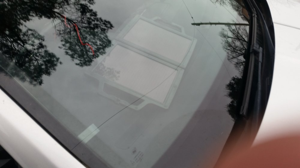

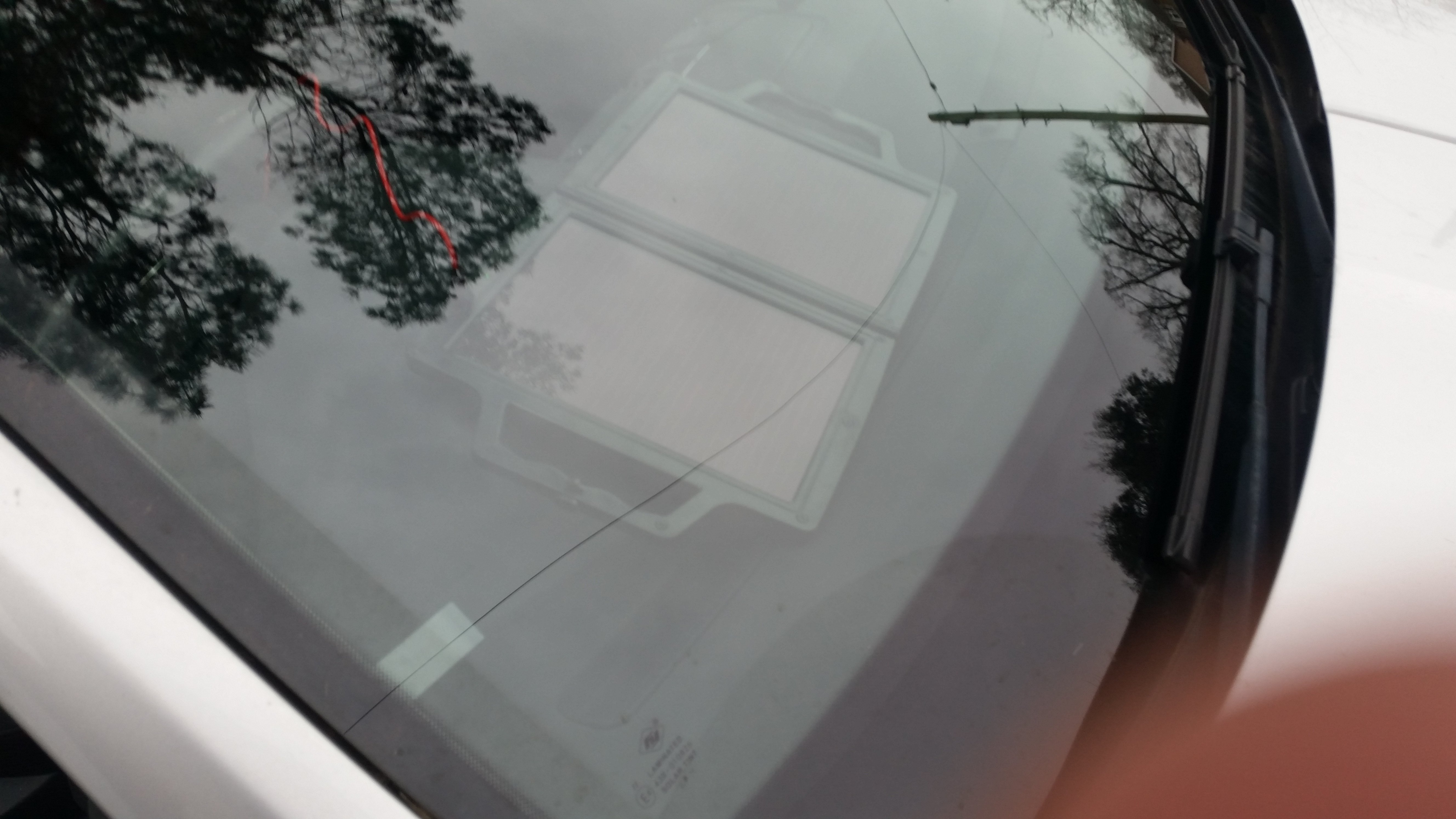

Well I got it and I will be testing over a few weeks should be interesting. The leads could be a meter longer but never mind.
