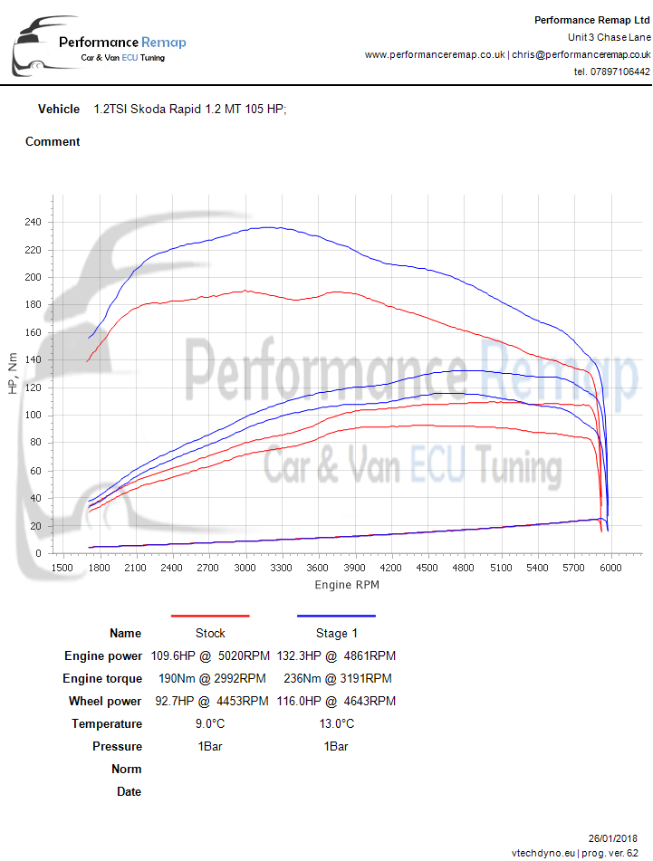

So have been thinking a lot about a remap... here is a sample graph from the dyno that PerformanceRemap showed me of their stage 1 for the 1.2 TSi (105)...
I'm no expert so what are peoples thoughts/observations?
From what I can see the 105 actually had 109bhp to start with. And I'm wondering about the flat spot around 4000rpm in both the BHP and torque?
I realize this is a silly question but what would the difference be.... post map, drive wise?
One thing I notice is that the temperature rose 4 degrees C between runs but the barometric pressure remained the same.
Dyno's have been in correctional factors that account for those 2 variables.
It also looks like 2 stock power runs and 2 stage 1 power  runs were completed but only 2 torque results are show - just seems like odd inconsistancies.
Display shows 3 lines per run. I'm thinking, Power at wheels, Power at Crank, Torque.
The 9 dgrees is cooler than ISA (international standard atmosphere) so it should beat the factory 105PS (103.5bhp) figure which would almost certainly be tested at higher ambient. The subsequent increase in ambient is actually penalising the tuned run so the gain is possibly more than shown.
To see how quick these chipped 1.2 are search on youtube.
Also I have seen stock Rapid 1.2/105 engines dyno'd at 116PS by Czech magazines before now.
Revo offer more outright power I think, but for sheer value Racechip offer +14bhp +35Nm for Euro149 with a tuning box instead of map.

To my eyes the map looks quite smooth. My understanding of the tuning box was they mimic the original curve - but I could be very mislead on that.

I would appreciate your thoughts on this dyno::
Seat_Ibiza_6J_12_TSI_1197_cc_2008On_103_
It would be easier to read if the Bhp and torque scales were at opposite ends of the graph, but it shows a good increase in power and torque. I'm not sure if this Beetle engine is identical to an Ibiza/Toledo/Rapid/Fabia one, but Google list of VW engines will clarify that. One thing I've never seen on these graphs is an extension of the rev range. The 1.2 with it's tiny turbo seems to run out of puff at 6000. Even the graphs for Revo's 144bhp drop dead at the same revs as stock.
EDIT: Wiki says all are EA111 8v chain-cam CBZB (105PS) engines - allso in Polo Mk5 Golf Mk6 Octy Yeti Audi A1 blah blah blah.

The troque looks very different to the one I posted... and there looks like a couple of dips in the curve (not very smooth) but I’m no expert...
The torque on the performance remap looks loads more than the Celtic tune...
