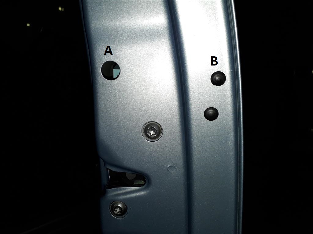

The door lock on my MK2 Octavia just turns 360 degrees in both directions and doesn't lock or unlock the door.
I've done a lot of searching and cannot come up with the definitive answer on how to get the lock barrel out.
I have an idea but want to check before going ahead.
Am I right in saying that the torx screw accessible in the hole marked "B" in the attached photo is  to release the lock barrel?
If so, can anyone who has done this give me some advice on how to proceed please?

I should add that I've seen many examples of removing the MK 1 lock barrel. It's done by releasing the torx headed screw in the one hole that is present on the door, marked "A" in the pic.
I also hear that you should unscrew the screw 3 turns, elsewhere 12 turns, elsewhere until you detect that its completely undone and then screw back in a couple of turns.
Also, don't take it out completely or something will fall into the door and with the inner card riveted on I don't want to get to that stage.
All of the above relating to the MK 1.  I'm really looking for someone who has already done it on a MK2 who can confirm that the screw inside the hole marked "B" is the correct screw (it really looks like the correct one close to the barrel itself) and how to go about removing it.

For anyone coming after me, this is procedure I used...
  1. Hold the handle out a small bit (not sure if that helped but that's what Skoda says).
  2. Unscrew the torx screw in the hole marked "B" in the image below three turns.
  3. Move to hole "C" in the image below.  I was unsure how much to unscrew this, always afraid that it, or something else would fall into the door. Initially I unscrewed it three turns and pulled on the key. Incidentally I turned the key 90 degrees to allow it to remain in the barrel while I pulled and wiggled it.  There was no movement at all on the barrel so I turned screw "C" one turn at a time while wiggling and I could see a gap appearing between the door and the lock surround. This went on a turn at a time with the gap increasing until I reached twelve turns and the lock came out cleanly.

Great advice. I had spent ages trying to get barrel out but as I only went 4 turns on screw B for fear of losing lock into door I was never going to get it out.After reading this I kept turning screw B whilst wife was pulling on key in lock which came out after about 6 to 7 turns. New barrel easily fitted - was quoted £125 labour charge by skoda garage to do this job. Workshop manual instructions were pretty useless but if anyone else needs to replace lock barrel follow instructions given above by Garfieldus and you will find job easy.

Hi All, Just did this on my Ocy Scout (2010) and ' garfieldus' is correct as like he says the ELSAWIN instructions are not complete ! 'Andrewv' has mixed up the 2 screws slightly, the top one should only come out 3 turns max or it will fall out into the door, then move to the lower screw as it undoes a clamp around the lock barrel, the barrel comes out complete with its plastic surround ! Cheers Stuart

Thanks for your help, this lower clamp screw was only visible when I shone a bright light on it. By slowly unscrewing the T20 screw and pulling on the lock barrel I managed to withdraw. It was then an easy job to adjust the door handle cable.
