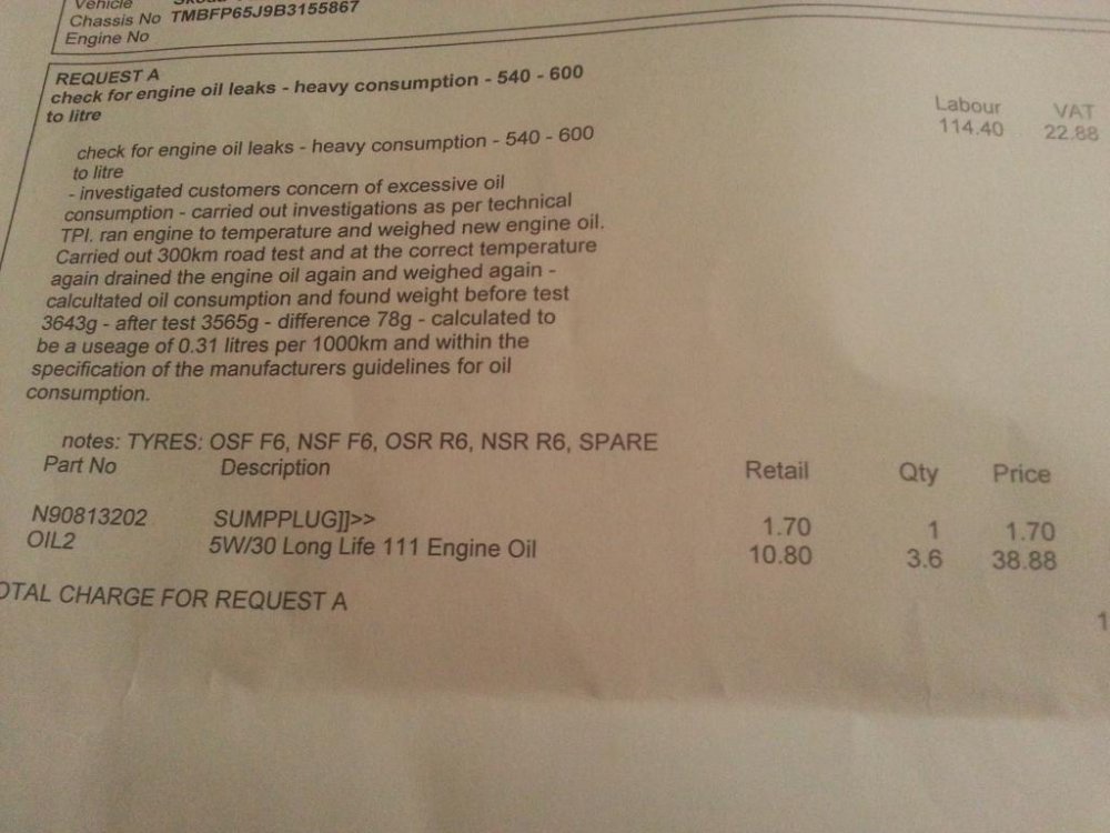

Hi all. I have had my Fabia VRS for 1yr 3 months now and its just on 60k miles.  Later CTHE engine and it drinks a lot of oil.
I've just had the SKODA oil consumption test done under warranty that (surprise surprise) revealed it is normal. However real world consumption is nothing like what the test says. Not even close!
I'm wondering if anyone can advise me what is the best tactic to take and what I can reasonably expect to resolve this from SKODA?
Thanks! :)
Welcome.
Put up the figures from their test then.  Tell how they did the test.
Are they saying it does not use 0.5 litres in 1,000 km / 621 miles?  "within tolerances" according to them!
Did the test last 621 miles or even 1,242 miles and 1 litre not used?
Or was it a 300km / 186 mile test?
As it is 0.3 litres in 621 miles is excessive and an Oil User and cars have had new Oil Spray Jets, then if still had new
Engines when tested and using 0.3 litres in 621 miles.
How much the New Oil weighed when drained before the test, then what it weighed after the test & how many miles covered between
the first weighing and the 2nd.
Do you have the written report.
This example below is done wrongly.  & gave the wrong / incorrect result, and the owner did get a new engine.
But it gives you an idea, i will tell you later what is wrong with it.
& see the pinned thread at the top of the page. Lots of pages, but go to the last pages maybe.
