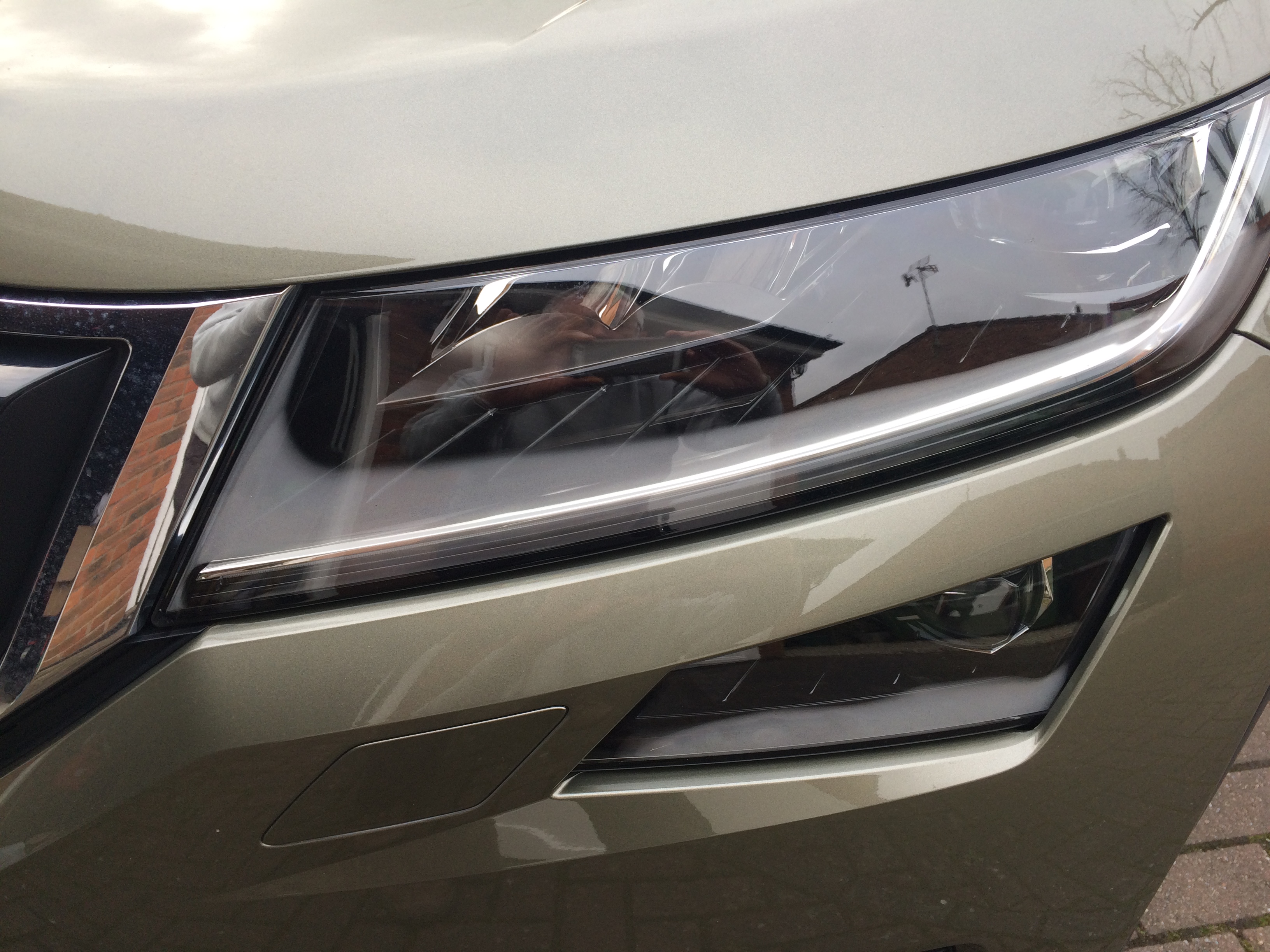

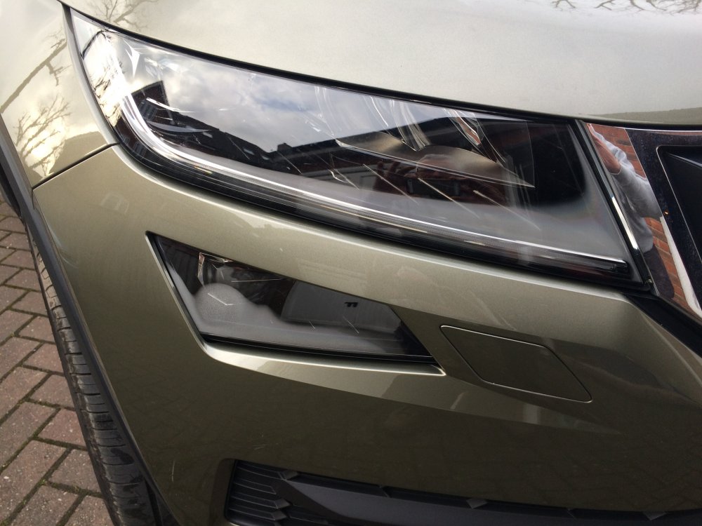

I have a 9 month old Kodiaq with full LED package.
Never seen this before today after 9,000 1st oil change service yesterday must be coincidental ??
Both sides of main LED Headlights & fog lights have partially  fogged up.
Outside temp 3C
This can't be right surely?
Must be a long term risk of water in electrics problems.
Anybody else had this?
I'll refer to service but am away for a while.
See attached photo's

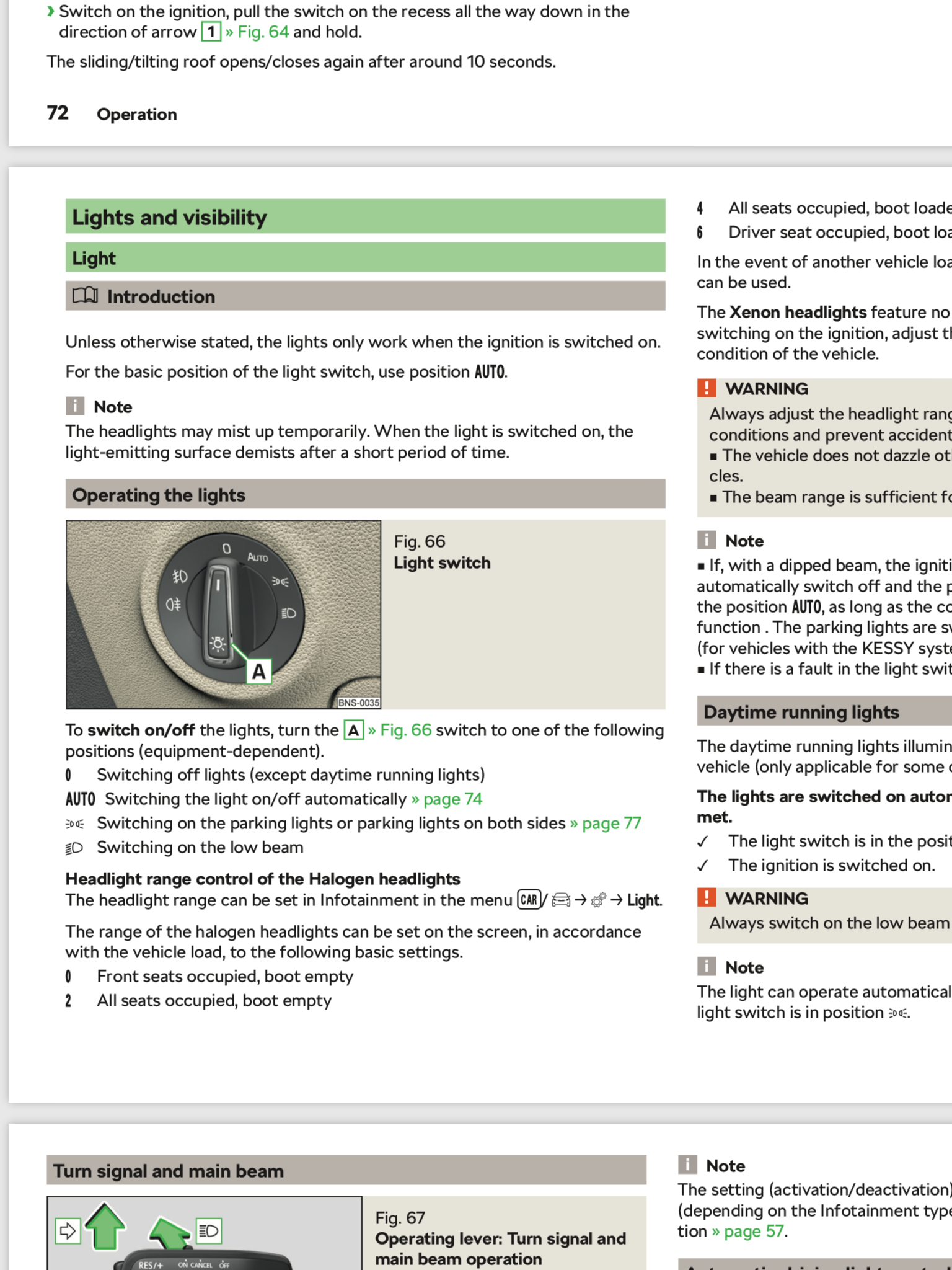

Misting up is normal apparently...
Well it's another case of RTFM then!
Will keep an eye on it to see if it persists.
Shouldn't the units be sealed to prevent this?
At a guess they jet washed your car ........
Yep!
”They all do that sir”
Not enough heat in the LED lamps to dry them out at this time of year (is my simple theory).

We happily expect windows to fog up, so why not the headlamps?  Answer: because we expect the headlamps to be sealed, allowing no transfer of damp air in.
But ... halogen, etc, bulbs work well when hot (in fact, the brighter the hotter), but LEDs don't.  They need to be kept cool(ish) to give of their best.  I wonder whether the Kodiaq headlamps are vented for that reason?
Headlamps haven't been sealed for many a year - they all have vents in.
Chances are it got jet washed and parked up.
If it had been driven straight away the air flow heat etc would have helped remove any water vapour from within the headlights.
It will go away, don't worry about it unless you have actual water droplets collecting in the bottom of your headlights.

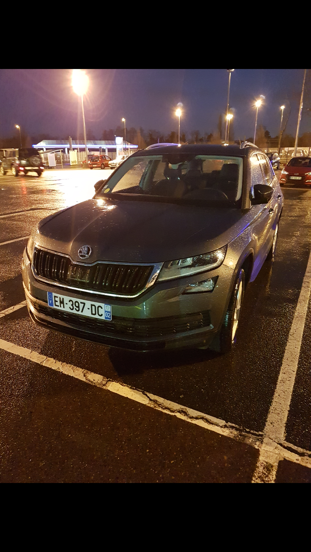

Hi,
got the same experience with one kodiak that i tried: see attached

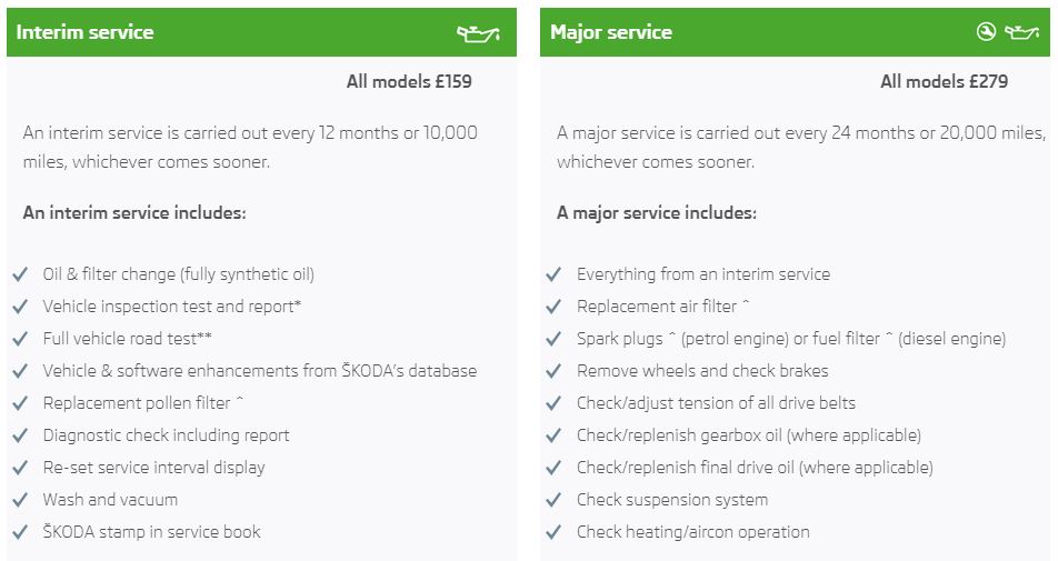

On 06/02/2018 at 18:25, vizslabob said:
pristine clean after oil change got to do something for £149
Mind you my local Eastern European staffed hand / jet wash does a brilliant job and has never fogged up my lights.
Jut out of curiosity, are you on fixed service intervals i.e. 10,000 miles or 12 months, whichever is reached first?
£149 sounds very reasonable for a first service, even more so if it is on variable servicing (up to 20,000 miles or 2 years). This price is usually reserved for cars over 3 years old...
Even more so now they've put the price up by £10...
