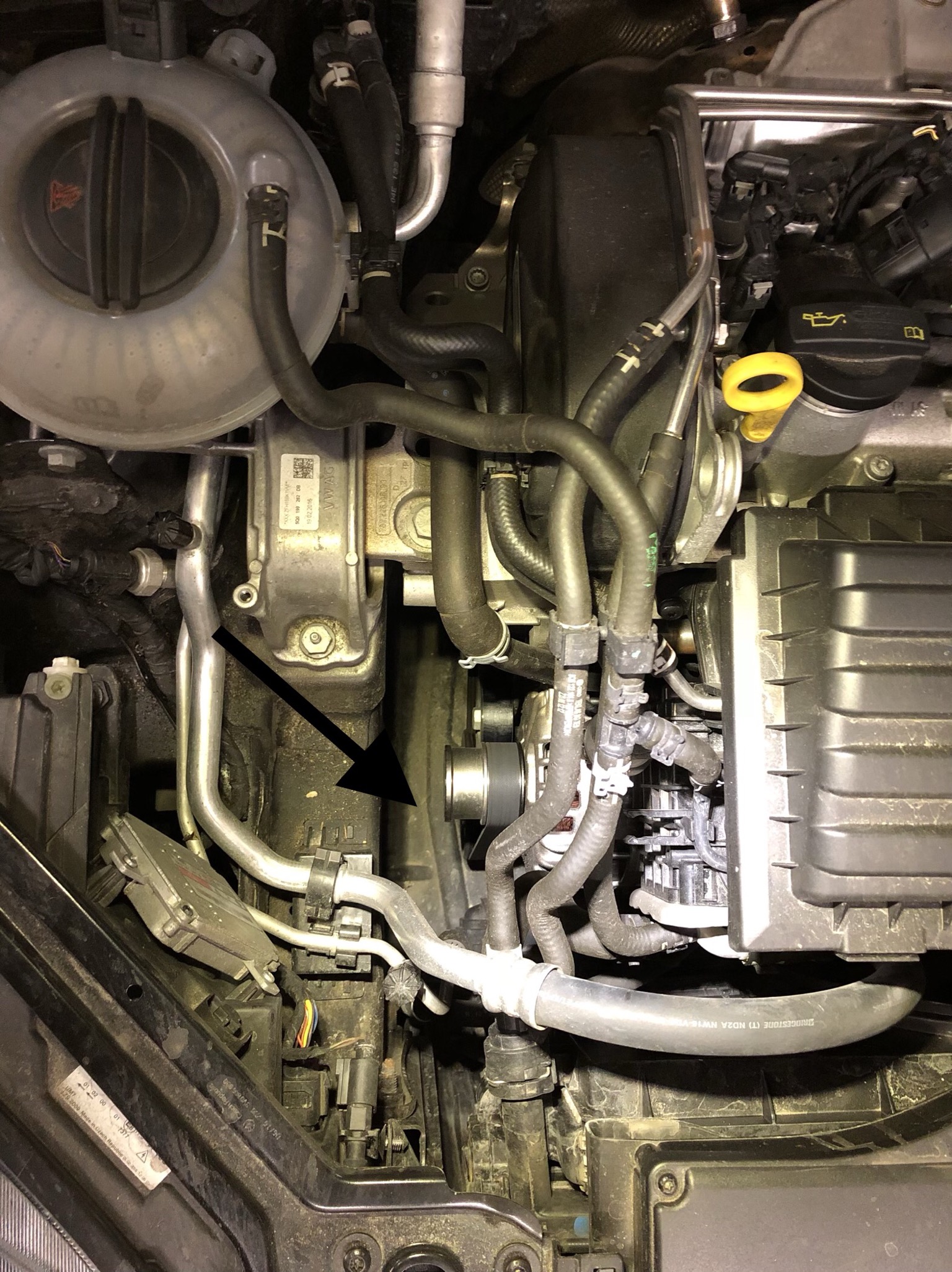

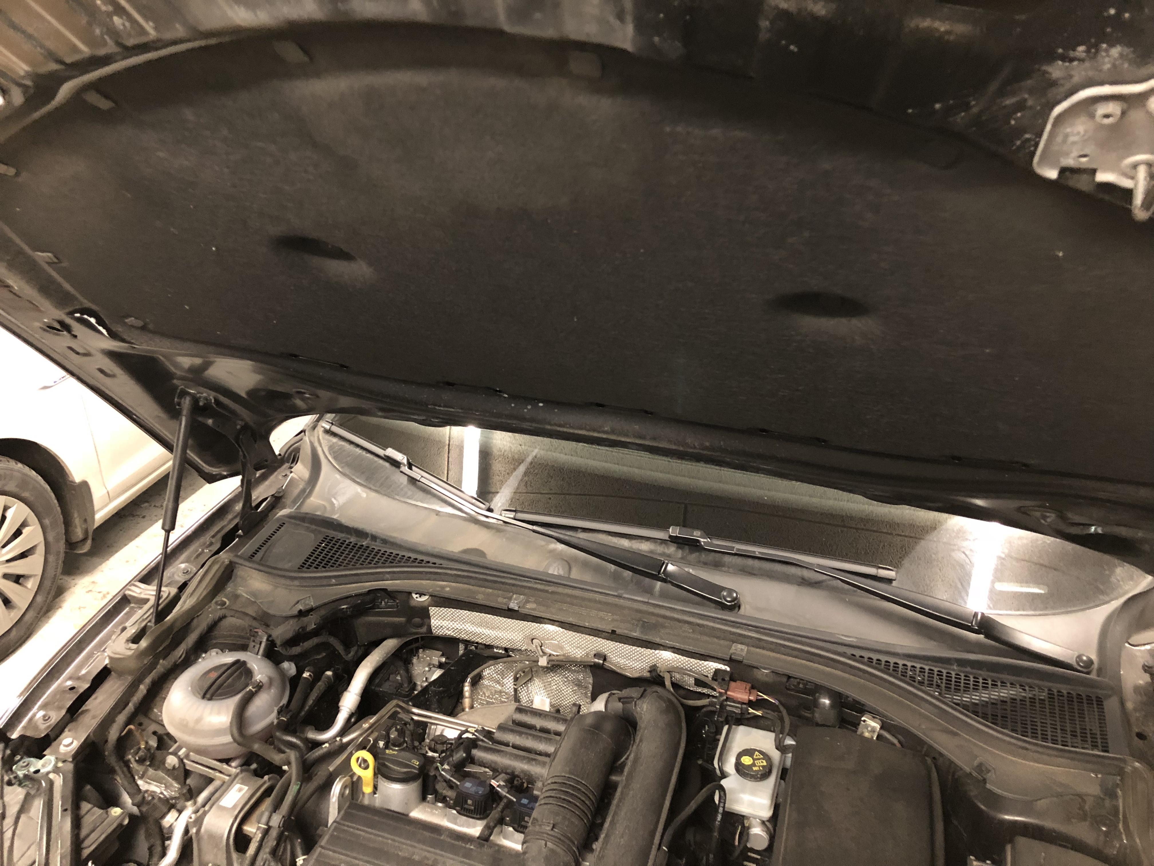

Mine is an ambition (SE) that comes with 16” wheels. It has under bonnet insulation and a full tray under the engine (1.4 TSI). Again, my car does not have the ‘rough road package’, but the level of equipment my vary from one country to another.
Hope these photos covers your question.

My car now at dealer. At a quick glance, the sump is not covered, but just about everything else is, including to the sides of the sump hence the pics from Gaselle although correct, don't show the gap for the sump.
