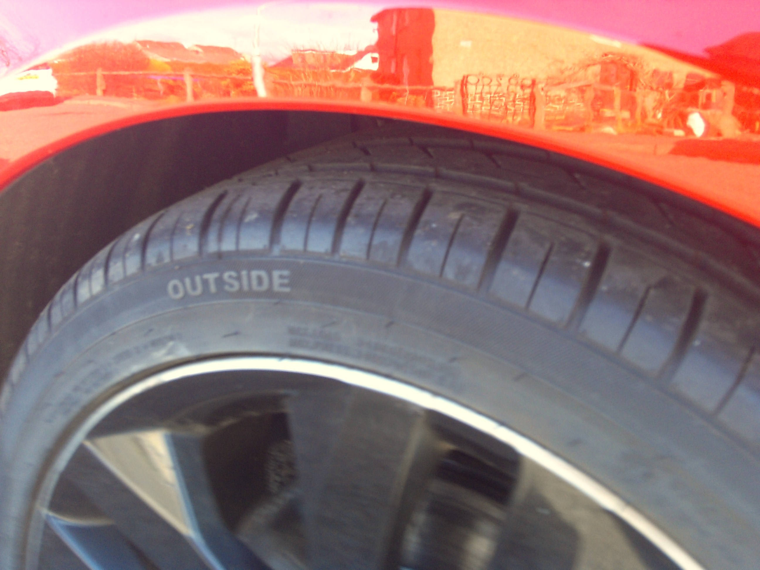

If the lettering  'OUTSIDE' is not on the Outside
or the direction arrow if there is one is not pointing forward and down they will be on wrong.
Are the Bolt seat OK, no paint in them.  Have you checked the tightness again?

I don't see "outside" written on the tyre but I will get a second pair of eyes to make sure.
Thanks for the picture too.

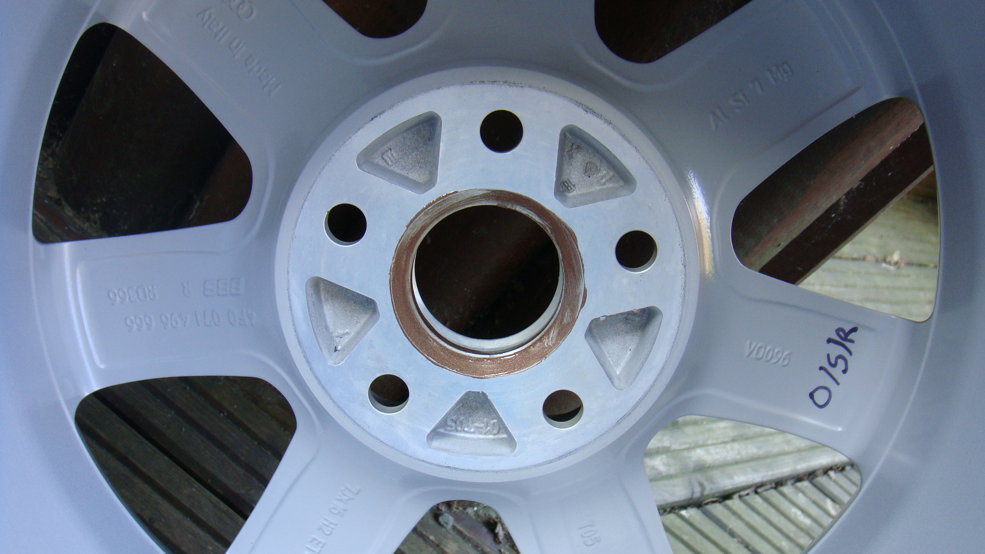

You would need to take the wheel off to check but sometimes the centre spigot of the wheel (the part with the copper slip on below) has too much paint / powder coat on it meaning the wheel does not sit flush on the hub, this will have the same effect as a buckled wheel and will result in vibration:DSC01370.thumb.JPG.ea9d340308e220b7c8947f03e85f9836.JPG
And if the face going on the hub as in that picture has Powder Coating or paint on it get that cleaned off.
No vibration but worth a look . Thanks for the advice and help. Much appreciated.

Gizmo posted the important bit.
The wheels are a tight fit on the hub, and sometimes the wheels are badly corroded in the centre bore,
you want the wheels off and check them.

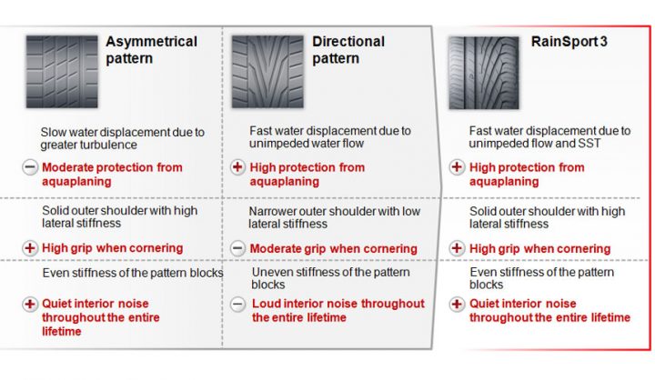

Asymmetric is different to directional tyres.  Asymmetric has an inner and outer, they sometimes have an arrow which can be confusing, but by definition two will have arrows facing backwards as all the tyres are the same.  Directional tyres are symmetrical, so they don’t have an inner and outer but the arrow must point forwards.
if it sounds like the car tyres are humming/whirring, then they are worn in an egg shape and you’ve somehow got an unfortunate combination when the wheels were put back together to make the noise more noticeable than before.  How much tread is on the tyre as they’d need to have some reasonable wear for this to happen.  Also, what is the steering like, does it pull or drift one side or another on the dual carriageway?  This would suggest the alignment is out and hence why the tyres have worn unevenly and hence the road noise.

@Garythenoo - Asymmetric tyres refers to the construction, not the tread pattern. They can also be directional so check for arrows which should point down on the front end of the tyre (as fitted) and up on the back end.
Otherwise it's also possible that they're all correctly fitted, but on opposite sides having recently been reversed to cure the drone caused by saw-toothing before you bought the car.

I’ve never heard of an asymmetric directional tyre.  That would imply you have to buy left and right tyres?  What spare would you carry and what would the tyre retailers stock? :-/
Avon ZZ5 are asymmetrical, so check inner and outer.
