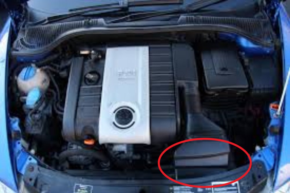

I've circled it below in the image - but there should be two screws that go through the plastic of the housing into the body of the car. On my plastic air box the plastic where the screws would go through have come off. So the screws are in the body and the box is not attached at all. I suspect this is what is causing the knocking noise. Does anyone know the part number so I can replace it?

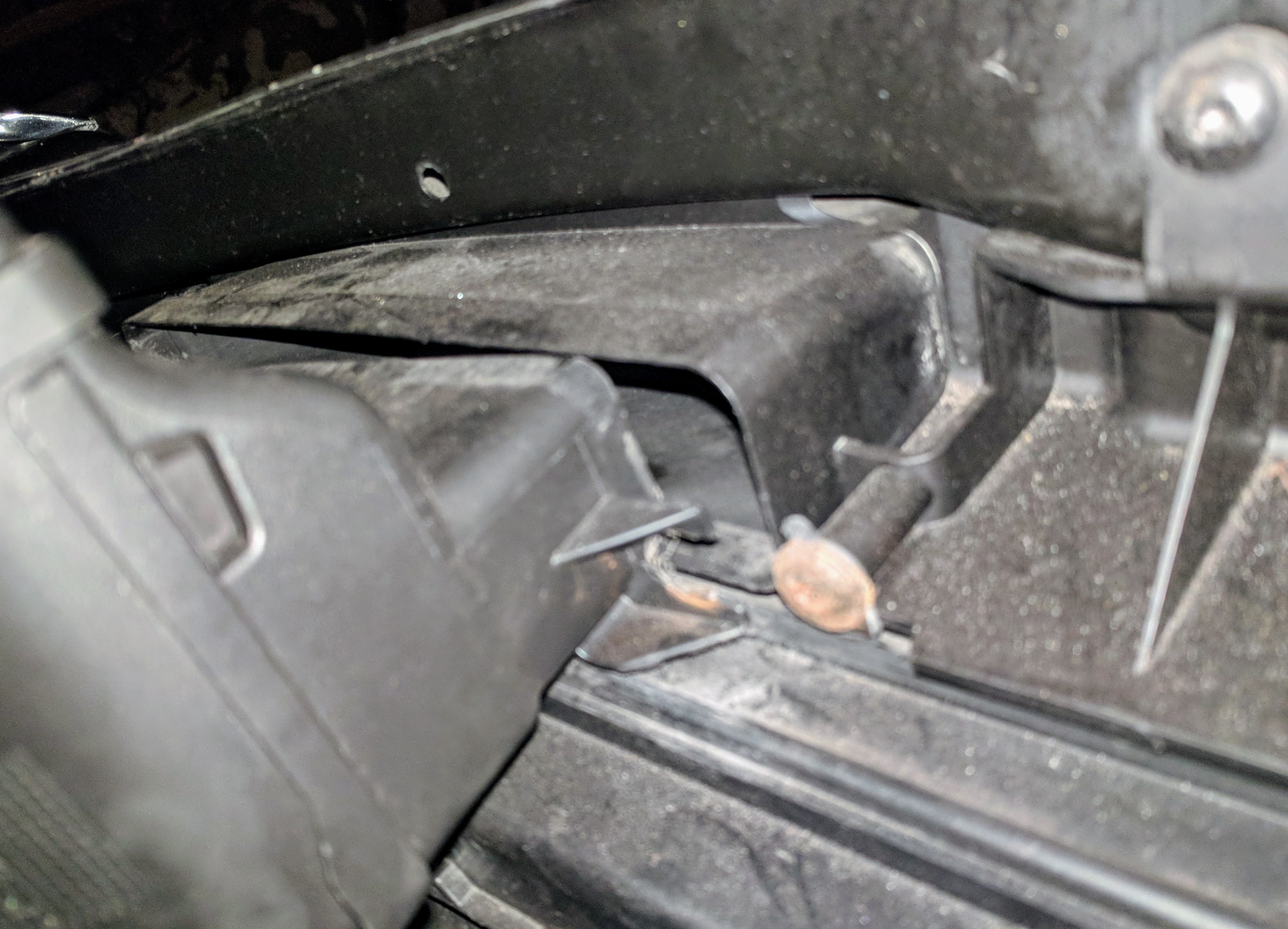

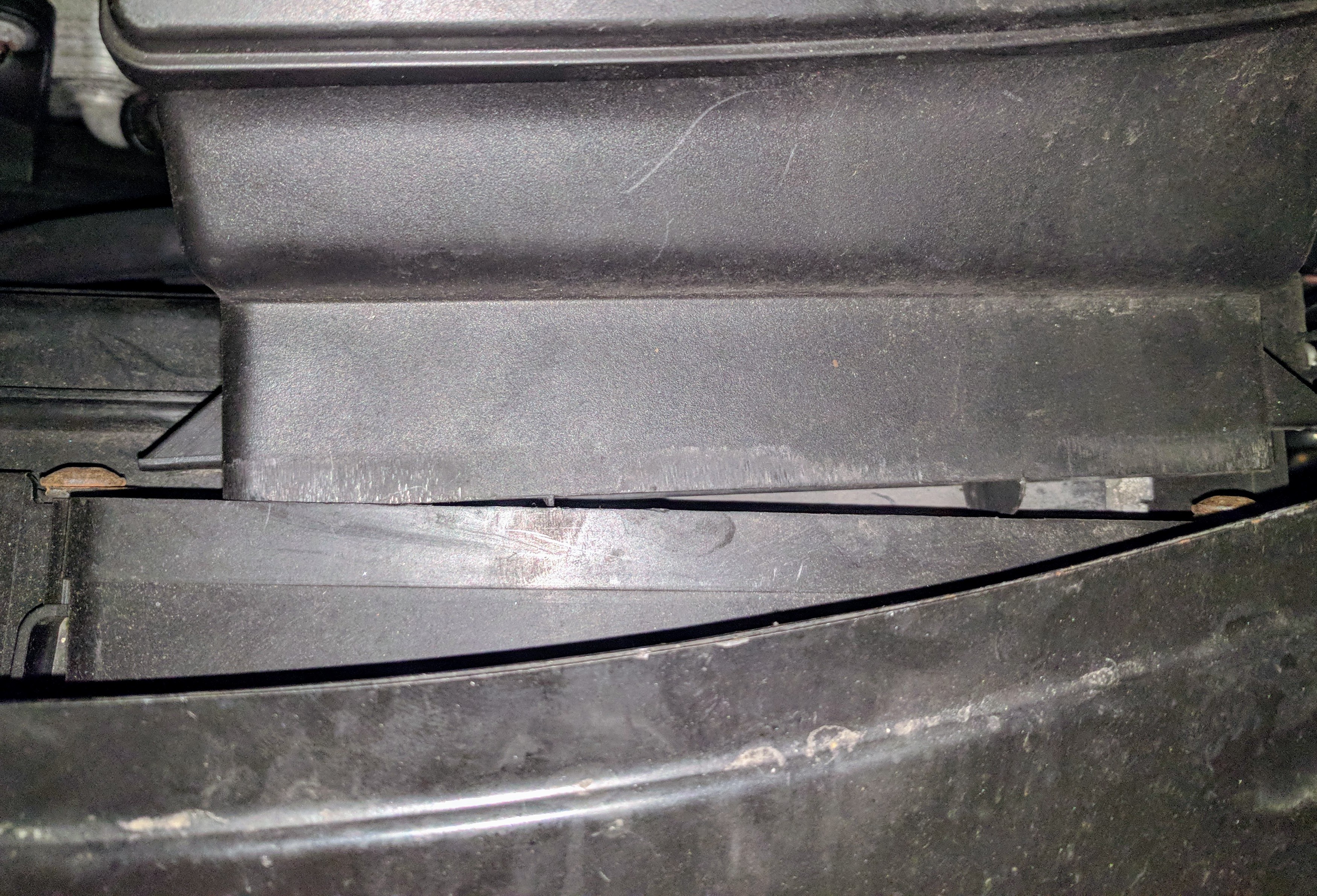

Here are some pics!
Pretty clear the mount has popped of the screw
You might try to repair it (instead of replacing it)
I think with some epoxy glue or similar you can easly fit a small ring into the remaining piece. Once the glue has dried, its likely you can just use the screw as designed.
Maybe you even don't need any glue, just add a ring to the screw to increase its outer diameter so it will hold the plastic piece. There is almost no force on this screw so it should be an easy fix.
Just remove screws on both sides, pop it back in, add a small (penny) washer and place the screws back.

Yeah I was thinking of using a large washer to keep it secured - assumed the plastic part wouldn't be too expensive if I could find it! I'll grab some washers tomorrow and see if that does the trick!
