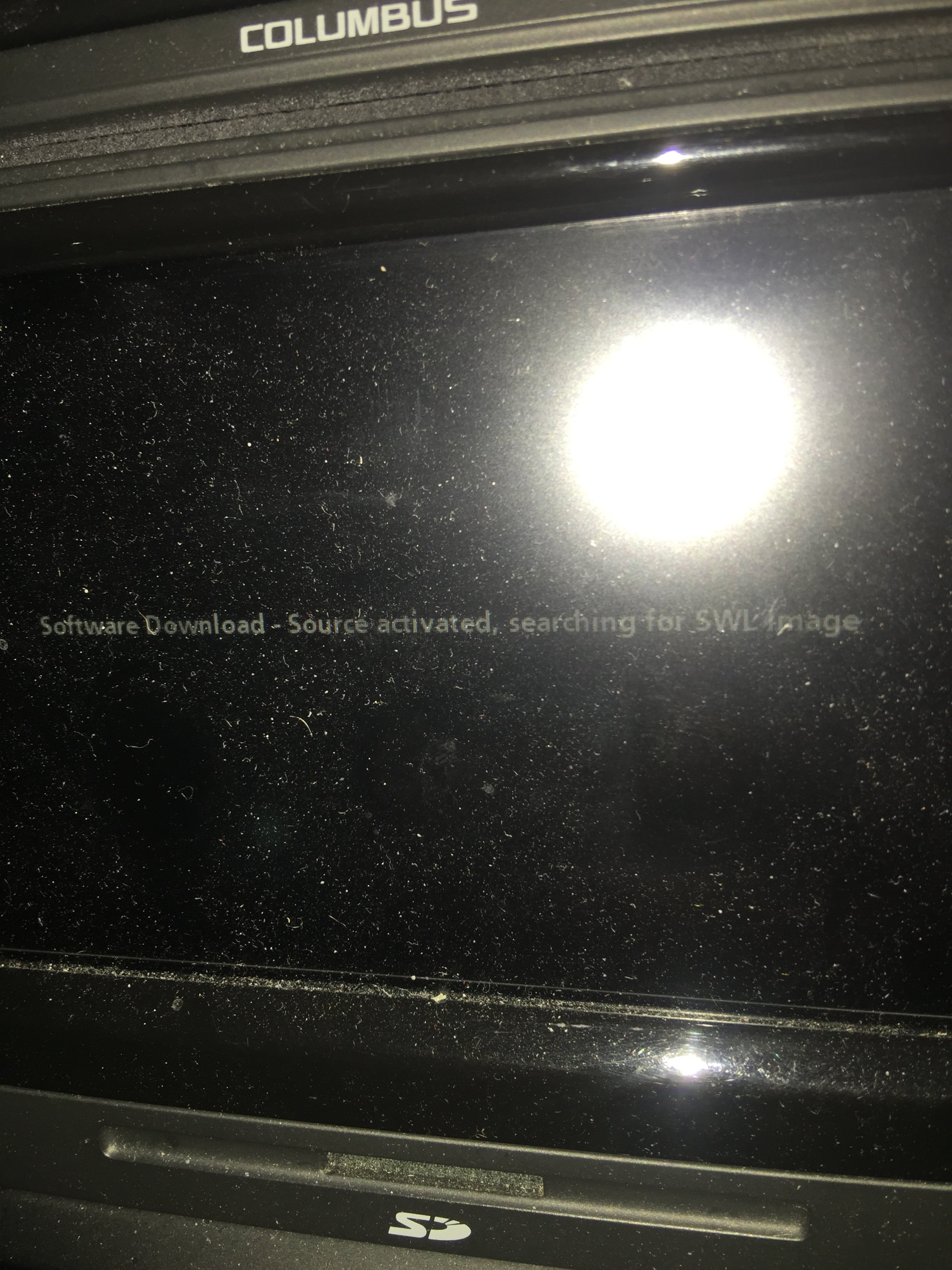

Got into the car this morning to see this on my screen and the battery as flat as a pancake - can anyone help with what’s going on please? Many thanks :)
Damn thing won’t reset or switch off unfortunately :(

Battery flat again this morning - would it be a plan to pull radio fuse out so I can continue to use the car without draining the battery until I can get software update on Monday?
It shouldn't hurt more than the current situation
Fair point!
i just removed what manual says is radio fuse and display disappeared and nothing would come on - back to the fuse diagram...
pull f8  (15a) in the engine fuse box not the cabin one
That’s exactly what I did as the manual said same - it did stop power to head unit, but no ignition lights etc :(
I must test mine then. it is listed as radio only.
You are sure you pulled f8?
Yeah deffo unfortunately
