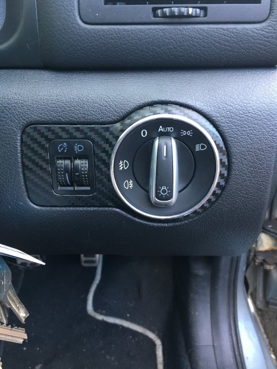

I wanted to fit the auto headlight switch from the Mk4 golf.  There's a whole host of sellers on Ebay offering them.
However, all the posts I can find referencing this seem to be for the Mk2 octavia.  Can the headlight switch be swapped out on the Mk1?  I would have thought the Mk4 golf switch would be a direct swap?
I have pulled the switch out of my car, and the connection on the back looks identical to the photo of the connection of those offered on ebay.

Hi
yes you can retro fit that into your octy. I have one very similar to it in mine. The only difference with mine is there’s a separate control box.
Thanks for getting back to me.
It must be something like this one??
https://www.ebay.co.uk/itm/New-Auto-Aluminium-Auto-Headlight-Sensor-Switch-For-Jetta-Golf-MK4-1998-04-VW/142468536135?hash=item212bc95747:g:fK8AAOSw9KhaBSBk
Does this enable the "come home" facility, where the head lights remain on until you lock the car, so you can use the lights to illuminate your way to your door?  I live in the sticks, in an area with practically no streetlighting, so getting home on the dark knights is a trecherous affair, and then the inevitable fumbling for a house key and locating the lock purely by feel.
