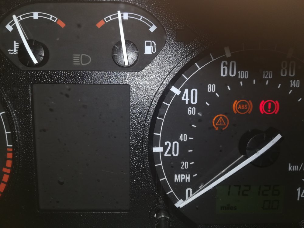

Hi front bearing is humming and my speedo went all funny then abs and triangle light came on and traction control doesn't work am just right in thinking its the bearing that's caused the warning lights to pop up thanks for any info
If there's play on the bearing it might have affected the wheel sensor.
Edited by TMB
I was told it might have something to do with the magnetic strip in the bearing loosing contact with the abs sensor
Yes could be that. There is a magnetic ring on the back of the bearing.
So it's a new hub  then as I'm sure it's a sealed unit
A new Gen2 bearing, yes.
OK cheers for the info mate
No probs.
Make sure whoever does the bearing knows not to press it in by the hub flange or it will be ruined. Gen2 bearings need proper tooling and can only be pressed in by the outer bearing shell.
