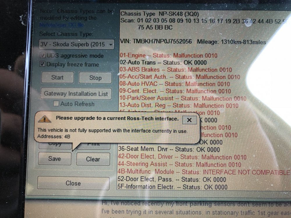

I keep getting the attached error.
I was was connected to my 2018Superb and upgraded to VCDS 18.1
I was only fault scanning and kit tried coding yet.

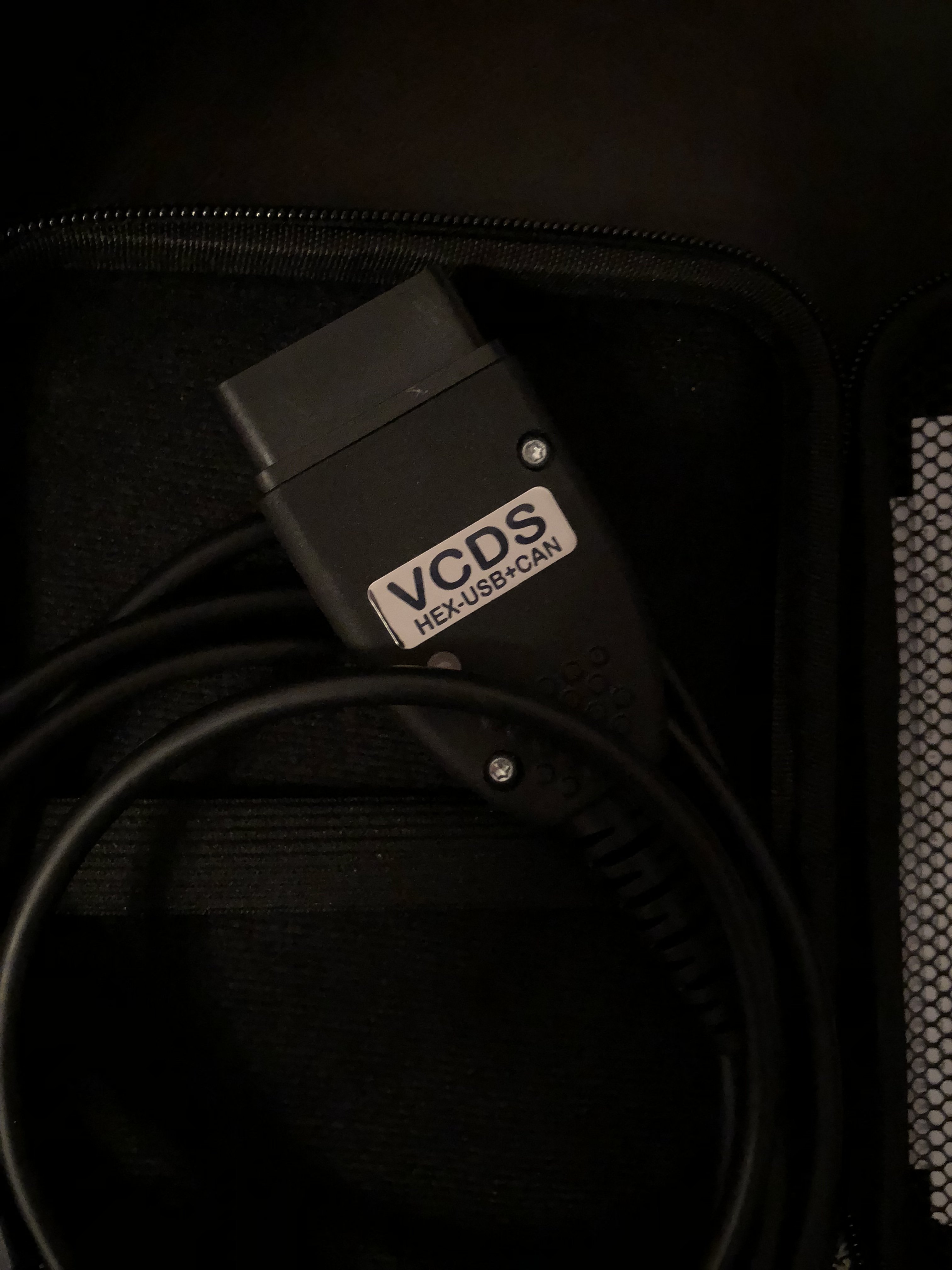

Its a genuine cable hex can
Purchased in 2015
Some of the controllers in the MQB onwards platform cars (Škoda S3, O3, Audi A4, Q7, some SEATs... and the list is growing) have surpassed what the HEX+CAN is capable of, I upgraded mine to HEX-NET 3 years ago and do not see any such messages it just works as your HEX+CAN used to on older cars.
You have 4 choices:
1/ do nothing and accept it cannot code some controllers
2/ find someone local with HEX-V2 / HEX-NET to code what you cannot
3/ buy a HEX-V2, available in 3 VIN (£225), 10 VIN (£299) and unlimited VIN (£450) versions, the VIN limit can also be upgraded at any time at a cost of $169 (3 to 10 VIN and again 10 to unlimited VIN, so clearly if you think you will ‘need’ more than 10 VINs it is much cheaper to buy it unlimited rather than keep upgrading.
4/ buy a HEX-NET 10 VIN (£430) or unlimited VIN (£575) again you can upgrade from 10 VIN to unlimited at a later date for $169.
The difference is HEX-NET can be used with a cable or via wifi (on full VCDS software) it can also be used on any smart phone or tablet (including Apple iOS) ... the VCDS-Mobile app is not as easy to use as the full VCDS software for coding mind! (nor is it designed to be).
HEX-NET also covers Lamborghini which HEX-V2 doesn’t...  if that really matters to you :D
