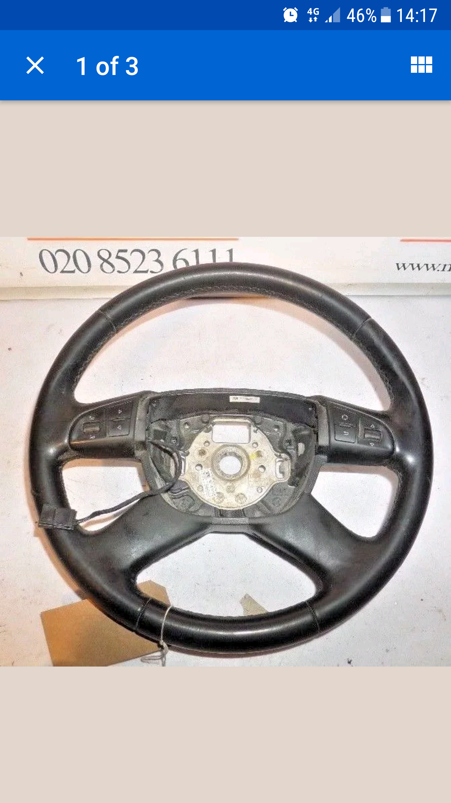

MFSW I bought from ebay. Apparently its from Skoda Octavia 2010.
I do not remember part number but I will post it once I will come back home
I was looking at this one

I replaced wiring loom and control module.  With help of a friend we managed to get steering wheel working. Only thing which is not working from steering wheel is trip computer scroll up/down button. I can change between 1 and 2trip by pressing scroll buttom but not to go through trip option. Trip computer works from stalk so its ok with me.

do you have a maxidot?
No I do not have it
2 hours ago, Adam1980 said:
No I do not have it
That is the reason why the scroll wheel doesn't work the trip computer.
