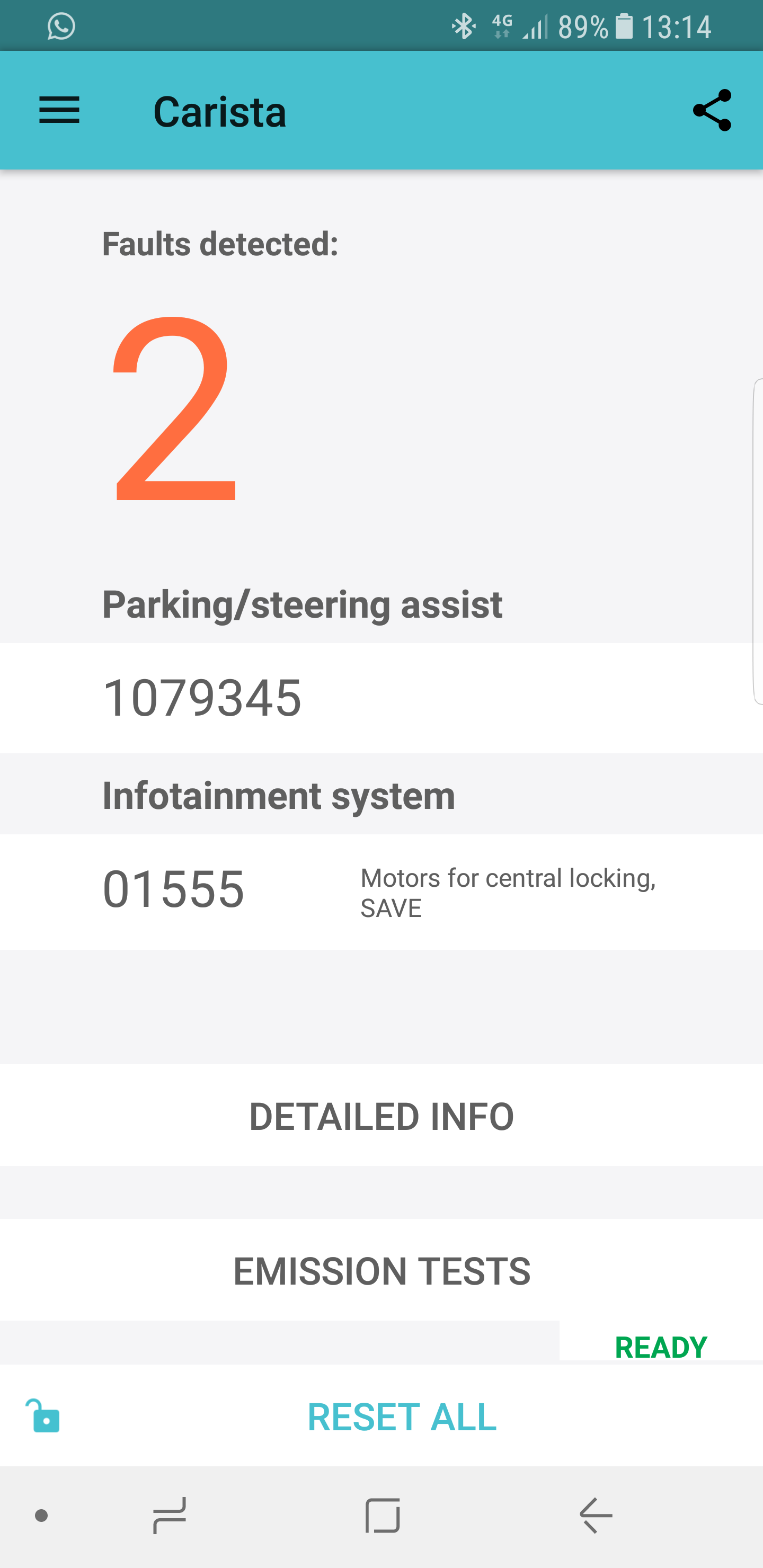

Hello all. Wondering if anyone has come across this issue. Yesterday when I put car into reverse instead of hearing the usual beep and image on screen for reversing proximity sensors I got a loud 3 second high pitch noise with nothing coming up on screen and seemed like sensors weren't working. Since then the system does this regularly even when it seems like sensors are working after a second the high pitch noise reappears and the proximity sensors on screen disappears. I did run diagnosis on carista and got a parking/steering assist fault with code 1079345, however when I searched on internet for this code nothing was returned.

Code is wrong length and  should start with a letter
Parking/steering assist
Part #: 5Q0919283B
Coding: 0001050011 (hex)
Component: PARKHILFE 4K
Fault codes:
1079345 Manufacturer-specific code
