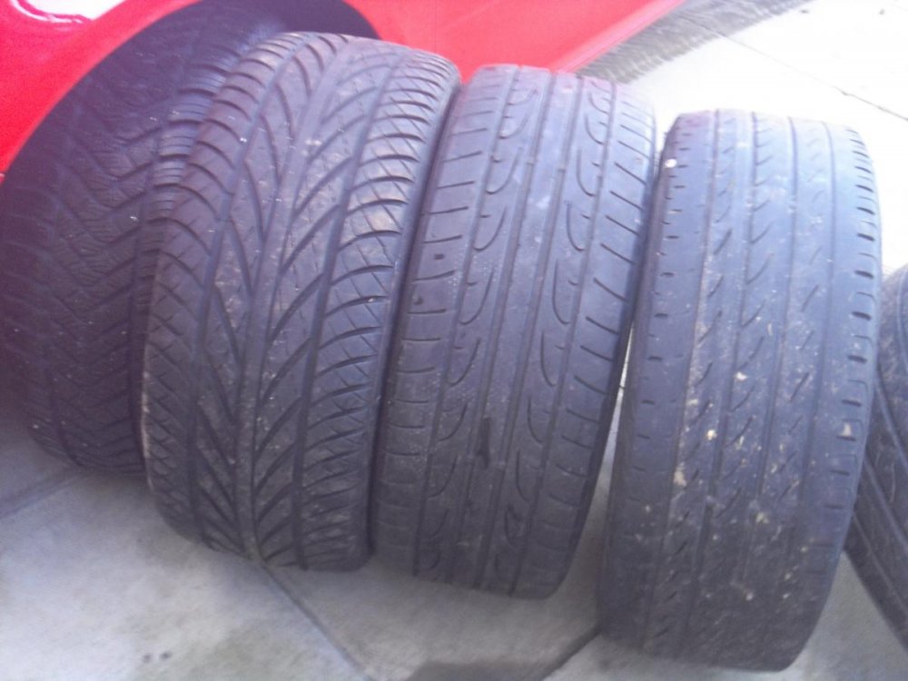

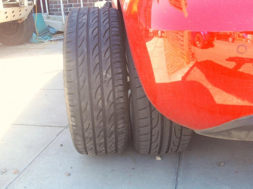

By taking a set i mean they deform a bit and get shaped, not just wear. (like a 'shampoo & set'... kind of thing, they get shaped.)
The rears of a vRS / Monte are sometimes easily seen as out of shape and pretty useless when on the front after a long time on the rear.
