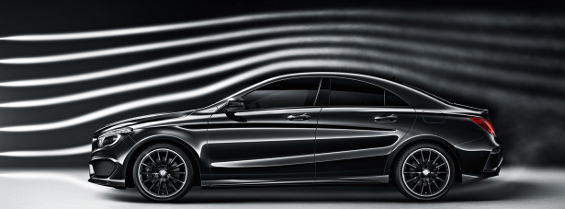

Base drag induces turbulence that recirculates the water/mud/spray.  A smother profile or a spoiler that would keep the flow laminar would help.
MercedesBenzCLA.jpgtech_pic_aero_fastback.jpgimages?q=tbn:ANd9GcQcfLxkk9qvwmd7YnrUaet
