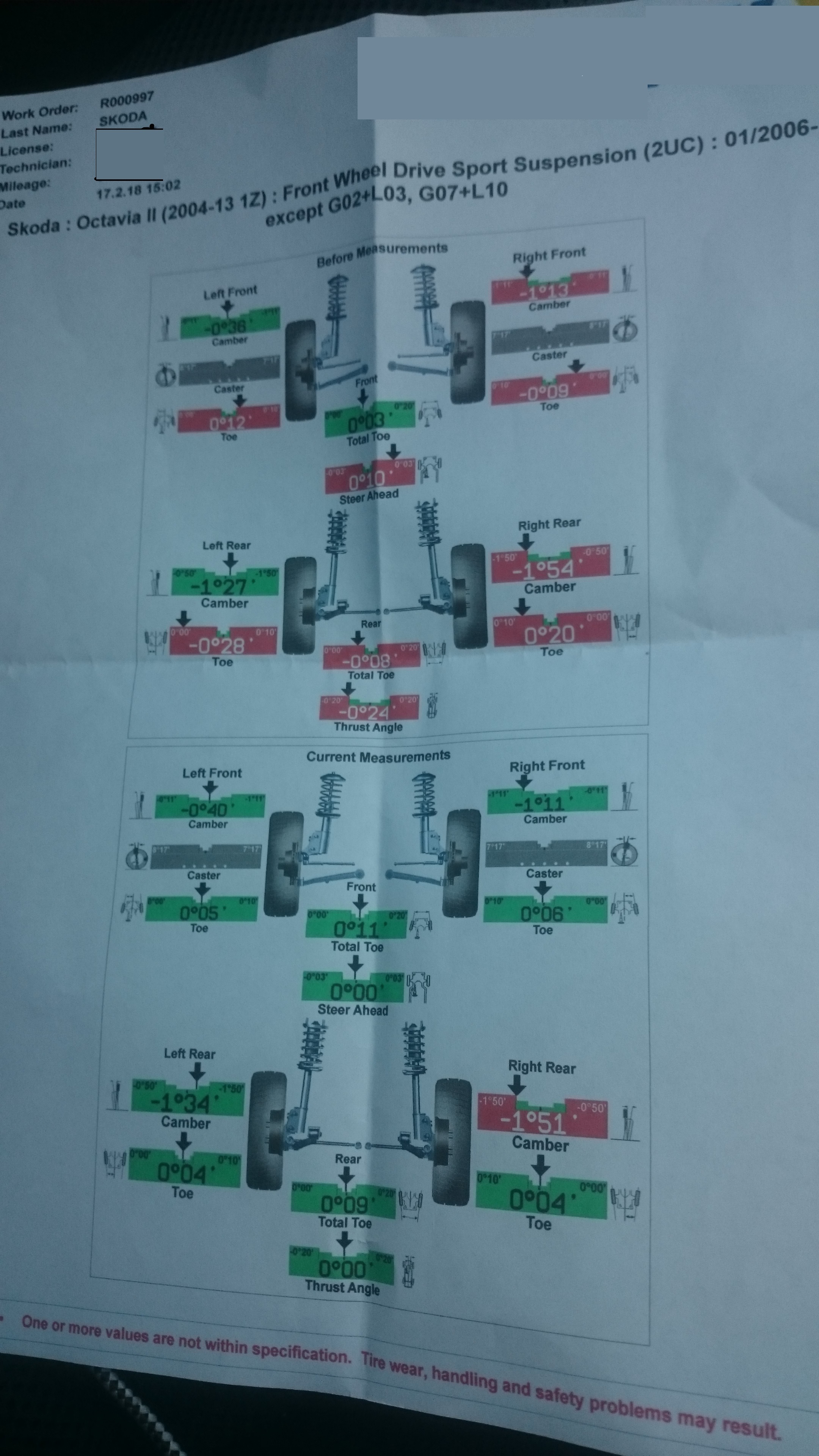

so as the title suggests got my springs on, all seems well.  took it for 4 wheel alignment originally seemed fine, now ive noticed the steering sits very slightly right and if i centre the wheel pulls to the left slightly.
can someone have a look at the alignment report and see if it looks ok, the bottom right they said the bush is slightly worn and if they tap the tyre it goes green so too small to adjust.

It looks pretty much the same as mine apart from caster and camber but I've got poly bushes and anti lift kit on it
That alignment is less than optimal.
At the front:
1) I'd be asking why they haven't taken a caster reading.  Caster will affect which way the vehicle drifts and is (slightly) adjustable on these vehicles.
2) They need to move the cross-member so that the cambers are equal or slightly more on the LHS. The extra -ve on the RHS will cause a LH drift.  NB: Moving the x-member also changes the caster slightly.  You need to have a think what you are doing.  Edit: If the struts have been out, they might steal a bit of adjustment by undoing the top mounts and using the bolt clearance to move the stut a fraction (every little bit helps).
3) Toe looks OK but I usually work in mm, so I'm just guessing.  I'd aim for 1-2mm total toe (in)
Rear:
RH camber is obviously wrong as it's red.  In reality, they are both "wrong" unless you drive around corners ridiculously fast.  Too much negative camber and you'll get saw-toothing on the inner edge.  Aim for somewhere between -1.0 to -1.25.
Toe is probably OK.  Again, I'd go conservative and aim for total toe of around 0-2mm (in).  0 (parallel) might feel a bit loose to some people...
The steering wheel off centre should fix itself when the drift is sorted.
Ask if they've ever adjusted the front camber using the subframe.  If they haven't, I'd ask for a refund and go somewhere that knows what they are doing.

He printed and adjusted the car right in front of me. I did mentioned that the car is lowered with new top mounts, shocks, springs, as well as fully polybushed up front with anti lift kit which does increase caster. Subframe aligment is not possible since I've used collar kit from Tyrolsport. Lastly I did notice saw tooth wear on the rear tyres which had done less than 2000 miles and I didn't notice any marks on them before.
Rear:

Of course they can check Caster on a Hawkeye.  He hasn't done it because he was doing a freebie.
I said I would set total toe-in at rear conservatively.  Off the top of my head the specs are 0-4mm  and closer to parallel rolls a bit better.  When you have the wheels dead parallel (0mm) the back end can tend to wander a bit (feel loose).  I doubt the alignment is causing the 5mm of slop in the steering.  You possibly didn't notice it before & the other changes have highlighted it.

caster will be around 7'40".  They should be equal or a fraction more on the left. (to account for road camber)
camber should be equal or a fraction more on the left.  On your car it will be about -0.75  once they shift things about.  (-.40 - 1.11=-1.5 / 2 = 0-0.75)
toe in 1-2mm
rear camber should be equal and 1degree 20 minutes +- 30mins and I'd get as upright as possible (50m-1degree)
rear  toe 1-2mm in
