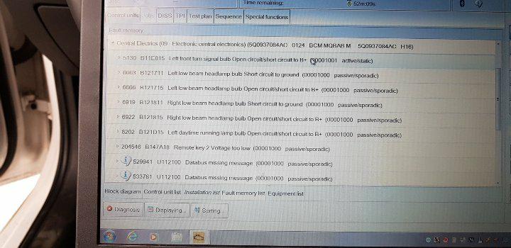

Hi,i had it done with ODIS i have it at work!it says something about open circuit/short circuit to B+!
I have some pics,im not shure of u can see proaperly!
