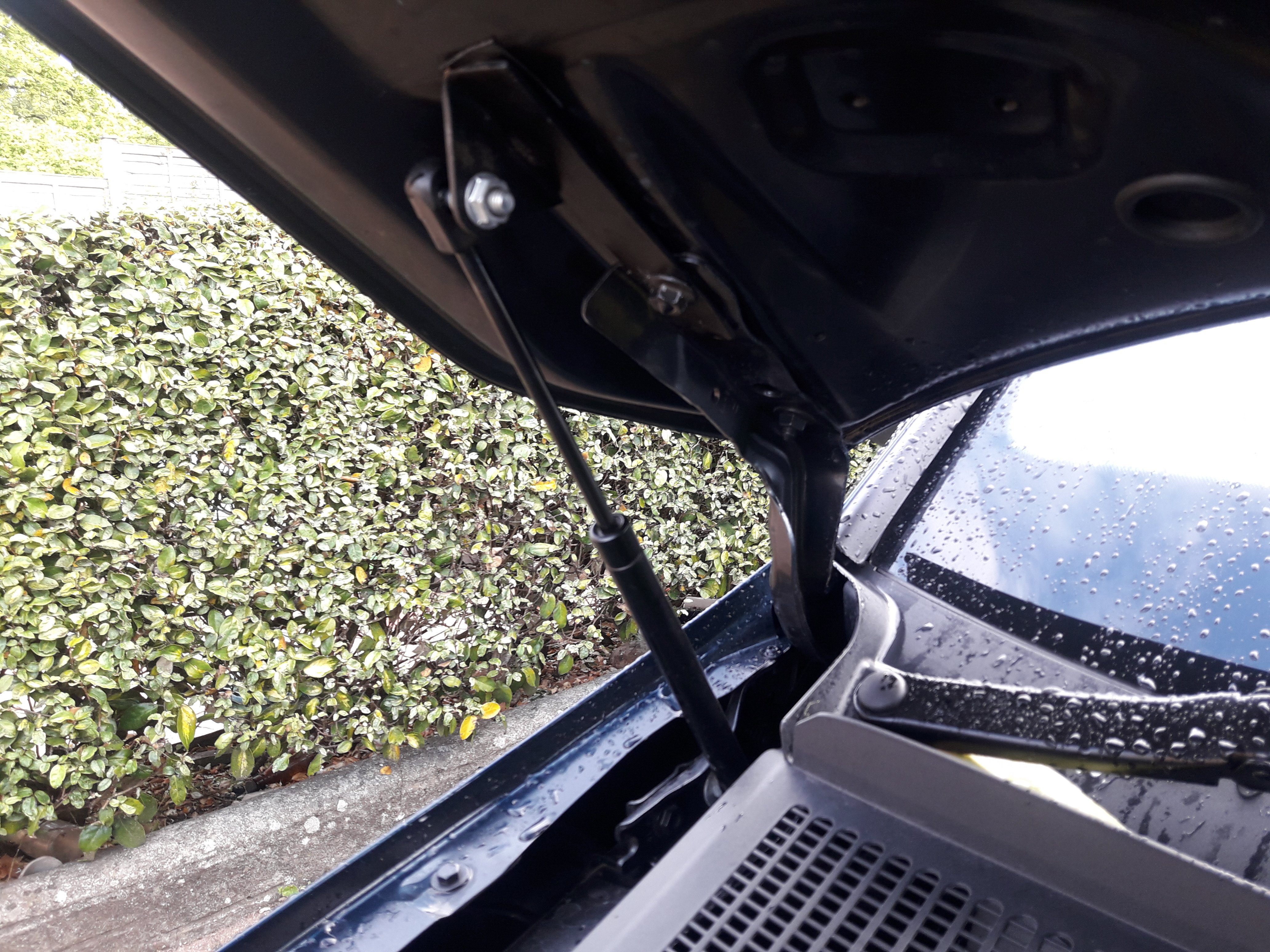

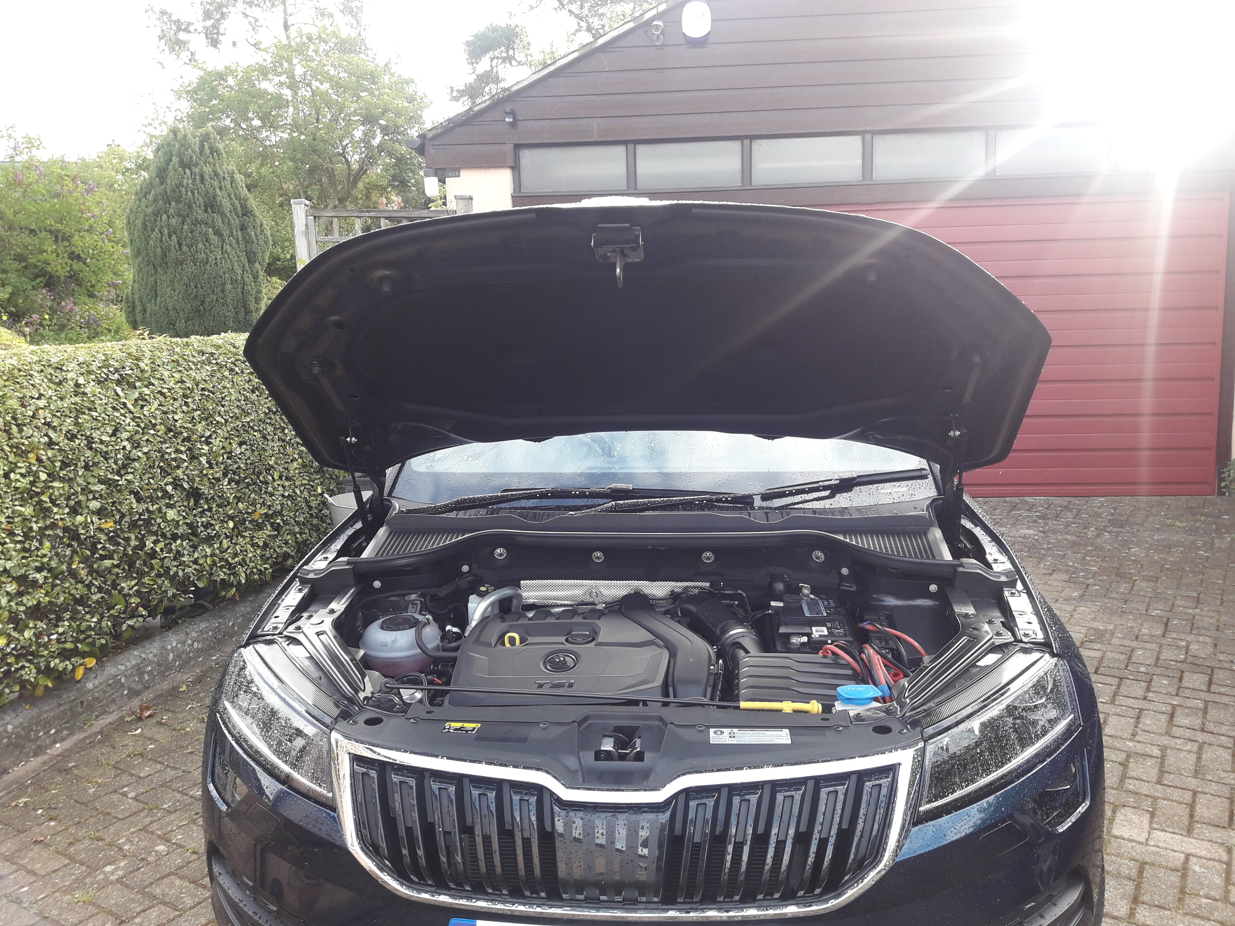

I fitted these to mine, after ordering them while I was waiting for my Karoq to me delivered.
They do not lift quite as high as the standard prop but work well.
I did put a small piece of rubber under the front of the brackets that rest on the bonnet strengthening metalwork.
They make filling the washer tank and checking levels very easy as the bonnet is quite heavy.

I forgot to mention on my last post that the brackets had slightly sharp edges so I filed them off and gave them a bit of paint.
Close up.

No butchering involved when I fitted them to my karoq.
It only involves undoing one nut and fitting the bracket which admittedly I had smoothed the edges of and touched up with paint and then slipped a small piece of rubber under so end of bracket is not resting directly on the bonnet.
The bottom gas strut mounting hole is already there so wonder if gas struts are standard fit in some countries ? or if skoda just put them there in case they change  the spec at a future date and don't have to re tool..
Not a must have feature butI thought not a lot of money to spend on a simple mod and only takes 5 minutes  each side to fit.
