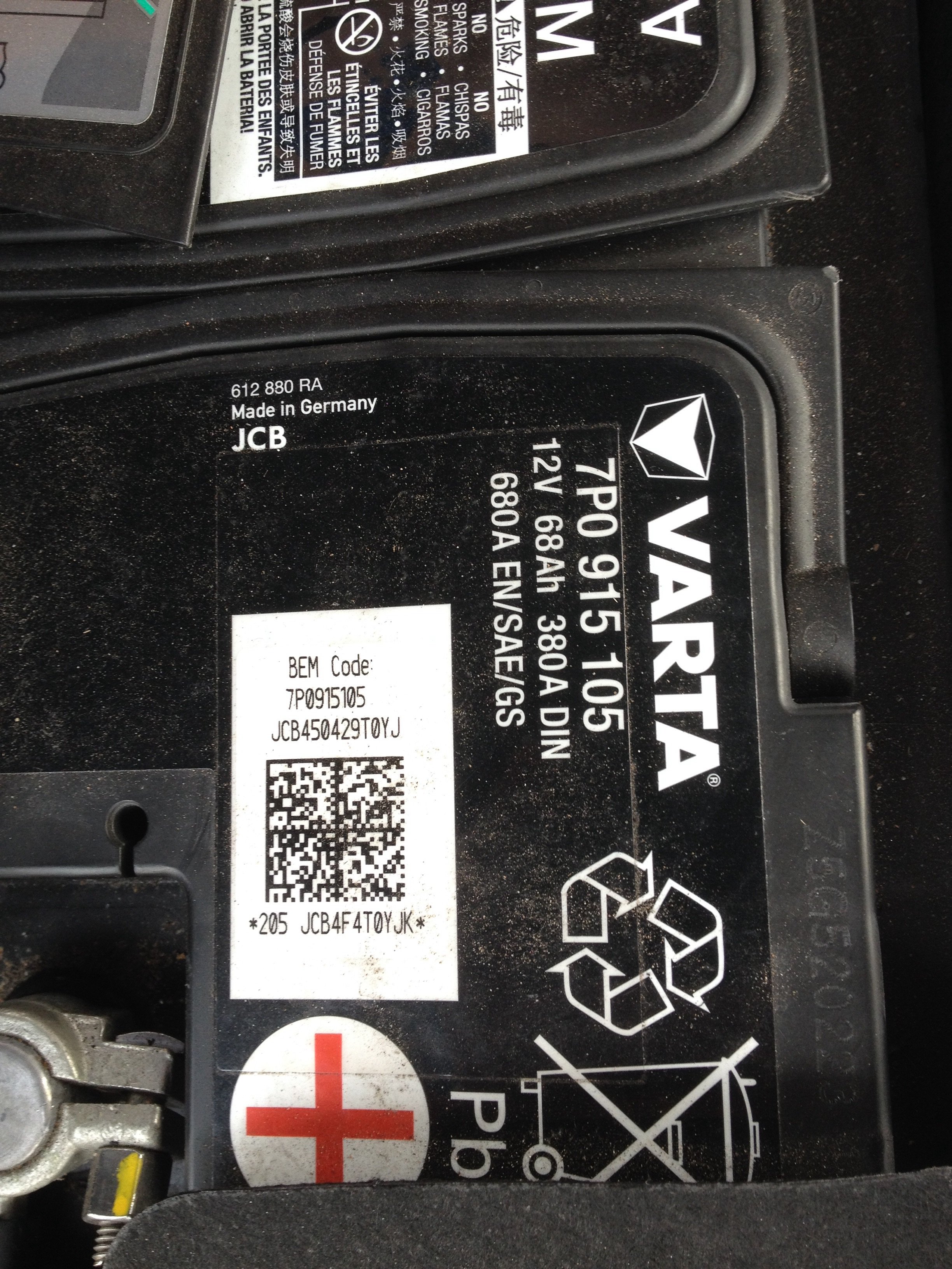

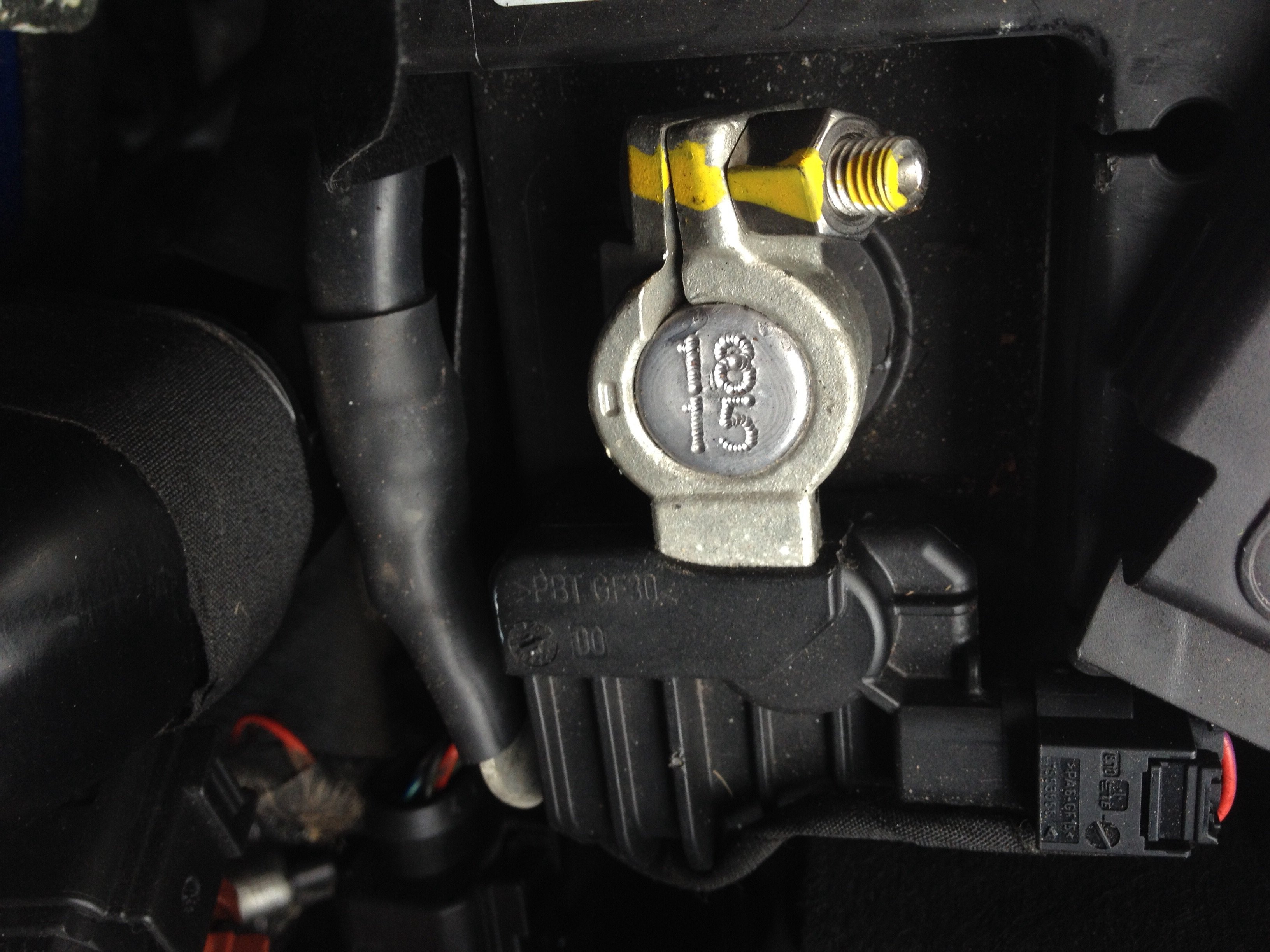

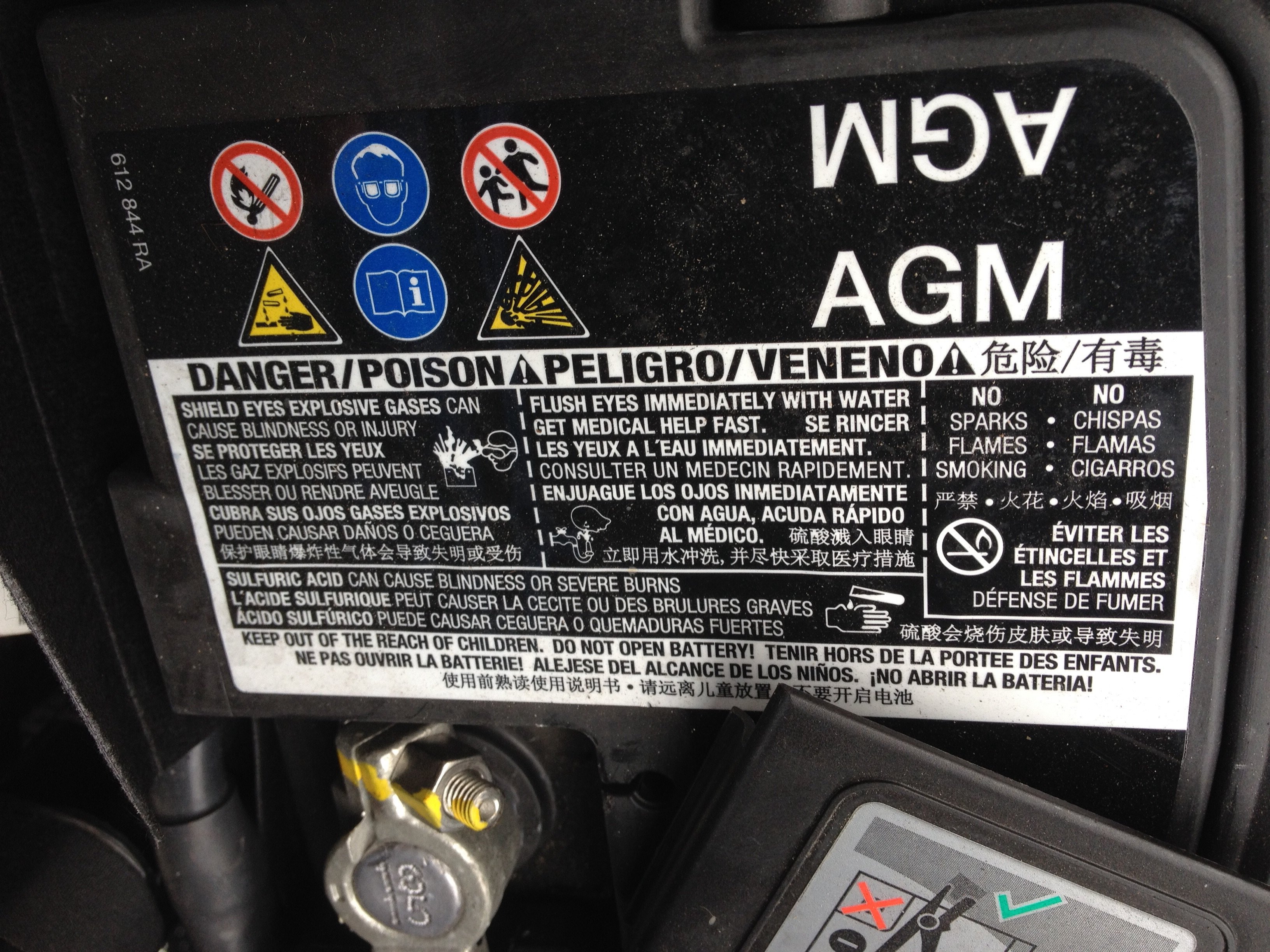

just had a look at the battery and my son took a couple of pictures of it. He also scanned a bar code shich translated as "205# 7P0 915 105      #0683801  #332486349#29041518*205 JCB4F4T0YJK*=". I've no idea what this means but maybe somebody on this forum does! Here are the pictures my son took.....

If a Varta battery was fitted, it will have a date code on the negative post week/year. Get the date and see how old it is relative to the car. Batteries fitted in production predate the vehicle by no more than 5 weeks. A newer battery will have a newer more recent code.
Q So thats week 18 year 15 then which almost matches your cars manufacture date.
And as the yellow paint marks on the terminal  all look in line I would say it's original and never been touched
Just spoken to the sales bloke at Meadens and emailed him the photos. He blamed the service dept and said he would tear them off a strip. Hopefully it was a genuine mistake as I don't like conflict and told him that, if he sorted it out as a mattet of urgency and gets a genuine new fully-charged battery fitted that would be the end of the matter! Awaiting a phone call now for it to be picked up and sorted. Here is another photo...

Nice result!  The 2D snowflake has part number and manufacturing details and dates so that it can be scanned prior to installation in plant as a check to ensure it’s the right one for the vehicle spec and within the age limit for fitment.  The yellow marking is a check mark to show the fixing has been correctly torqued and highlights tampering after assembly. Most major fixing around the vehicle are painted for the same reason. There’s a date of 29/04/15 wk 18 in that 2D code. Car production date prob in May/early June.
