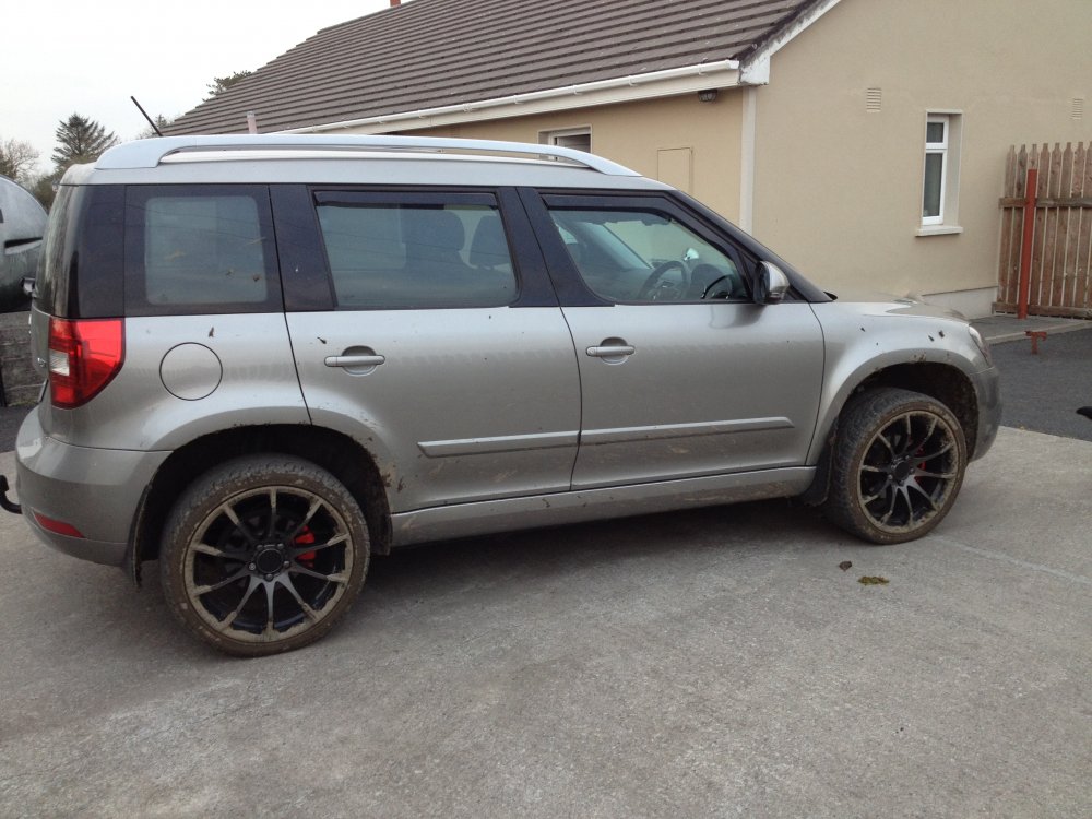

Not a fan of the low profile tyres though :wondering:
Ya they do take a little of the comfort away, but the still manage to do the job of keeping it up in the sand . Mind u the have been in the mud too...:biggrin:
