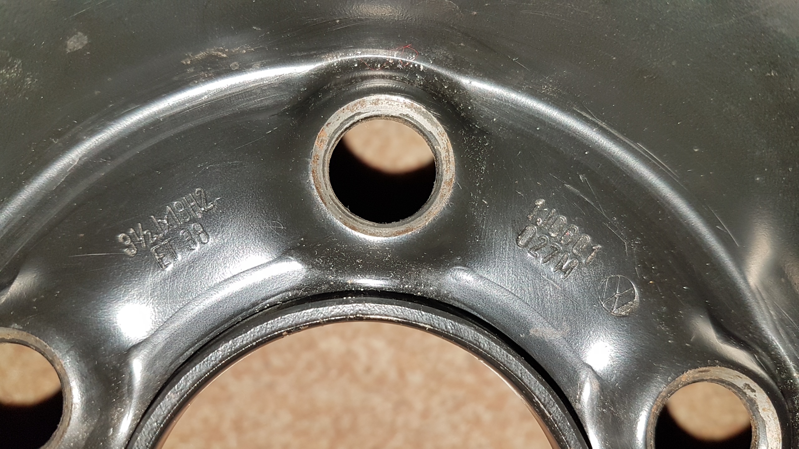

I bought a spacesaver with this part number off eBay. It DID NOT fit my Mk3 2015 VRS. The PCD on the spacesaver is too narrow (the wheel has 5x100 where as the Vrs has 5x112) and it did not fit around the caliper.
I bought a full size Gemini alloy which I know will fit.
