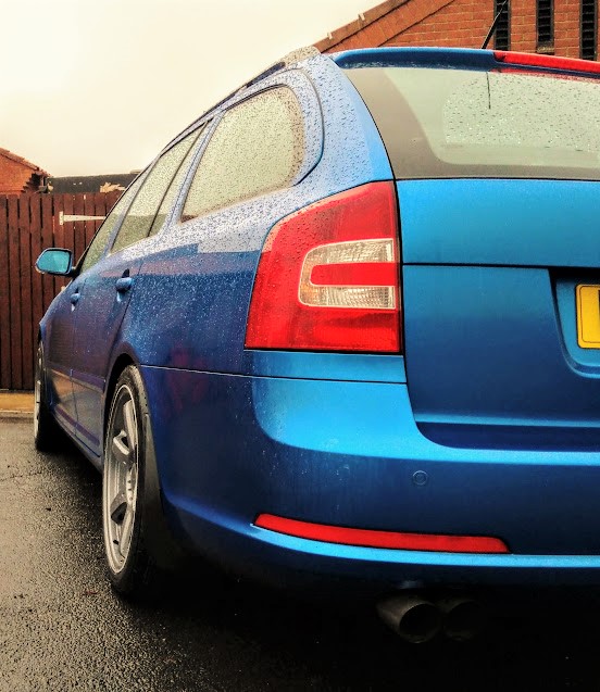

I've just put some summer rims on the car.  They are 8x18" with an offset of 42 and have the standard 225 40 18" tyre.  I've gone for Uniroyal Rainsport 3 as I like them but I'm aware that everyone has their personal preference.  They fill the arches nicely and don't need spacers due to the offset.  I reckon they'll rub a bit when fully loaded and all five of us in the car as last year the 45 offset on my other wheels did catch ever so slightly.
The photo was taken in a rush today in failing light in the rain so it's not the best.  I'll post some more if/when I get a chance to clean the car.
