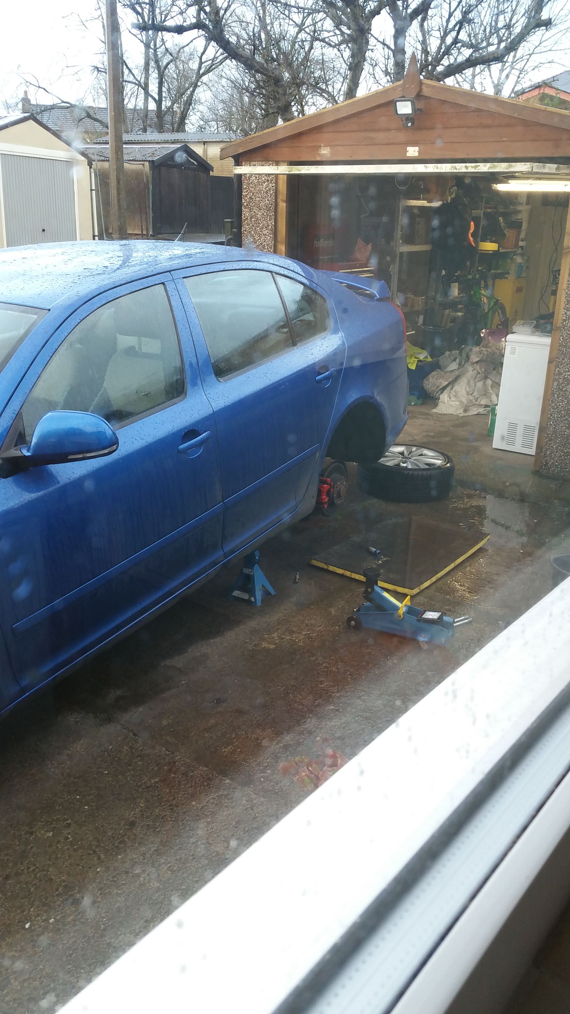

On the rear I have put stands underneath, but can't quite remember where exactly, here is a picture I have:

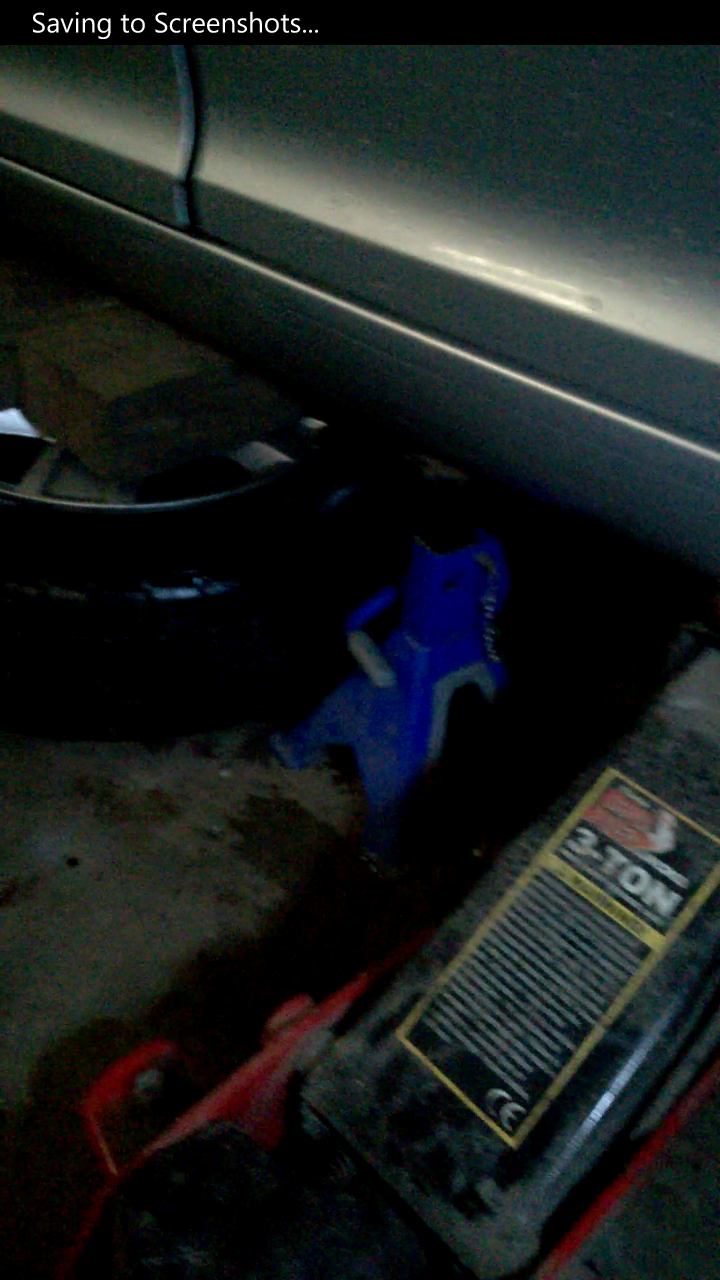

This is a screenshot of my video.
The actual jack is on the sill jack stand(you'll see the arrow pointing to the jack point if you open the door) my jack stand is 8 "inches towards front of the jack annnnd my tyre with cholks/wedges is about another 8" wp_ss_20180320_0008.thumb.png.0a42152dddfcc457b418b02de0ebc456.png towards the front of my jack stand.. Now work away and be safe :)
