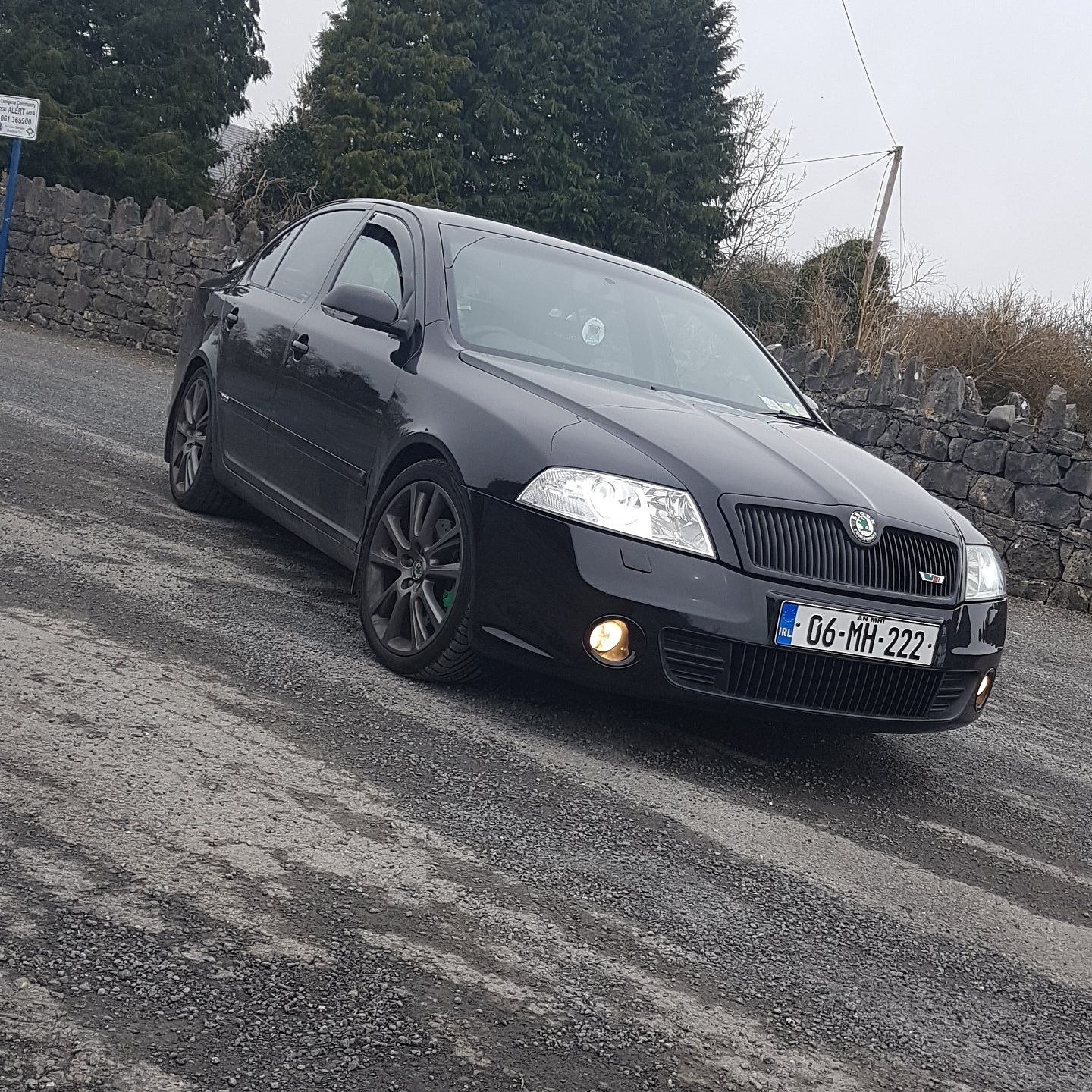

Driving home from work today in my petrol mk2 vrs octavia.. went to overtake on the motorway and as i accelerated the car started to jump and miss almost like the car was running out of petrol..the car was low on petrol (30 miles left) the engine management light flashed on and off a couple of times and stopped..the car returned to normal.. i stopped and filled up with petrol and continued my journey home now its intermittent it drives fine then a slight miss then fine then a miss again...  Any help appriciated please..
