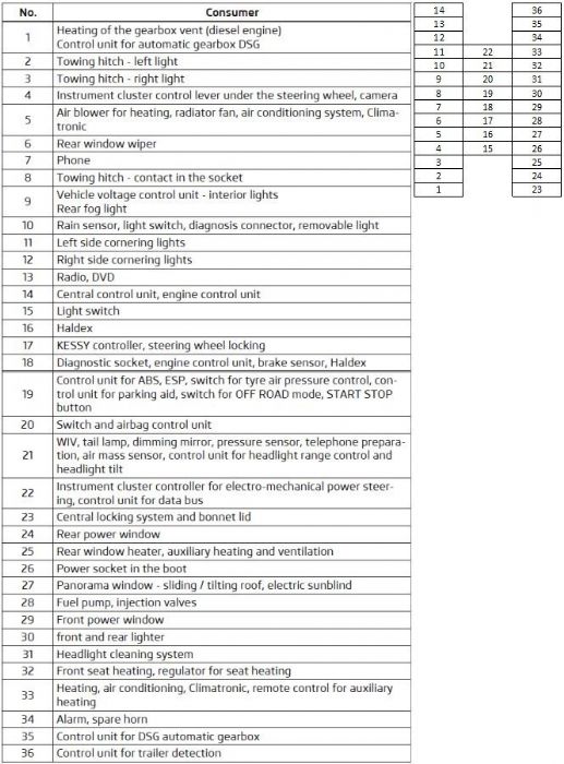

There are plenty of fuse diagrams on the web (example with 3 types here)
http://www.autogenius.info/skoda-yeti-2010-fuse-box-diagram/

Seat heating fuse is no 32, 5th fuse down on the right on A post drivers side.

What rating is this fuse? If the light comes on the switch I presume the fuse is ok?

If you bothered to look at the earlier posts on your question you would see that SurreyJohn posted a diagram that says the fuse rating is 20a. and I posted what fuse covers it.

How did you know what I did after looking at Surreyjohn post?  I did look in fact, but was a bit baffled as the layout did not appear to match the layout in my vehicle, also I could not see a number 32 fuse to check.
Did you not see my post on the location of the fuse?
"" Seat heating fuse is no 32, 5th fuse down on the right on A post drivers side. ""
SurreyJohns post shows it to to be 20A.
The fuse box layout is not easy to work out at first sight because it is basically upside down on Right Hand drive cars. You therefore have to be very careful in identifying which fuse covers what function. If you look at posts relating to hardwiring a dash cam there is a very good image of the fuse box which makes everything clearer - or at least it did to me!! It is possible that both base units stopped working at the same time but it is unlikely so the first thing I would do is change the seat heater fuse, easy and inexpensive to do and nothing lost if it doesn't work.

I have posted this before.
The correct orientation of the fuse box.
That's the one - thanks Urrell.
