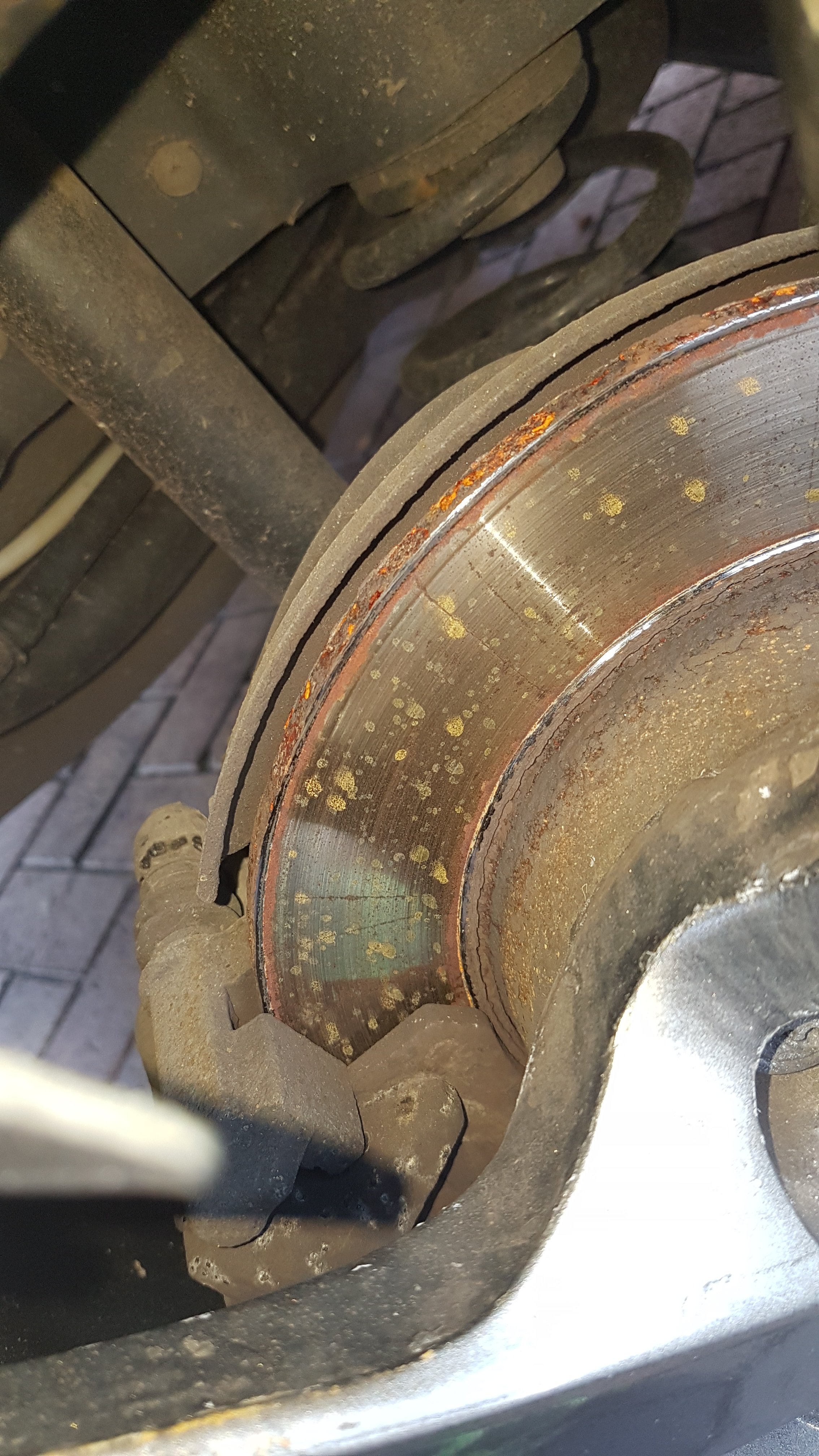

Hi I'm just after a bit of info I've done brakes on other cars but never on a automatic as all brakes need changing ....i presume it's like all other cars but has to be put in neutral with hand brake off ( off course ) but being auto it should release rear brakes and change as normal .....im I right

Skoda rapid 2013, 77k miles auto
Discs and pads needs changing and have got a wind back piston tool

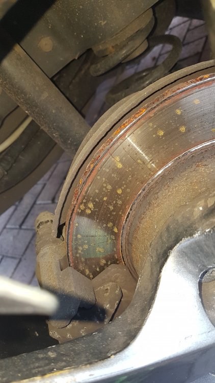

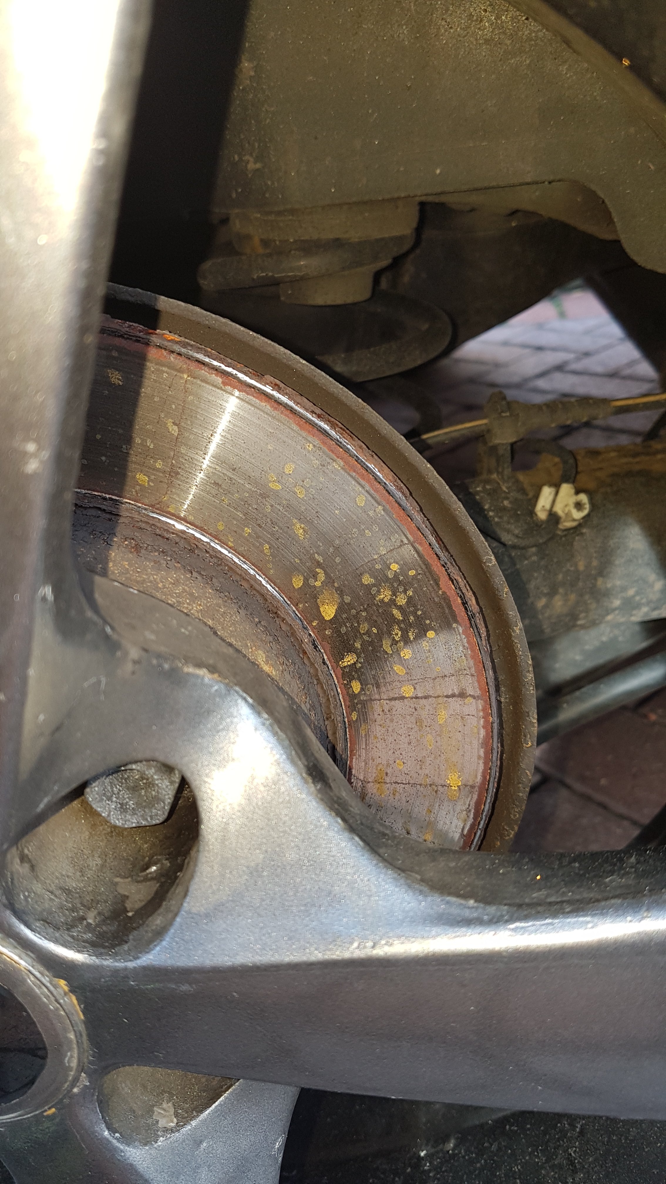

I thought if you put it in p (park) the brakes won't release the disc and off course safety as always and I wasn't thinking about it it's just the discs are crazing and pads are right down ad pics
Park on an automatic or DSG sets the gearbox in park, does not work in conjuction with the brakes as the 2 are seperate system on most vehicle's, change the brake pads and discs in the same way as a vehicle with a manual gearbox.
