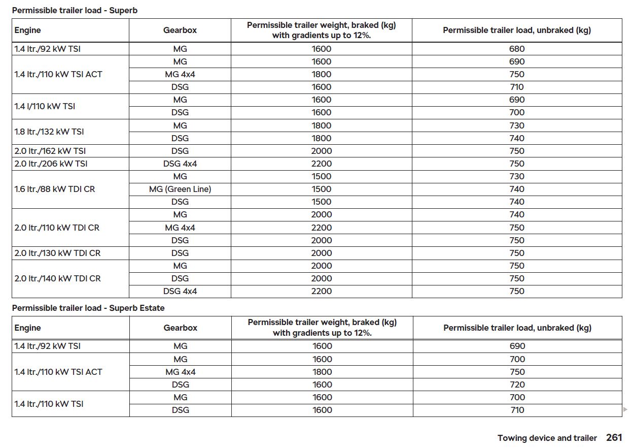

Just wondering if anyone uses the petrol 1.4 TSI 150 DSG for towing light trailers, The heaviest trailer I will tow is a max 300kg all up sailing dinghy with a nose weight of around 10kg. How does the 1.4 cope?
It's in the manual

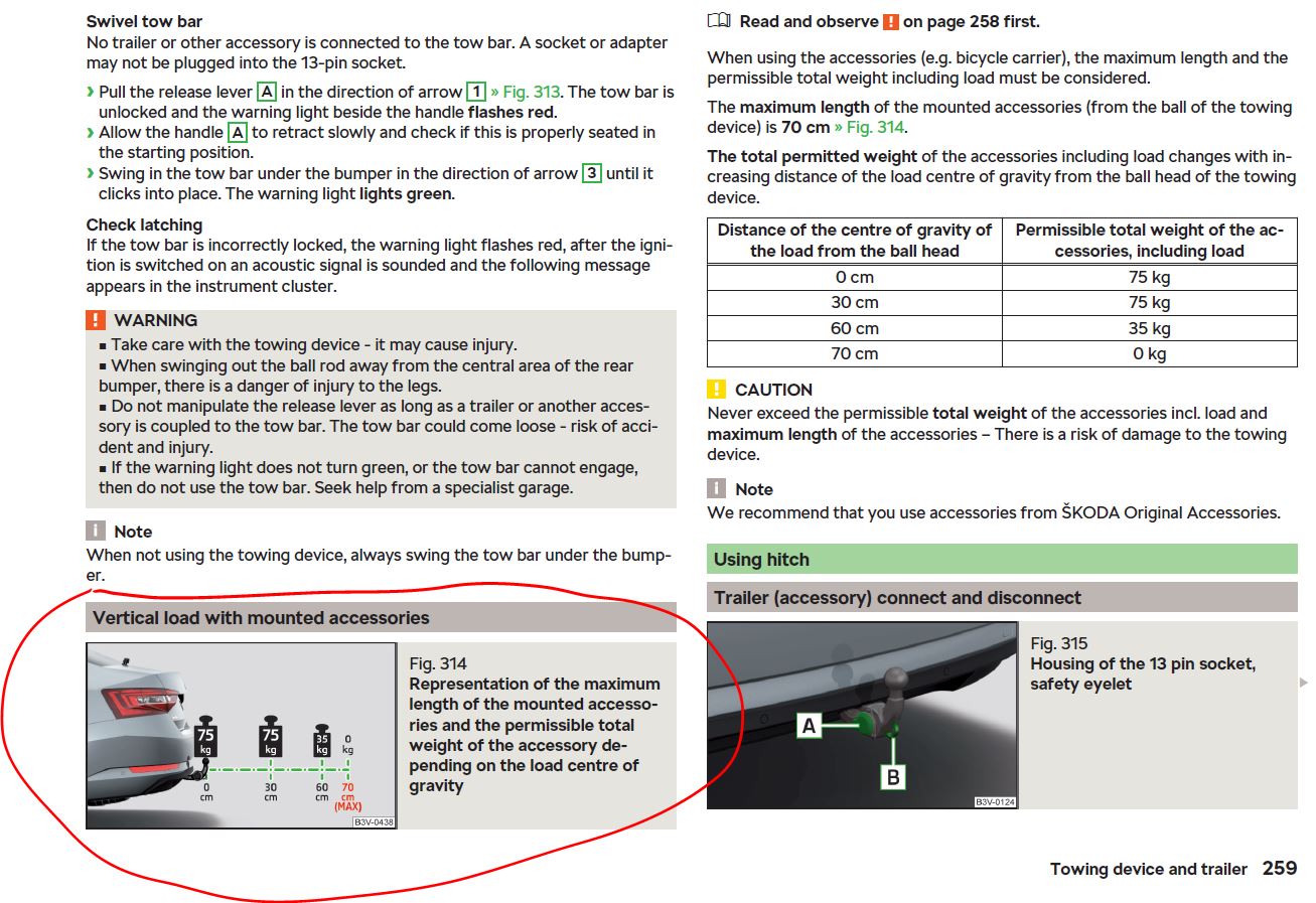

The above pic is for the likes of tow mounted bike racks ..
