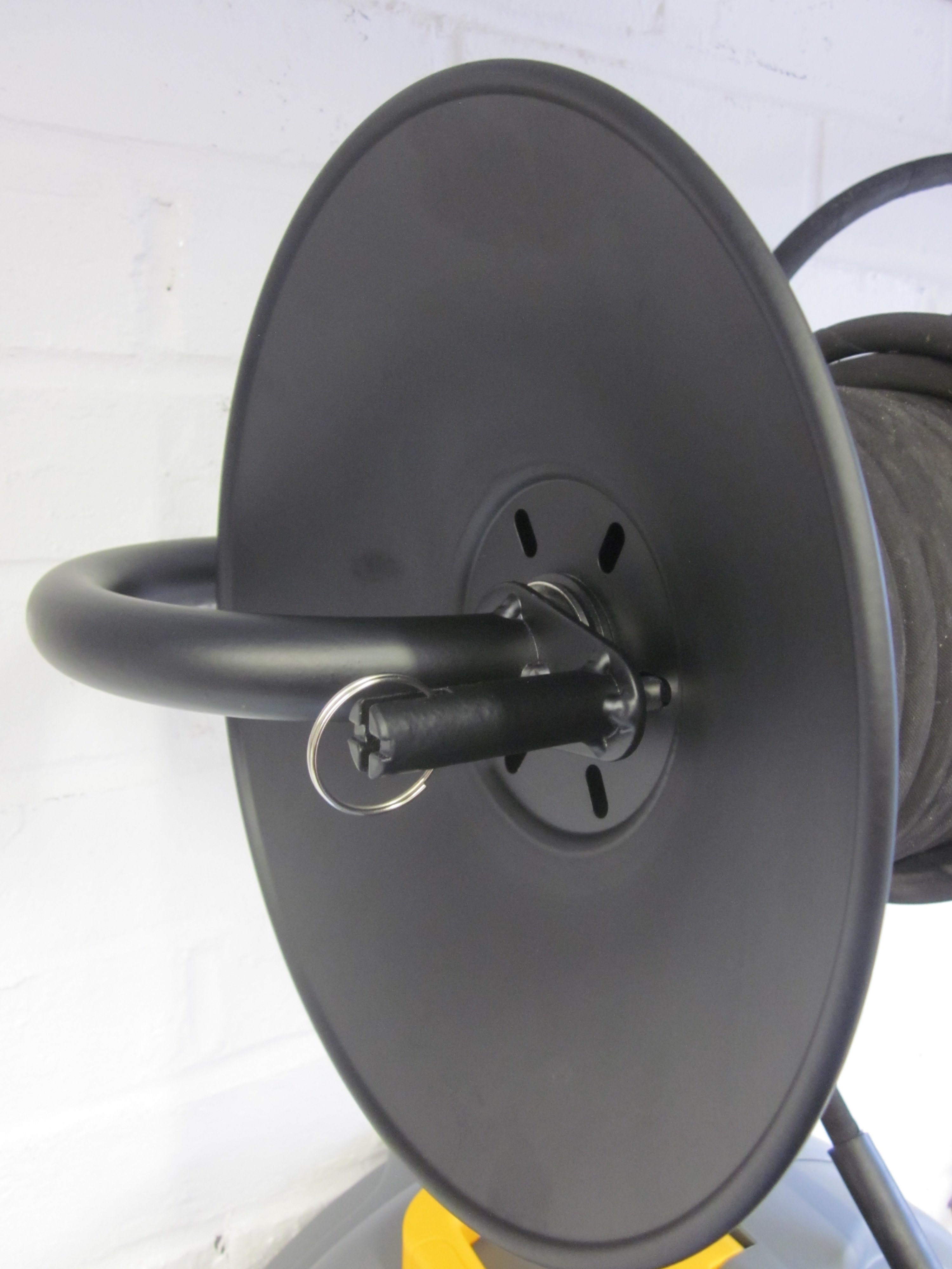

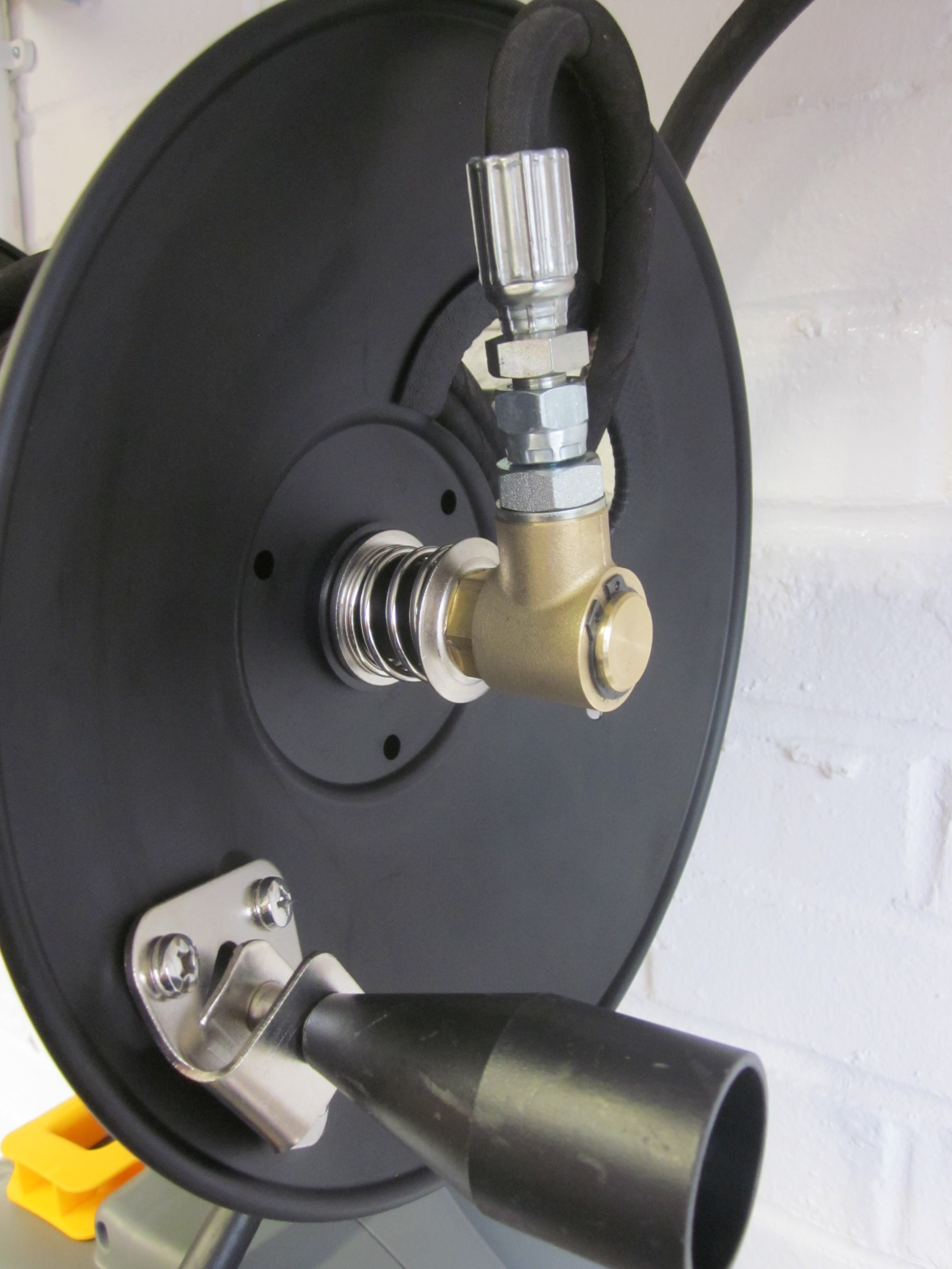

Picked it up. The guys have crimped all the hoses on for me, ready to fit now!

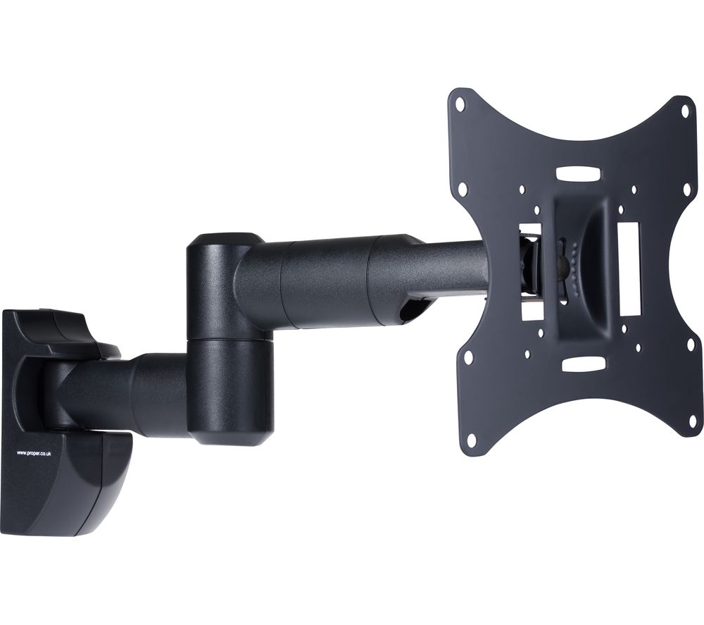

I'm thinking about buying a telescopic TV bracket so that the hose reel can pivot out away from the wall slightly to ensure the hose doesn't snag on the other bit and bobs I've mounted on the wall...
Should be durable enough!
Nice idea on the lateral thinking with the TV bracket!

It's a good idea but I'm not convinced about the durability though. The TV just sits there once it's mounted and moves rarely. Your hose reel may be subjected to lot more and different forces. Just a thought. :)
Good point, I think like a lot of things in life quality can vary, hopefully I can find a high quality TV bracket, I'll have to do some exploring. I'll also need to find one that has a mounting plate that'll support the hose reel base plate.
I know the ones we have here in our works office are moved / adjusted daily and seem pretty durable.
Time for some internet research :D

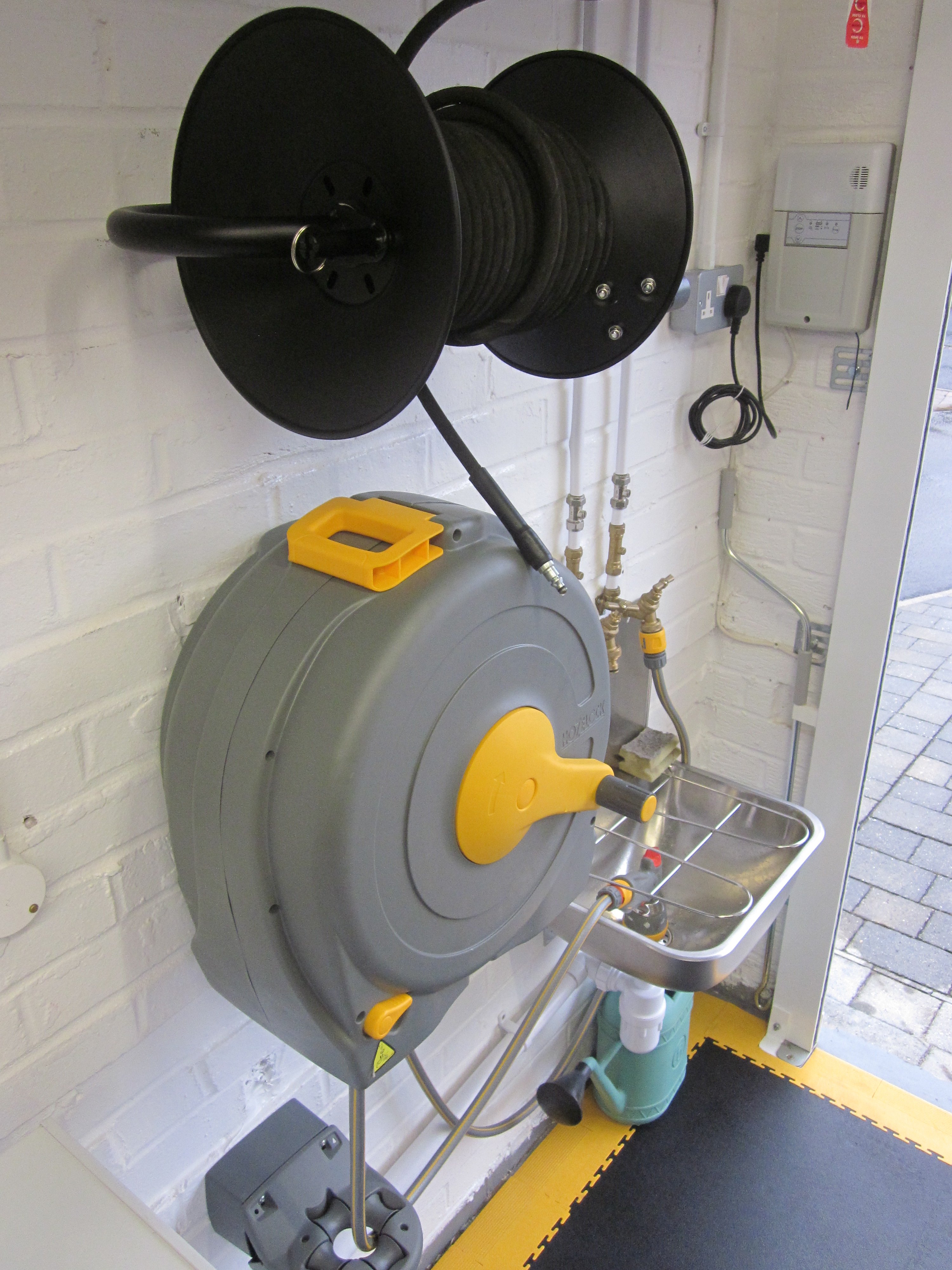

My plan is to mount the pressure washer up the wall from where it is propped now, the reel will then bolt to the wall just above the Hozelock hose pipe reel...

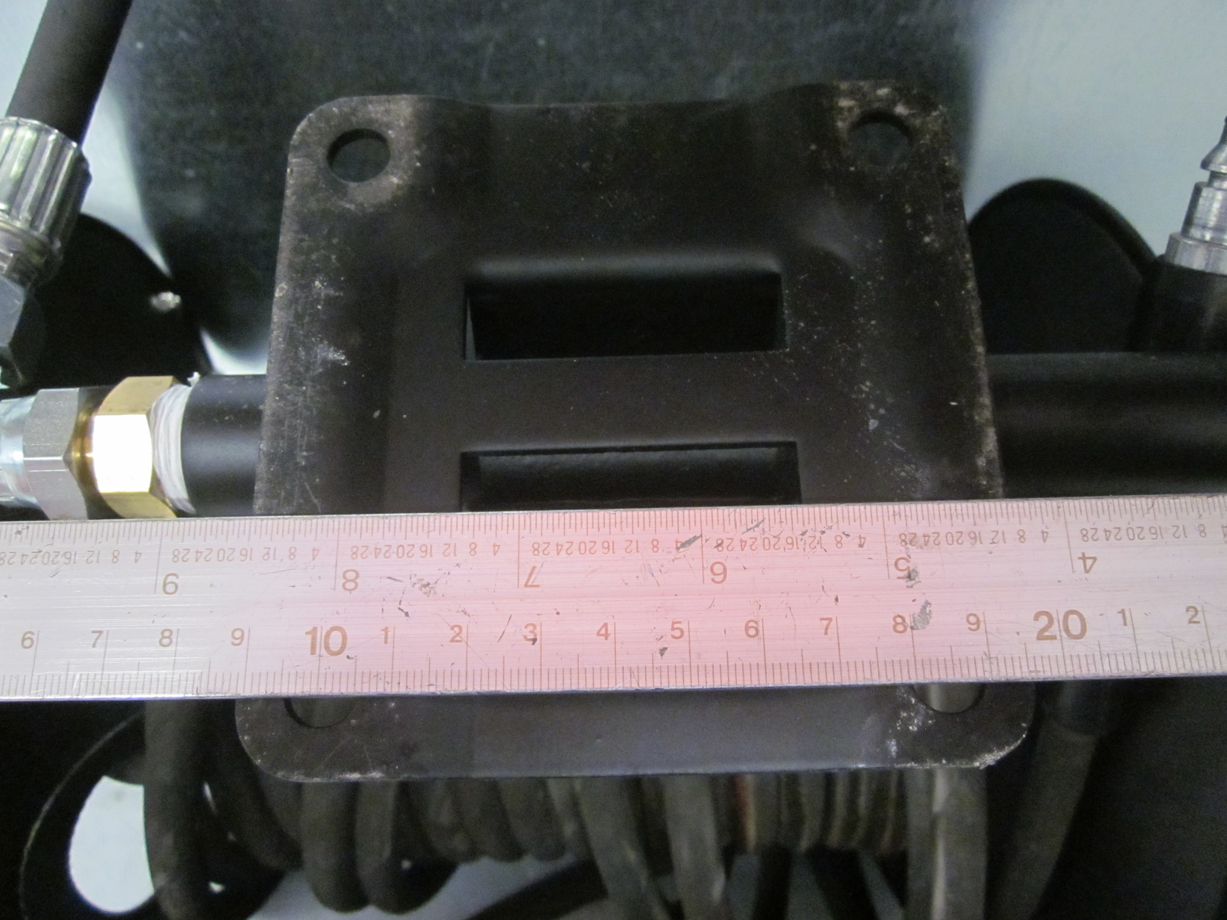

The question is do I pursue the TV bracket proposal. I've just measure the holes on the reels foot, they're 8.5cm apart...
Edited by silver1011

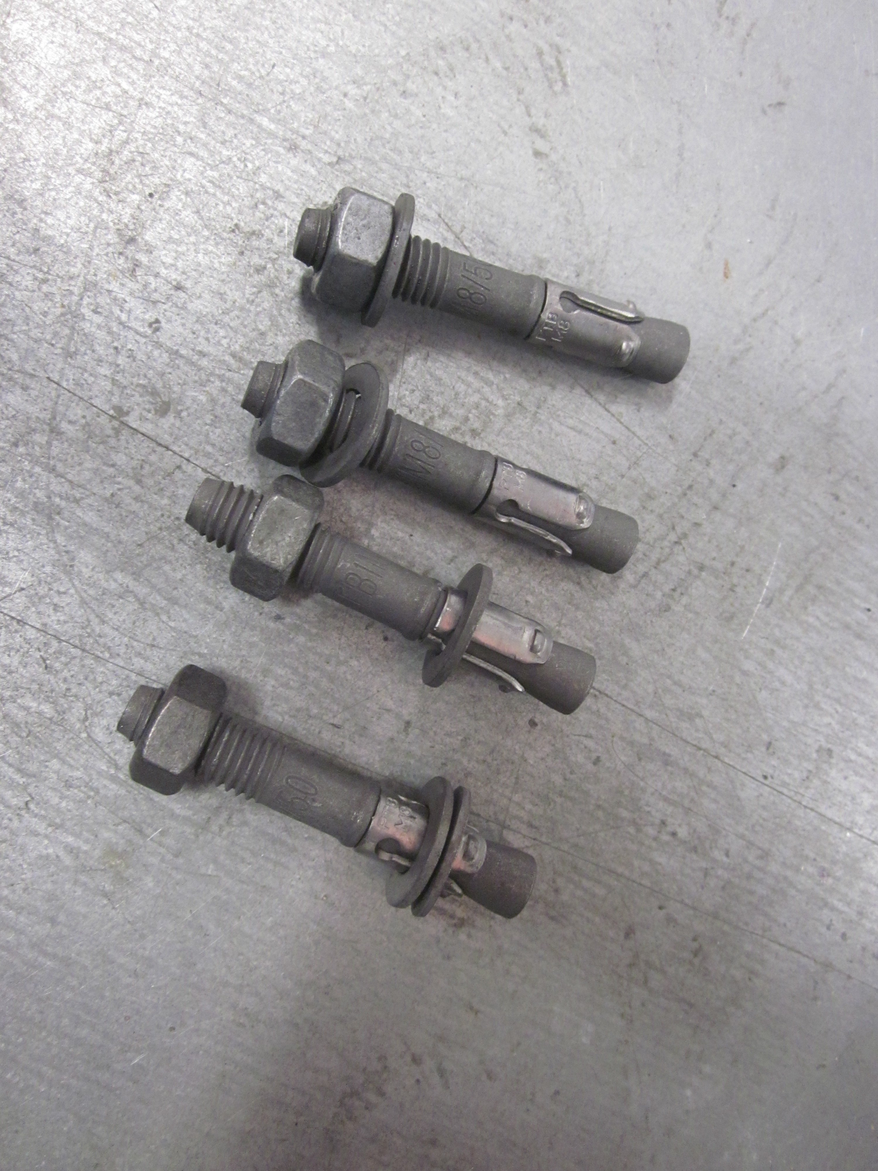

Picked up some sturdy sleeve anchors ready to mount the reel...
I wouldn't bother with the TV bracket, I don't think its up to the job at all
I think you might be right, there don't appear to be any TV brackets with a VESA measurement of 85mm x 85mm either so it would need modifying. More hassle than it's worth.

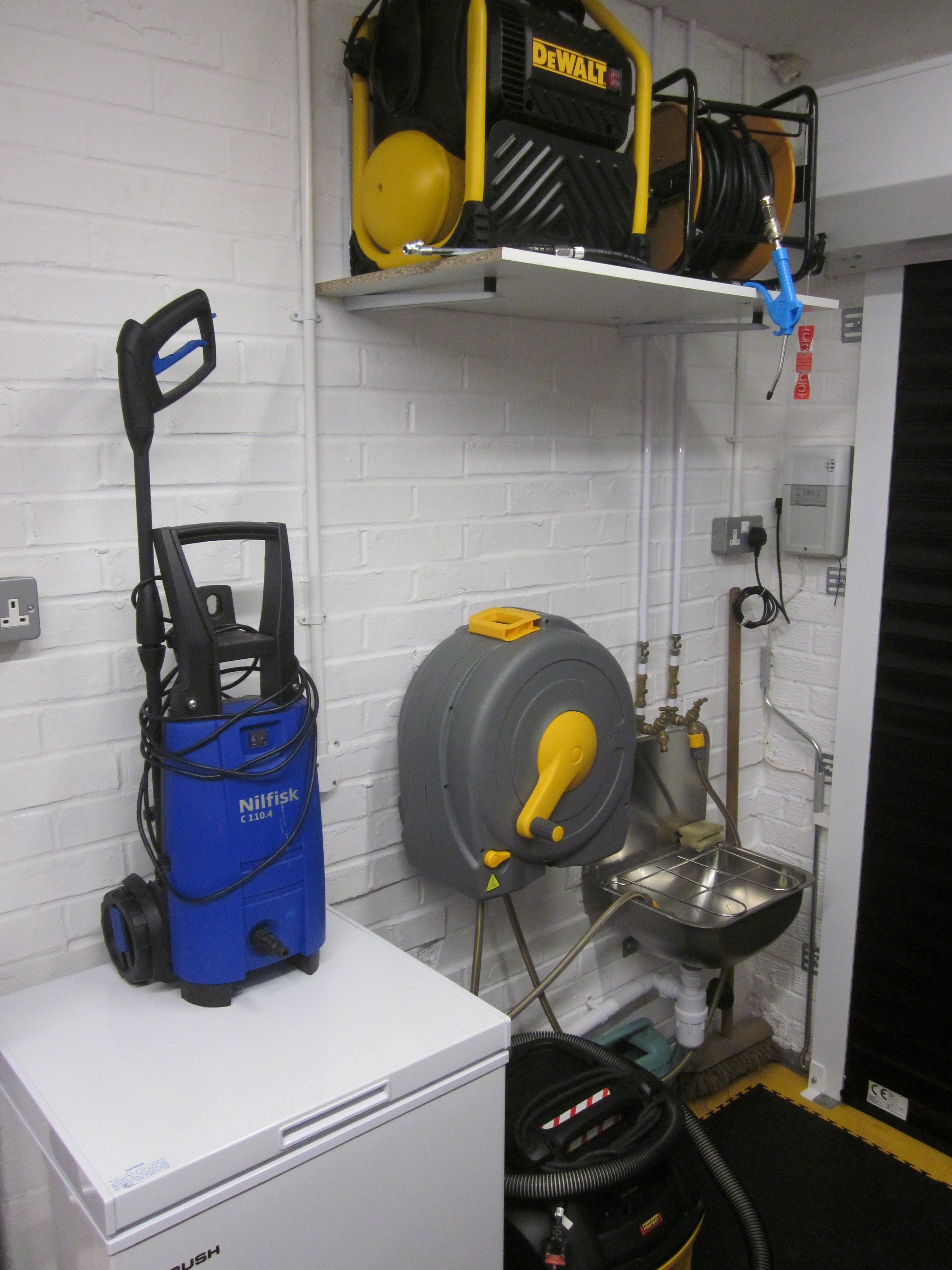

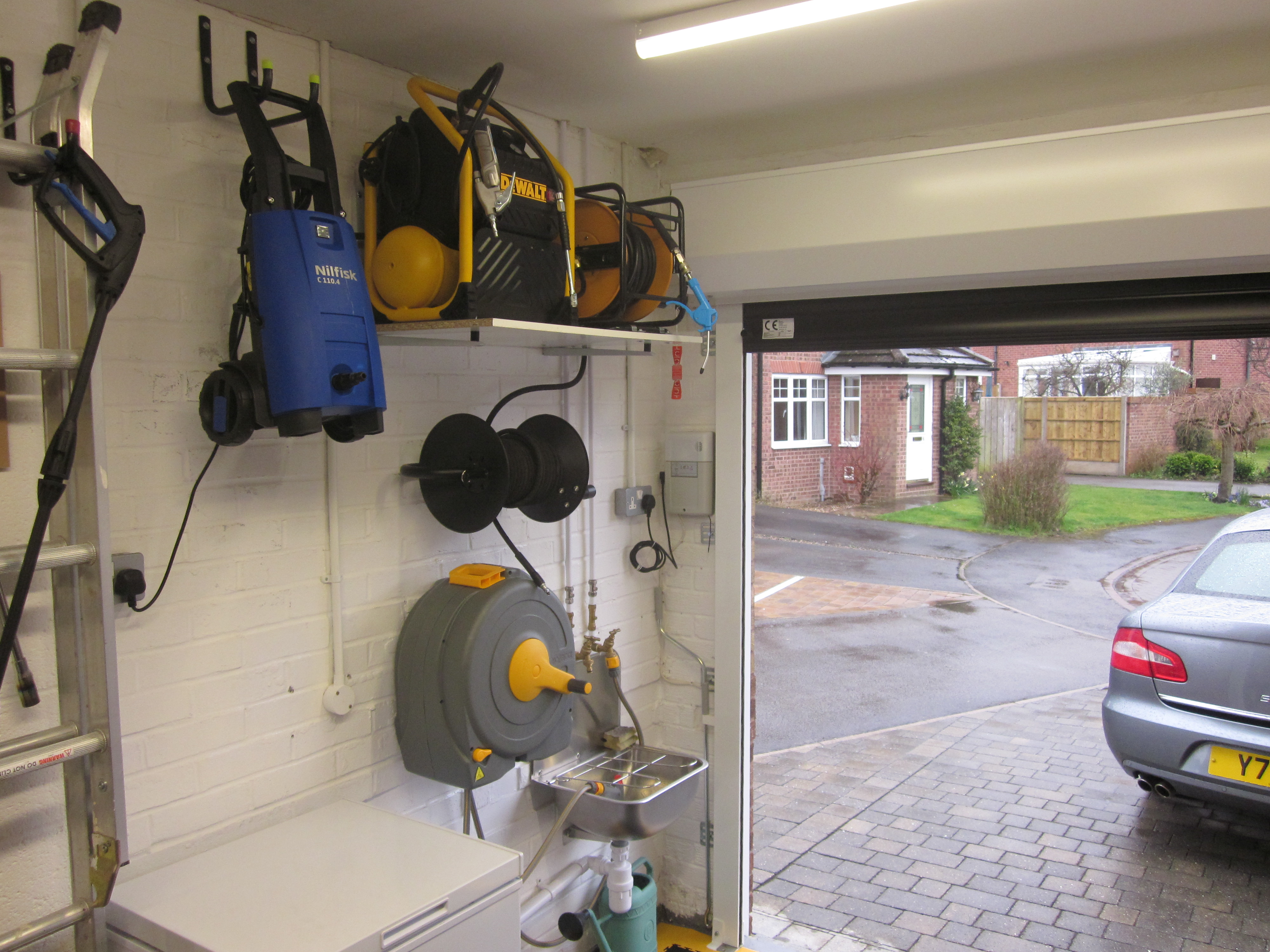

All fitted...
