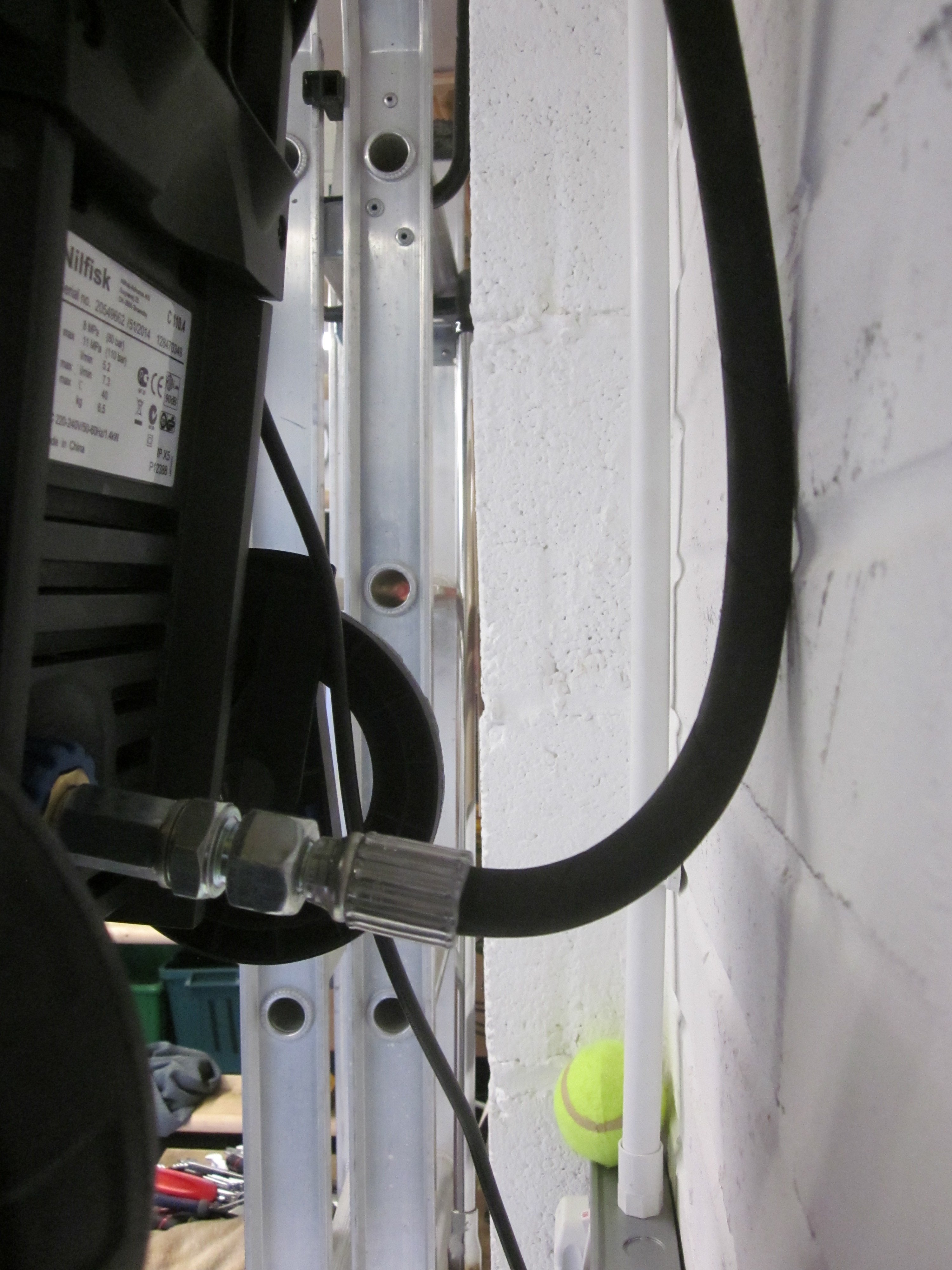

That looks really nice, It might be an idea later on to see if you could source a 90 degree adaptor to fit onto the pressure washer to try to take some of the tension off of the high pressure line.
I have been having a bash today at making a wooden wall mount for my C125 so that I can do a variation on your idea. I have sourced a 90 degree water inlet to get the washer quite close to the wall, just need to sort the high pressure side later in the week.
Yeah, I did think about that, it would also allow the pressure washer to rest closer to the wall, I did have a look online but couldn't see anything.
My issue would be that the 90 degree adaptor would need to have the regular Nilfisk fitment on both ends, the male on one and the female on the other as I don't really want to be going back to the shop to have the hoses properly crimped again.
Not sure if they exist?

If you take the shorter pipe off and bring it to me I can crimp a 90 onto it, they are just standard hydraulic fittings which we have at work, and a crimping machine
Now that's the sort of offer you dont see everyday of the week. :thumbup:
A very generous offer, thank you!
I have a few more tweaks to make so I'll see where I end up, I'm not sure I'm happy with the pressure washers location.
