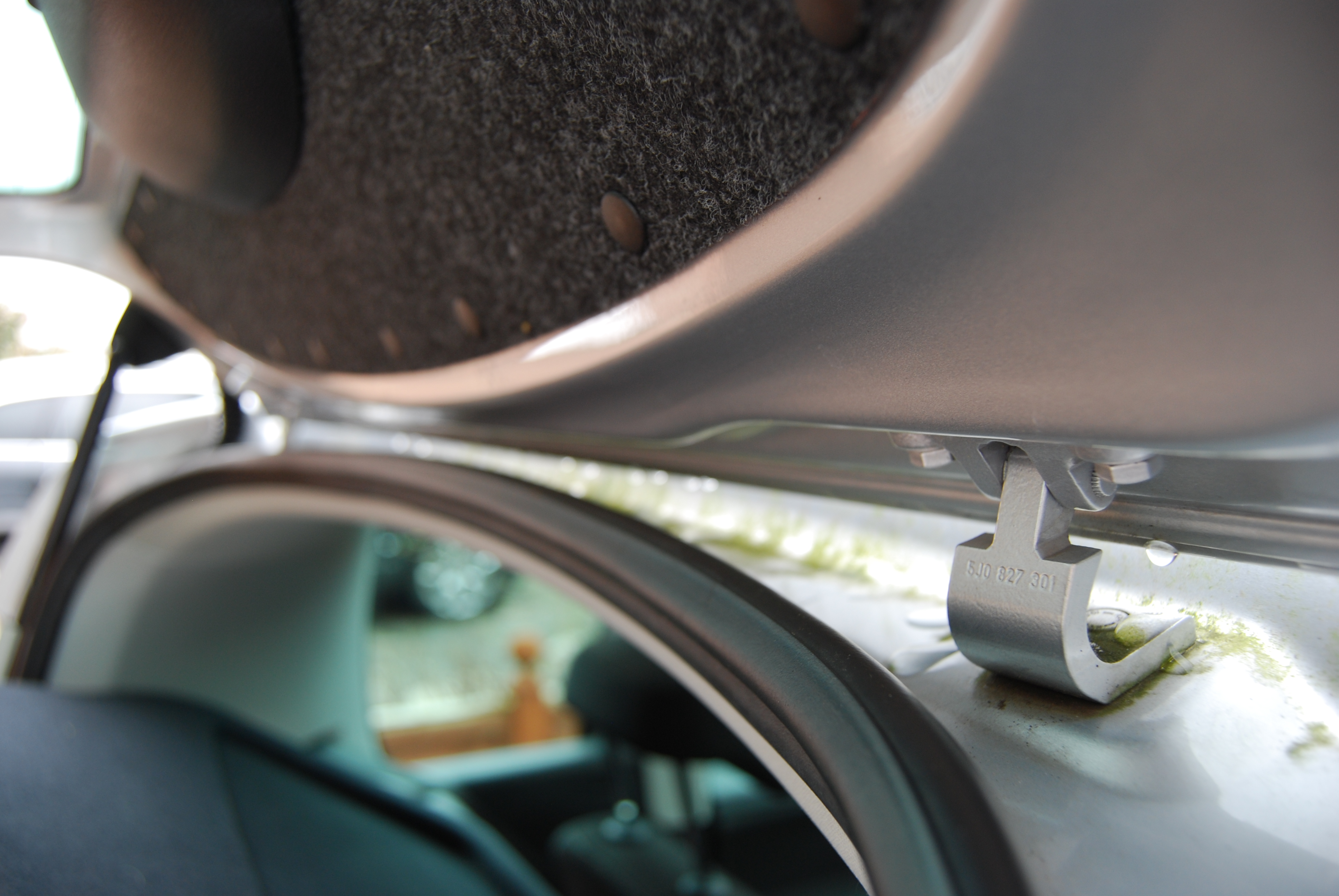

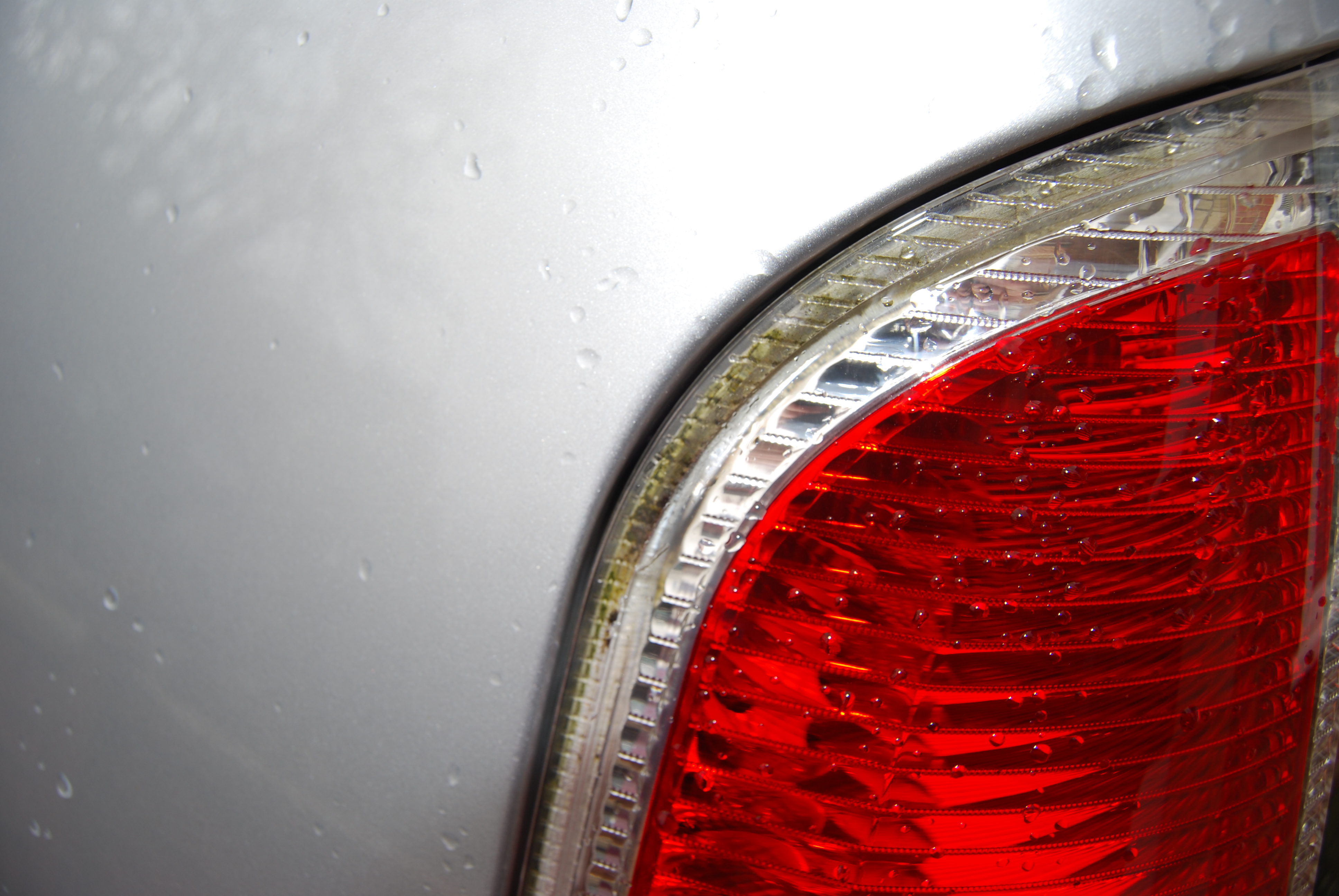

While washing the roomie this weekend and have noticed a thin line of green algae in the rear lights around the edge where it fits into the body work. Can anyone tell me if I remove the light fitting can I wipe away the algae or is it in the light fitting itself? Although  I park in a south facing aspect I reverse in and the rear of the car faces north. This northerly aspect also encourages green algae in body work near  the boot hinge. I can wipe this away with an old toothbrush but it is the rear lights where the annoyance is.
Bad drying regime is usually to blame and water sitting
a little 3-1 mould remover spray and a pipe cleaner for the lights if you don’t want to remove them and a spray and wipe on the hinges

Too much rain and snow this year. The problem has only arisen after 4 years of ownership. The algae past the hinge is the more irksome as the space between roof and top edge of boot is too narrow to get fingers in with cloth.
The rear light fitting comes off really easy. It is something you have to do to change a lamp in it, if a lamp fails. There are torx screws on the outside, you will have a torx driver in with your spare wheel, if you don't have some anyway.
Undo the screws and give the whole lamp fitting a little pull, it will come away from the car and reveal the rear plug on cable. The rear plug disconnects and the whole lamp cluster removes.
The lamp cluster can be dismantled more inside.
